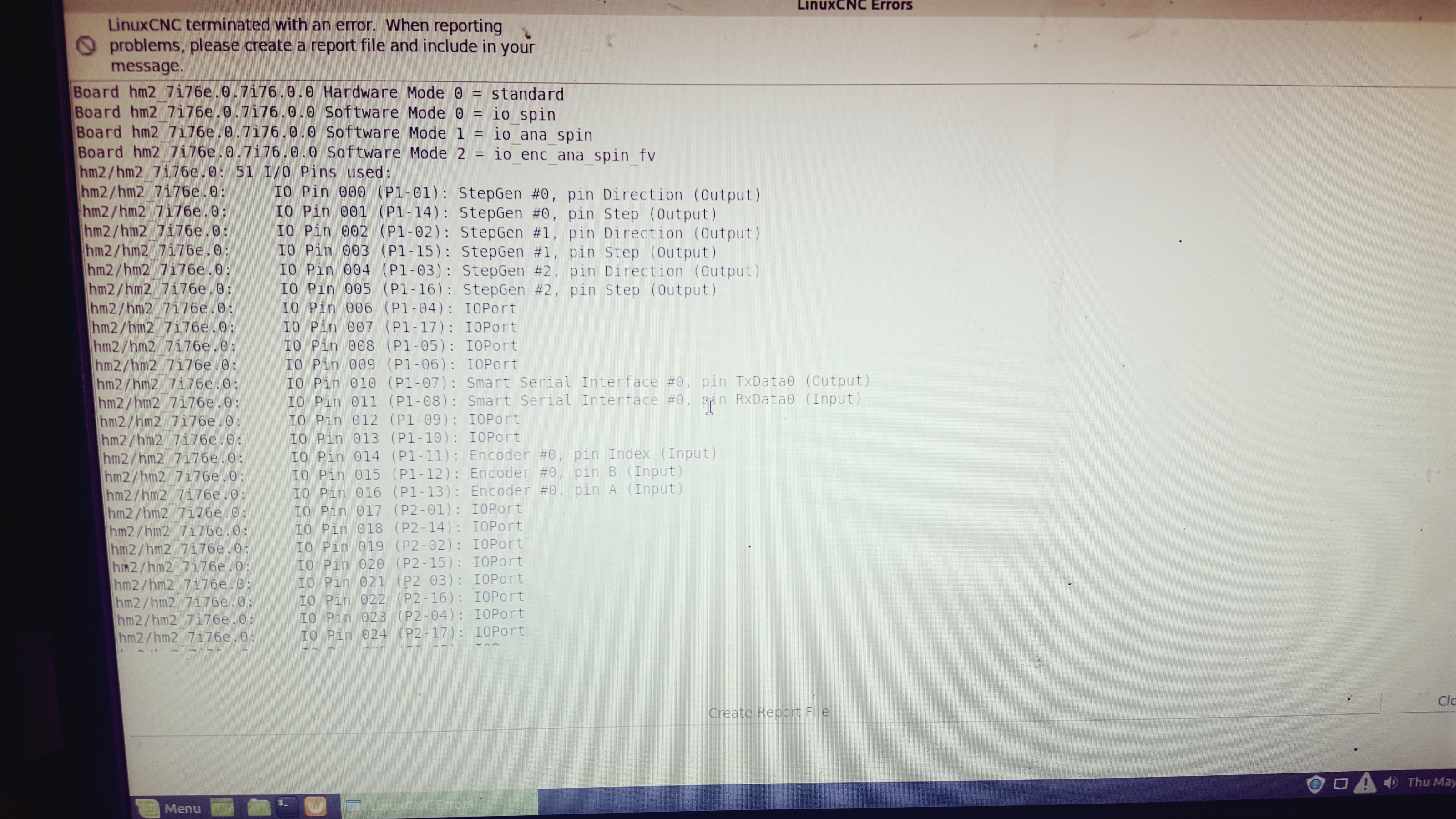

I'm upgrading my plasma table, switching driver boards from the typical $20 Chinese Mach3 style BOB I had running on LinuxCNC2.7 to a 7i76e driver board running on LinuxCNC2.8.
So far I have a couple of questions.
First, on TB4 Spindle which pins should I be using to wire my Powermax 45XP arc start (green & black leads 3 & 4) into? I'm guessing TB4 pin #'s 3 & 1?
Second, I have my 3 stepper motor controllers wired into the 7i76e TB2 pins. In pncconfig I entered my motor values from old config file and when I go into motor tuning the 7i76e board's green led's all light up at once. However, after enabling the motors I can't get any of the X Y or Z axes to move. The TB2 pins and the controllers are all powered but the motors themselves are not powering up at all for some reason...any ideas would be greatly appreciated!

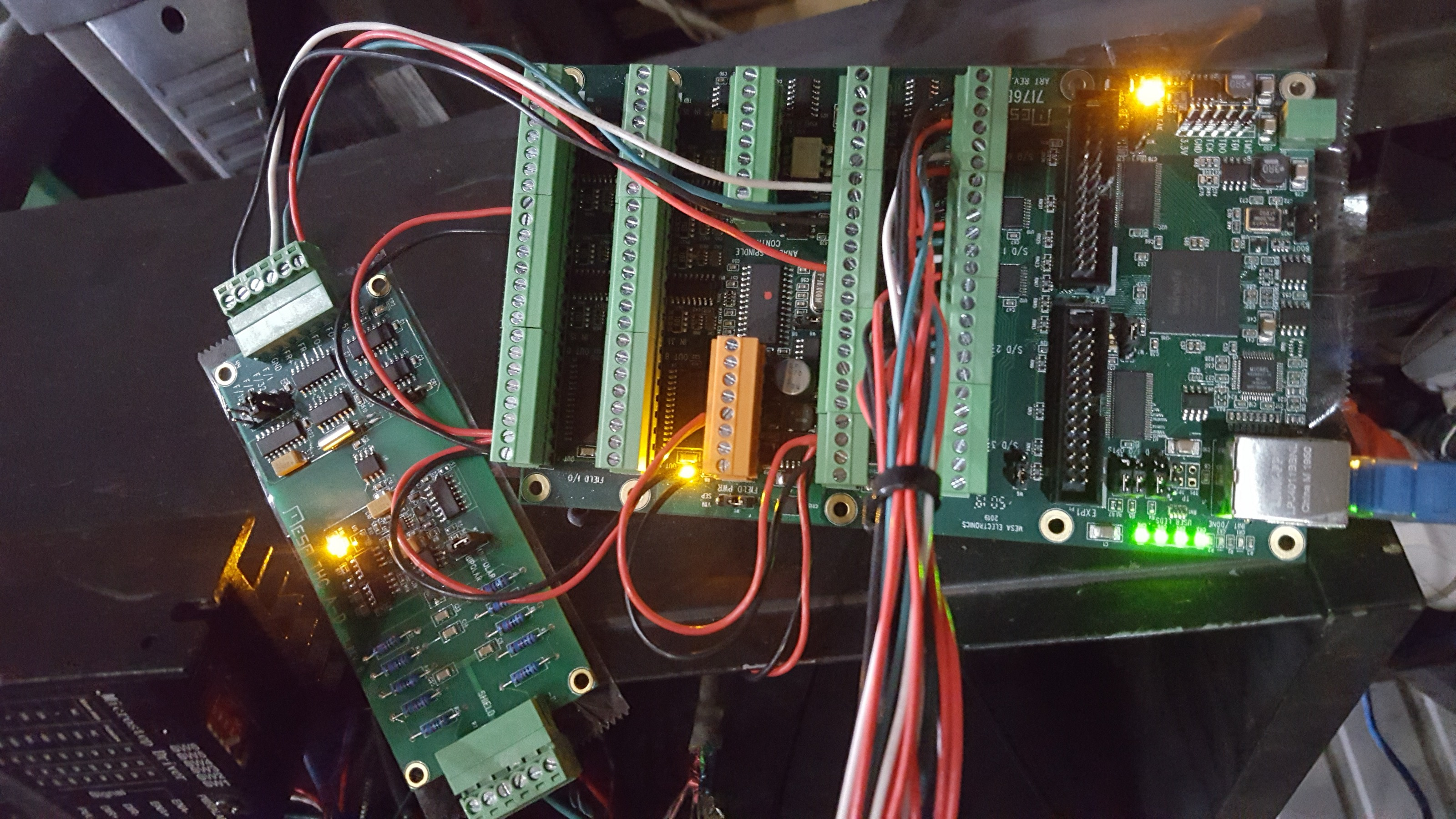

No luck yet with powering the motors once I click "enable" under motor tuning.
I'm using the M5045 ST-M5045 CNC 4.5A Micro-stepping Stepper Motor Drivers. Nema 23 steppers.
I double checked the wiring between the motor drivers and the board, everything seems proper and I am getting voltage readings in the 5v range everywhere at each end of wires running between the TB2 & the stepper drivers.
I'm trying to think what else I could be missing but am drawing a blank at the moment.

Do the drives have an enable?
On step drives this is usually a _disable_ input
If you don't have locked motor shafts. its probably an enable issue

Yes each of these stepper motor drivers do have Enable +/- pins, each are properly wired to the 7i76e and my voltmeter shows each are receiving their 5v from their respective pins on TB2.
Hence the reason I can't see any reason why the motors are not locking and giving movement under the motor tuner.
Is "a _disable_ input" something I need to add into code somewhere? My linux knowledge is very basic, I've only built 1 table using it and this is my first time upgrading to a higher quality board so please forgive me for any stupid questions!

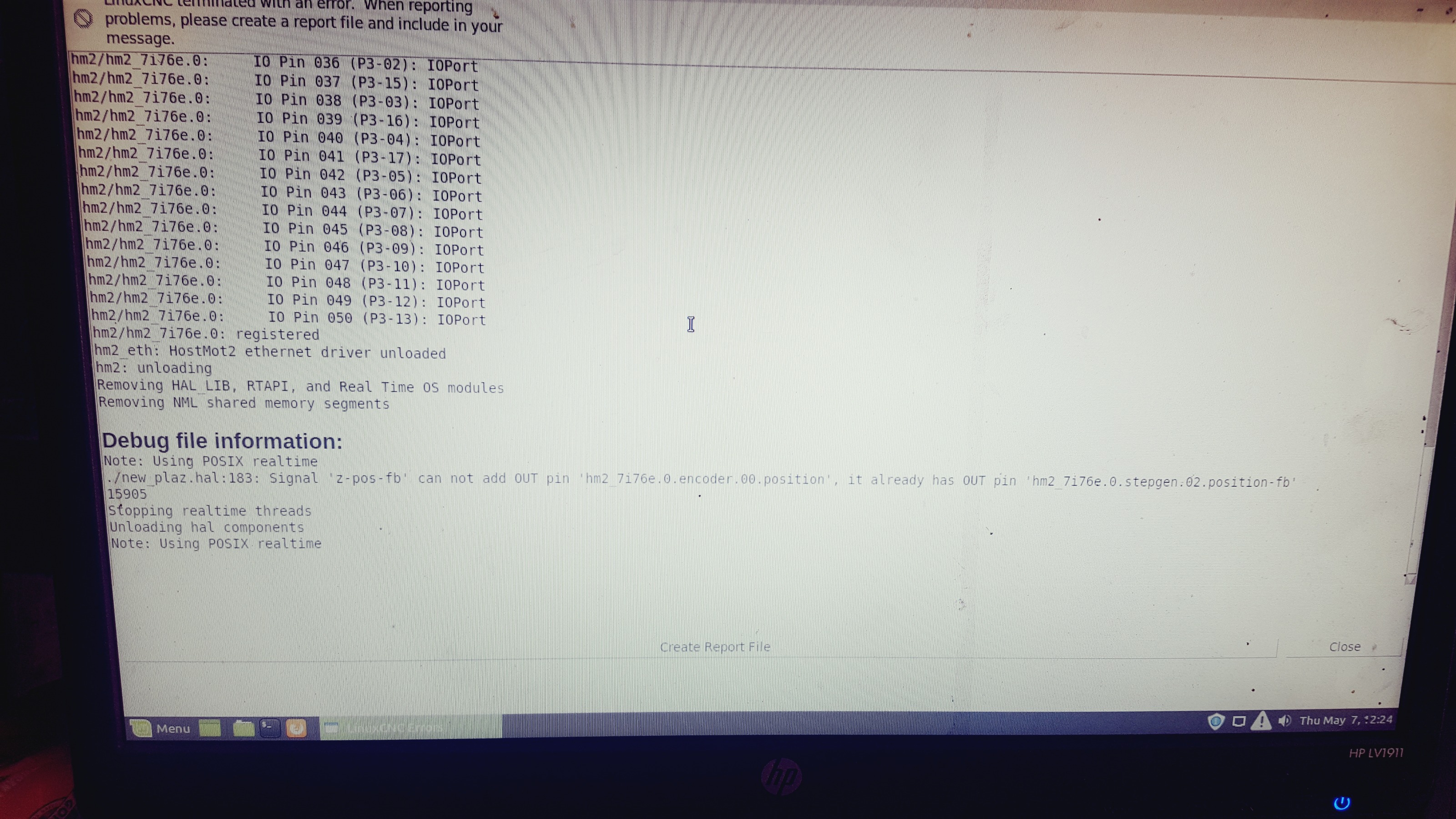

So I have table motion now, my "bare bones" LinuxCNC config loads and the motors run as expected.
However when I try to go back and add the THCAD 10 encoder in the PNCConfig tabs, if I then go into motor tuning my Z motor acts strange...the Z moves in the intended direction but not steadily or at the intended rate and also will keep moving for several seconds after I let off the motion up/down arrows.
Then when I save this config with the encoder as Z encoder and try to load LinuxCNC it crashes and gives me this crash report:
Finally, I put try to hook the "arc on" leads to the spindle terminals TB4 5&6 the torch immediately fires when I go to hook up my second wire, for some reason the signal is feeding directly through these two terminals?

Replied by PCW on topic 7i76e + plasma wiring questions
1. You do not use the THCAD as an encoder nor should you setup any Z axis encoder in pncconf for a step/dir system
2. If you get the TB4 pins 5/6 polarity reversed, they will appear stuck-on
The following user(s) said Thank You: Plasmaguy
