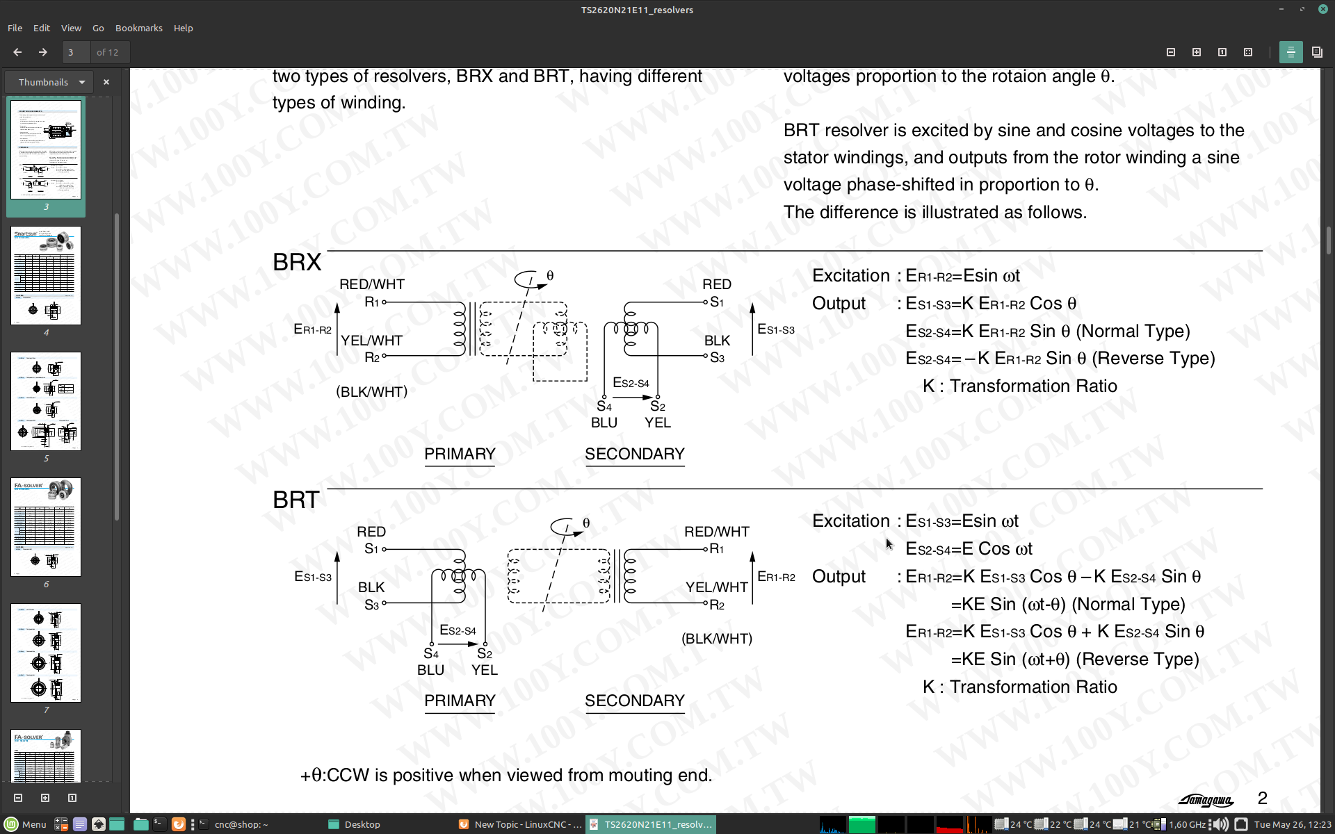

7i49 with Tamagawa TS2014 E1 type resolvers was created by tommylight
I am sure that this will not work since i have the worst possible luck known to man kind, but to prove my sanity, here is a snippet from the resolver pdf, i have the BRT type:
A simple "no" would suffice for me to go find a big rock, and hide under it for the rest of my life !
Pity, i was just getting ready to plop another 600 to 800 Euro on Mesa boards.

Replied by PCW on topic 7i49 with Tamagawa TS2014 E1 type resolvers
Unfortunately...
The 7I49 will not work with those resolvers, but..
Are you sure the resolvers don't go to the drives?
Unless you have brush motors I would expect the
resolvers to connect to the drives, not the controller

Replied by tommylight on topic 7i49 with Tamagawa TS2014 E1 type resolvers
Yes, they go to the UL52 controller.Are you sure the resolvers don't go to the drives?
I do have brushed DC motors, well the machine has, and i have a full bag of spare brushes !Unless you have brush motors I would expect the
Back to making some mounts, like 20 of them till i make some that are dead centre !
I do have 2 of 7i77 and plenty of other Mesa cards, so at least i get to use them.
Thank you.
Regards,
Tom.
