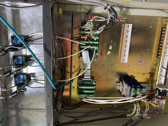

Here are the buffer cards installed. The encoders are single ended with index. I have the A and B daisy chained to the Geckos off the input side of the buffer card. The buffer output is differential to the 7i85.
I am getting very good performance from this setup.
