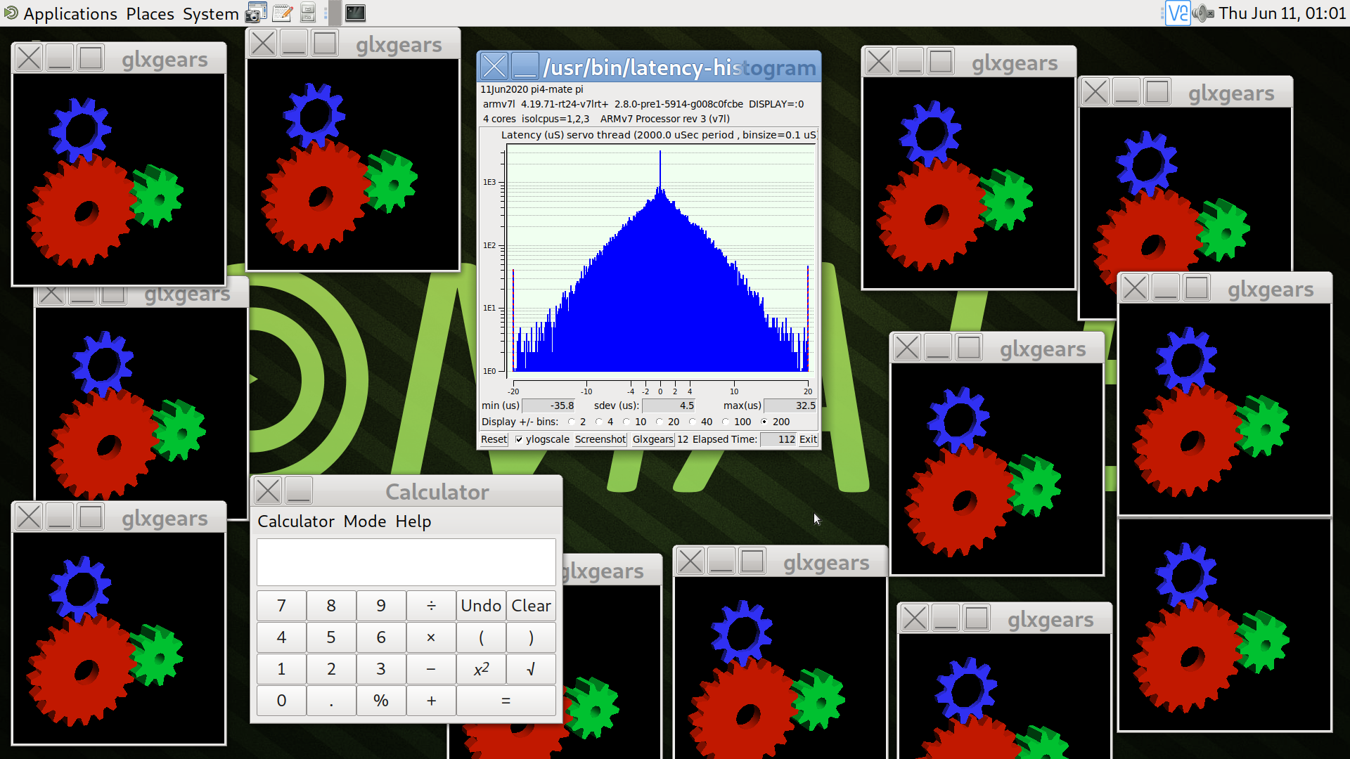

10 Jun 2020 15:44 #171000
Replied by PCW on topic Strange issue with mesa 7i96 after machine go to endstop
Did you lose your real time kernel after the crash?
What does a latency test show?
- alkabal
- Posts: 476
- Thank you received: 52
10 Jun 2020 18:04 #171004
by alkabal
Replied by alkabal on topic Strange issue with mesa 7i96 after machine go to endstop

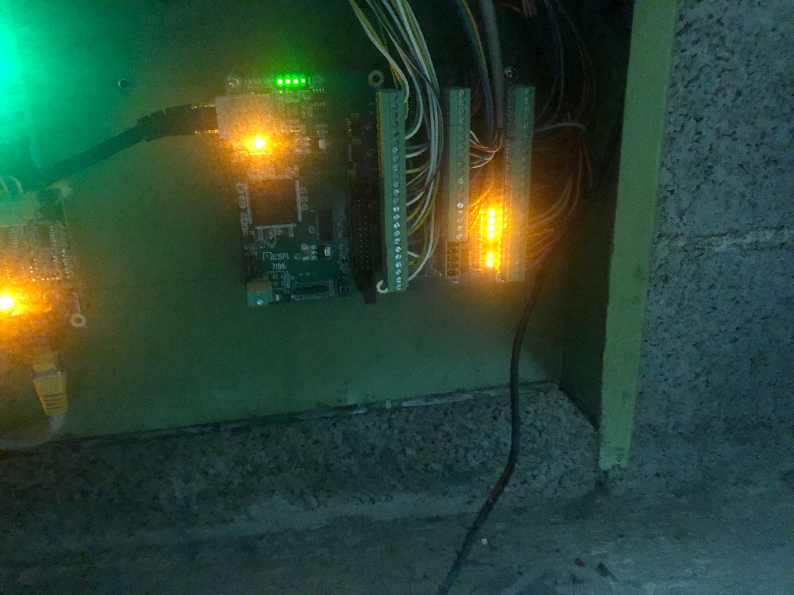

10 Jun 2020 18:47 - 10 Jun 2020 18:57 #171014
by alkabal
The only led are
some input led
pwr led
4 green led (but the 4th is less bright)
I can only suspect a problem changing 7i96 supply from "usb 5v adaptor" to "DC/DC buck converter + condensator and diode bridge on the main third free output from transformer (18v ~)
I have do this some days ago but maybee abusing from start stop after crash make the 7i96 card defective due to some crappy DC/DC converter ?
If you can point me for test something on the card i can search/order/replace something
some input led
pwr led
