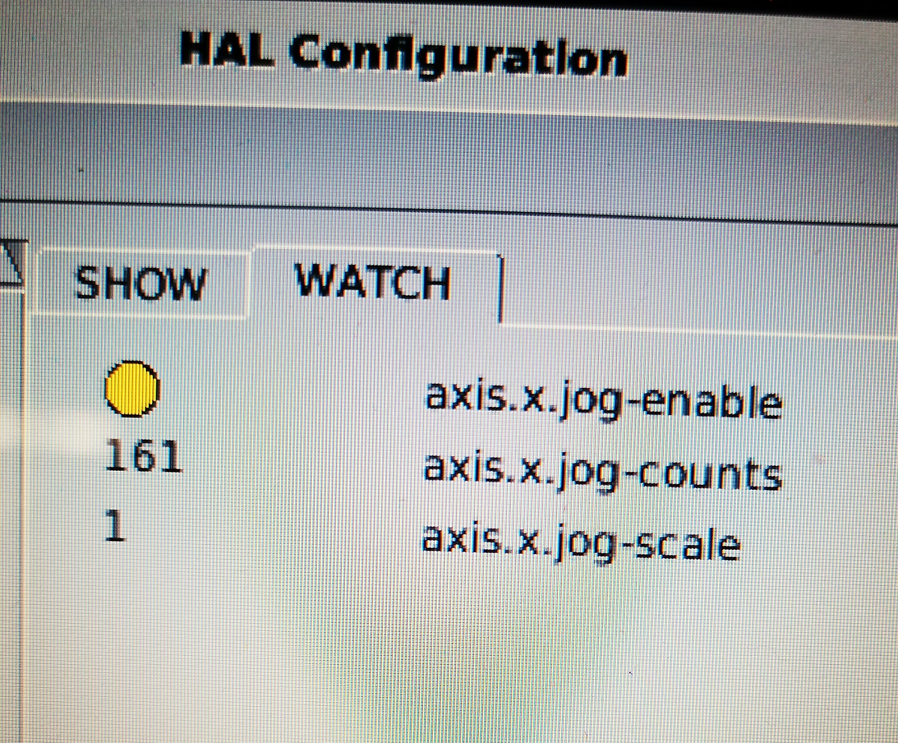

@PCW
sorry i'm still not there,
motion man says
axis.N.jog−enable IN BIT -When TRUE (and in manual mode), any change to "jog−counts" will result in motion.
axis.N.jog−scale IN FLOAT set by setp to 1
so all these 3 connected and jog enable and counts reacts on MPG
hal configuration shows that
machine enabled
nothing moves
need next manual please
motion man says
machine enabled
nothing moves

24 Jun 2020 21:59 #172636
Replied by PCW on topic Charge pump from Mesa 7i96 in 4+1 config?
What version of LinuxCNC are you running?
If >2.7 you need to home before you can jog axis
(you can only jog joints before homing)

25 Jun 2020 07:16 #172689
by Zacharius
Replied by Zacharius on topic Charge pump from Mesa 7i96 in 4+1 config?
ah bingo.
i'm on 2.9 currently, homing did the job thank you.
