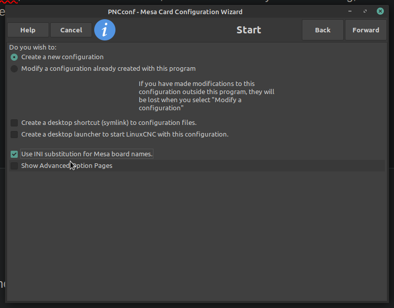

09 Jul 2020 21:56 #174146 by Pro_El
Replied by Pro_El on topic Mesa 7i97 setup problem
Can you tell me if 7i97 is supported in pncconf in LCNC 2.9.
09 Jul 2020 22:02 #174147 by tommylight
Replied by tommylight on topic Mesa 7i97 setup problem
No it is not, but it is ! :)
There is no 7i97 in Pncconf, but there is 7i92 with 7i77, and that is basically the same thing, so create a config with those cards selected and save, open the ini file and change the name of the card, save.
Beware, for that to work, you have to select as in the screenshot on the second page of Pncconf
The following user(s) said Thank You: chili023

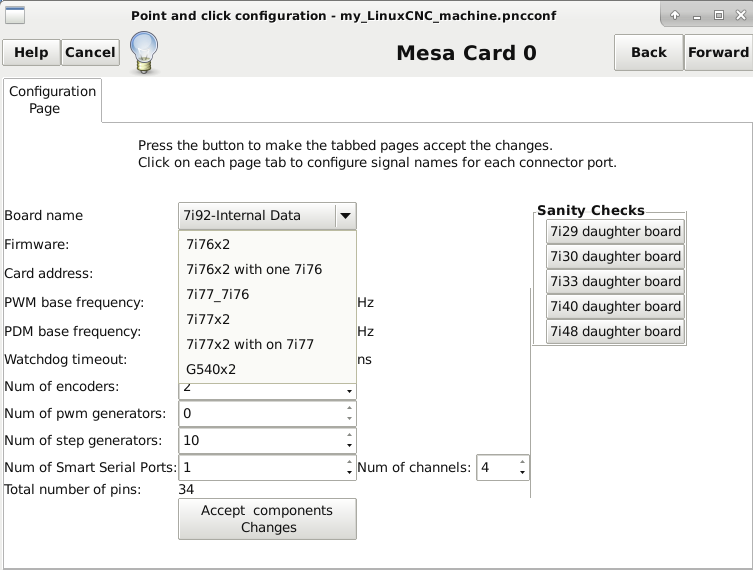

29 Aug 2020 10:05 #179925 by shadab
Replied by shadab on topic Mesa 7i97 setup problem
Hi tommylight,
I'm trying to setup 7i97 using pncconf and when I reach the mesa card configuration page 'MESA 0' I do not see an option for a single 7i77, only 7i77_7i76 is available. As per my understanding and your comments above mesa 7i97 is equivalent to 7i92+ one 7i77. So which Firmware option should I select? i have attached a picture for your reference.
29 Aug 2020 17:38 #179949 by tommylight
7i77x2 with ON (should be ONE ) 7i77
The following user(s) said Thank You: shadab
