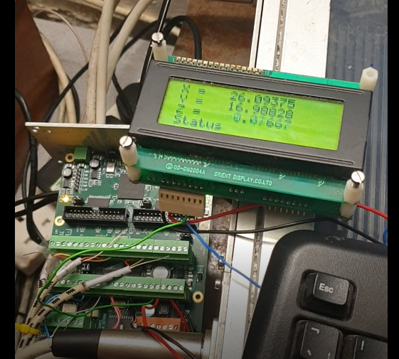

Hi
I'm porting an older controller system over tp a new setup - now using the 7i76e card. I have 4 steppers,and various IO.
To complete the setup I need a 5V PWM and an serial interface at TTL levels to drive the remote LCD display (ideally with recieve as there is also a keyboard attached).
I am trying to minimise cables to the computer (ideally only the one ethernet cable) - so wonderd if there was any advice on the best route to take.
I can build my own bitfiles - but looking through the posts there seem to be several options - PktUART, UART, BSSI and sserial - with some corresponding hal components.
Any advice before I dive in ?
Matthew

Hi
Its an existing remote lcd display on the milling pedestal and keyboard, although I built it. It's got an arduino in it which could be replaced but the component all use ttl basic 3 wire serial.
The demo comp for the pktuart seemed to only have recieve. Is tx/rx possible?
Regards
Matthew
Regards
Matthew

Hi
So I've got my serial display working with teh 7i76e and pkuart -
Two questions if anyone can help ---
I keep getting SCFFIFO errors on transmission, I'm checking the bit for tx busy before I send data but that doesn't seem to help - are there any pointers as to what this error means
Secondly
With the pktuart module, the status Leds on the 7i76e boards now form a "running light display" when active - I was hoping to use these for front panel status - is this a feature of the pkuart module ?
Finally - anyone interested in code - would it be a useful addition ?
At the moment it works by defining preset screens (selectable from a pin) and the screen defines a series of values (read from float pins) and screen locations and formats. Everything is updated lazly to minimise packet transport..

Unfortunately a change in 7I76E the status LEDs suggests that the PKTUART
code is not queueing its communications (merging its I/O requests with the per
servo thread read/write functions) but rather adding additional Ethernet access packets.
Getting SCFIFO errors means that a send frame (a packet) has been pushed when
there are already 16 frames waiting. I would debug this by monitoring the frame count

18 Aug 2020 19:32 #178621
by drmclem
Replied by drmclem on topic Basic TTL level serial and 7i76e for remote display/keyboard
Got everything working - see forum.linuxcnc.org/27-driver-boards/3971...stom-firmware#177499 with a short video.
My new hal driver allows the creation screen templates wich can display up to 5 floating point values (at the momenT) in a way that minimises serial data transport. Can post more details if people are interested.
Thanks for all yo ur help.
