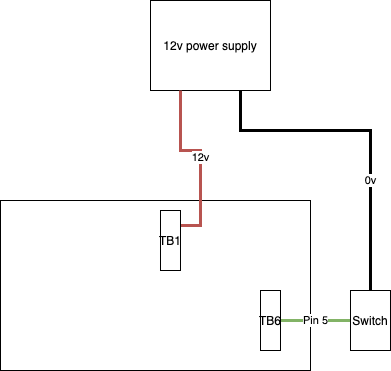

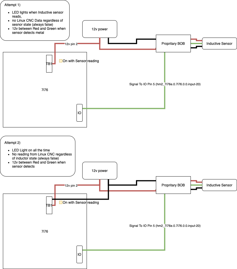

03 Aug 2020 20:12 #177076 by jhandel
Howdy,
I am trying to get basic IO working as I dip my toes into getting this 7i76e wired up..
I am attempting to follow the wiring diagrams here :
forum.linuxcnc.org/media/kunena/attachme...hluss_2017-01-02.pdf
I figured starting with a simple digital input would be best given I have a proprietary BOB in the mix and its signals use to be read as digital by the ADTech Controller I am replacing.
Anyways, I used page 6, and Page 5, and messed with W1... I can't seem to get anything to "read" by linuxcnc..
I have attached images of the two attempts at wiring and what the 7i76 does..
I don't think this is HAL related.. I did go through PNCConfig and pick a few things but really its all just "trash" settings so that the HAL knows where my board is (10.10.10.10) and then I am looking at the HalMeter to try to find a reading anywhere (I expected it at 4 but I honestly tried every single io port on the HalMeter and non of them flipped from FALSE to TRUE while I was tapping on the sensor causing it to bounce.
I know for a fact that when closed (sensor see something there is 12v between TB1:2 and TB6:5 regardless of the wiring, and when the sensor sees nothing, there is 0 volts between those two pins regardless of wiring.
Any help would be great.. Unfortunately I am retrofitting so I have this BoB in the way, but from everything I have seen its converting everything to just a high/low vs the power supply.

03 Aug 2020 20:19 - 03 Aug 2020 20:20 #177077 by tommylight
From what i can gather, you would need a pull up resistor between the +12V and the input. A 4.7 to 10K one will do just fine.
Also notice that physical input number one ( the lowest on the Mesa board ) is input 00 in hal.

03 Aug 2020 20:23 #177081 by jhandel
I am specifically using ping 5 because that is the start of the digital IO pins, and this isn't "analog" from what I gather.. But I can try to add a resistor.. going to make wiring "fun" if I need to add another BOB to convert 20+ signals over with a pull up resistor.
currently the wiring is
Sensor -> Propritary Bob-> one to one DB25 to pins Bob-> 7i86e
If what you are suggesting is true I have to create another "space" to add 20+ resistors to all of those inputs?

03 Aug 2020 20:30 #177083 by tommylight
hm2_7i76e.0.gpio.021.in
That is a pin on one of the two 26 pin headers on the 7i76E, so if they are not connected to a BOB and you have the sensor wired to that BOB, nothing will happen.
This is the pin in hal you should be using if the sensor is wired to the first input on 7i76E
hm2_7i76e.0.7i76.0.0.input-00
03 Aug 2020 20:36 - 03 Aug 2020 20:37 #177086 by jhandel
Wiring is to TB6:5 which is the first digital IO pin on the last set of plugs (right most edge of the diagram) according to forum.linuxcnc.org/media/kunena/attachme...hluss_2017-01-02.pdf page 6 (forum.linuxcnc.org/media/kunena/attachme...hluss_2017-01-02.pdf) according to that doc pin5 on TB6 is hm2_7i76e.0.7i76.0.0.input-20
Ignore the limit and home I picked in the Hal, that was just to get through PNCConfig so I could get to the HalMeter and HalScope.. I have tested every single of the IO pins in HalMeter (hm2_7i76e.0.7i76.0.0.input-00 through hm2_7i76e.0.7i76.0.0.input-30) and none of them are flipping as I tap a screw driver against the sensor.

03 Aug 2020 21:19 #177098 by tommylight
Pin 5 on TB6 is input 04, not 20.
Input 20 is on pin 5 TB5.
And again, you might need a pull up resistor as described above.
03 Aug 2020 21:22 #177102 by jhandel
having tried all of the pins, its in-material if it is 5 or 20.
would I need a pull-up resistor if this was a physical switch between the pin and common (0v)? because functionally that is what this is.. If the answer is yes "even with a physical switch between 0v and field (12v) you would need a pull up resistor then I guess, I do (100% suck for anyone using physical switches)..
I say that because that is how this digital switch from the BoB is behaving.. it is a connection to 0v when flipped.

03 Aug 2020 22:05 #177113 by tommylight
No need for a resistor if using a switch.
There are several types of sensor outputs, NPN, PNP, and push-pull. The latter works with any type of inputs, while the former ones are for use with sinking or sourcing inputs, respectively.
So if the sensor in your case is of NPN type, you do need a resistor for 7i76E inputs but not for the 7i76ED.
In the attached diagram the sensor goes through something, so without knowing what that does, it is hard to know what exactly to do.
You can always test the inputs by wiring 12V to one of the inputs and monitoring them with halshow.
03 Aug 2020 22:13 #177114 by jhandel
The propritary Bob converts all the sensors (and other IO) into digital signals connected to common (0v).. So when the sensor is on, the BoB makes a connection to common on that pin vs. the field 12v..
(Retro fit of something designed to interface with a Controller that worked with simple switches)
Effectively it is the same as this attached image.
I am going to grab a physical switch and test that field to common can be just a switch...
I did try a resistor.. when I did that the input would flip state once, and then get stuck, and wouldn't flip back..
Will post back when I try a physical switch between common & field.
