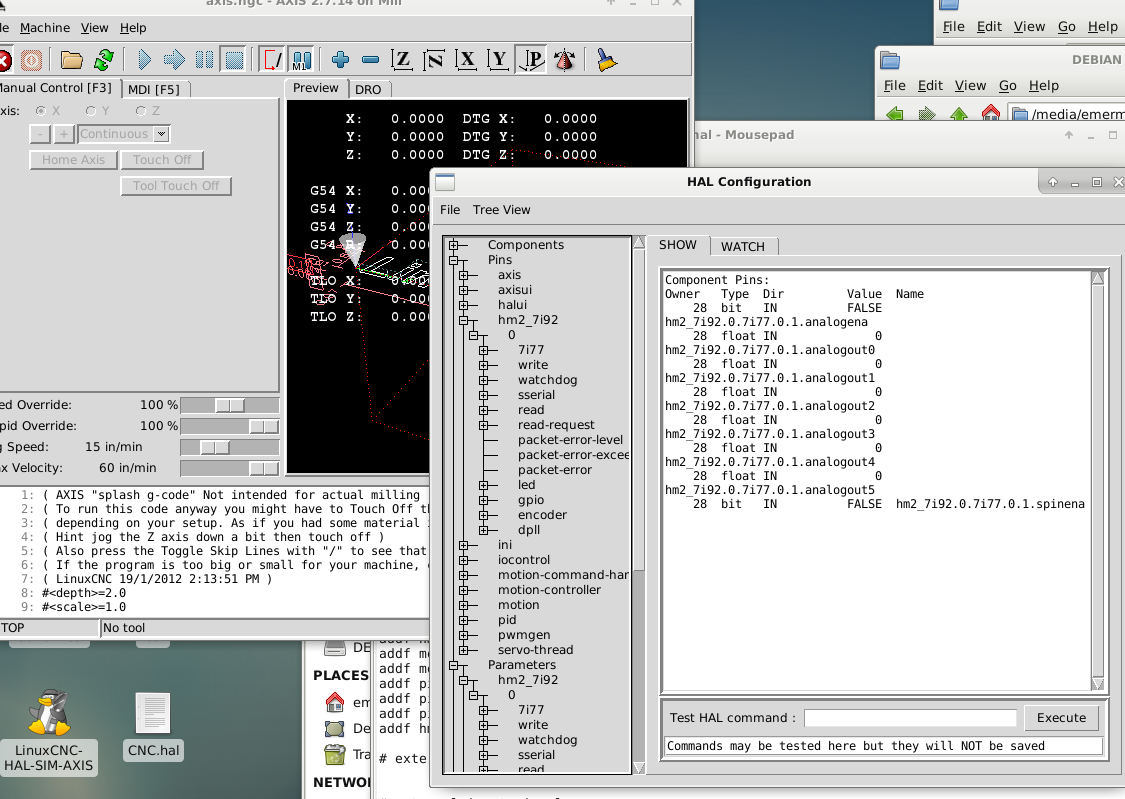

I am running a 7i92 with a 7I77 and 7I85S. I have an encoder successfully working on the 7I77. I am trying to get a servo to connect to the 7i85S but having no luck. I was looking thru the Hal Configuration menu and noticed I can see the 7I77 connected to Port 0 but don't see the 7i85S. I would have expected to see it on Port 1. Now am wondering if I don't have the 7i92 talking to the 7i85. I used the 7i92_7i77_7i85d.bit file. I am wondering if I need to do something in the HAL file to see both cards or am I missing something else?
I appreciate any guidance.

The 7I85S will not show up in hal names as it is a passive device.
If you have a 7I85S rather than a 7I85, you would need a 7i92_7i77_7i85sd.bit firmware
It does not look like that is in the distribution, so I will try to find it or make new bitfile:
freeby.mesanet.com/7i92_7785s.zip
Bitfile for 7I92 with 7I77 on P2 and 7I85S on P1

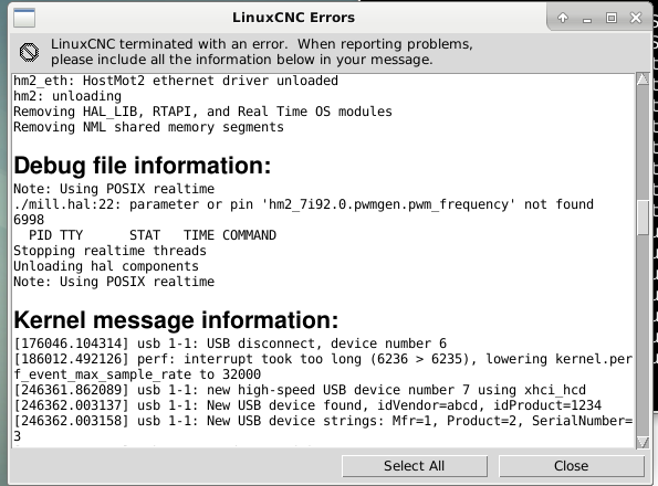

So now on to the next problem. I am using the same .HAL file as shown above. When I remove the comment on line 22.
setp hm2_7i92.0.pwmgen.pwm_frequency 15000
I get an error. I'm stumped on what its looking for
I put the error below as well.
Cannot work since the configuration has no PWM generators
