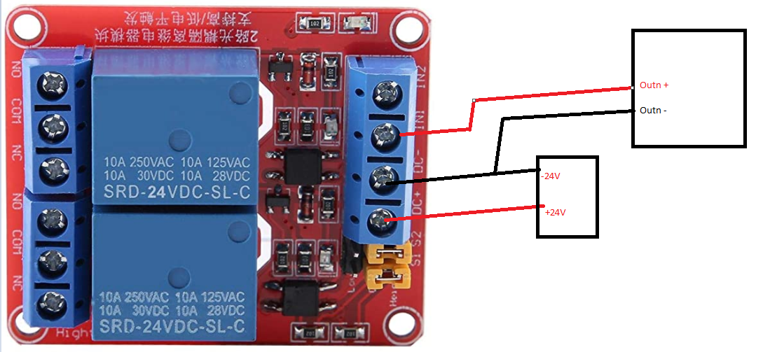

Mesa 7i96 Optically isolated relay module wiring

Mesa 7i96 Optically isolated relay module wiring was created by xnaron

Replied by tommylight on topic Mesa 7i96 Optically isolated relay module wiring
That should work, but the jumpers on the board seem to be on the high side.

Replied by xnaron on topic Mesa 7i96 Optically isolated relay module wiring
Thanks. That is a stock image and not my board. I have the jumpers set to low on mine.
