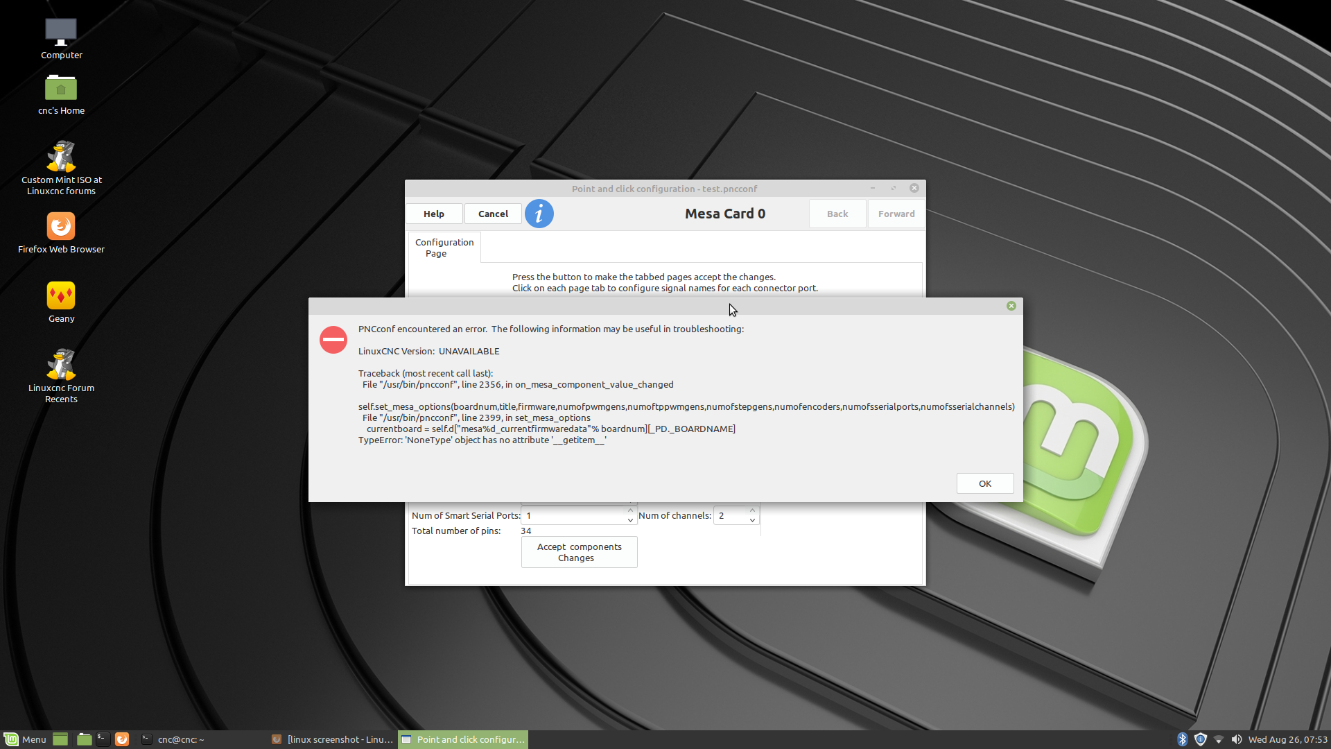

I built a custom 7i76e bitfile to add a few more step generators (from a 5 axis bob) and a bunch more encoders (from a 7i89)... How would I get that bitfile to be "visible" by Pncconf? I saw the folders under /lib/hm2/ and added a folder for my custom 7i76e bitfile and copied the file into it... But Pncconf blows up when I try to use it... Is there another build asset I need to include or a process to build a config file for it?

2) Here is a screenshot of the error (attached)

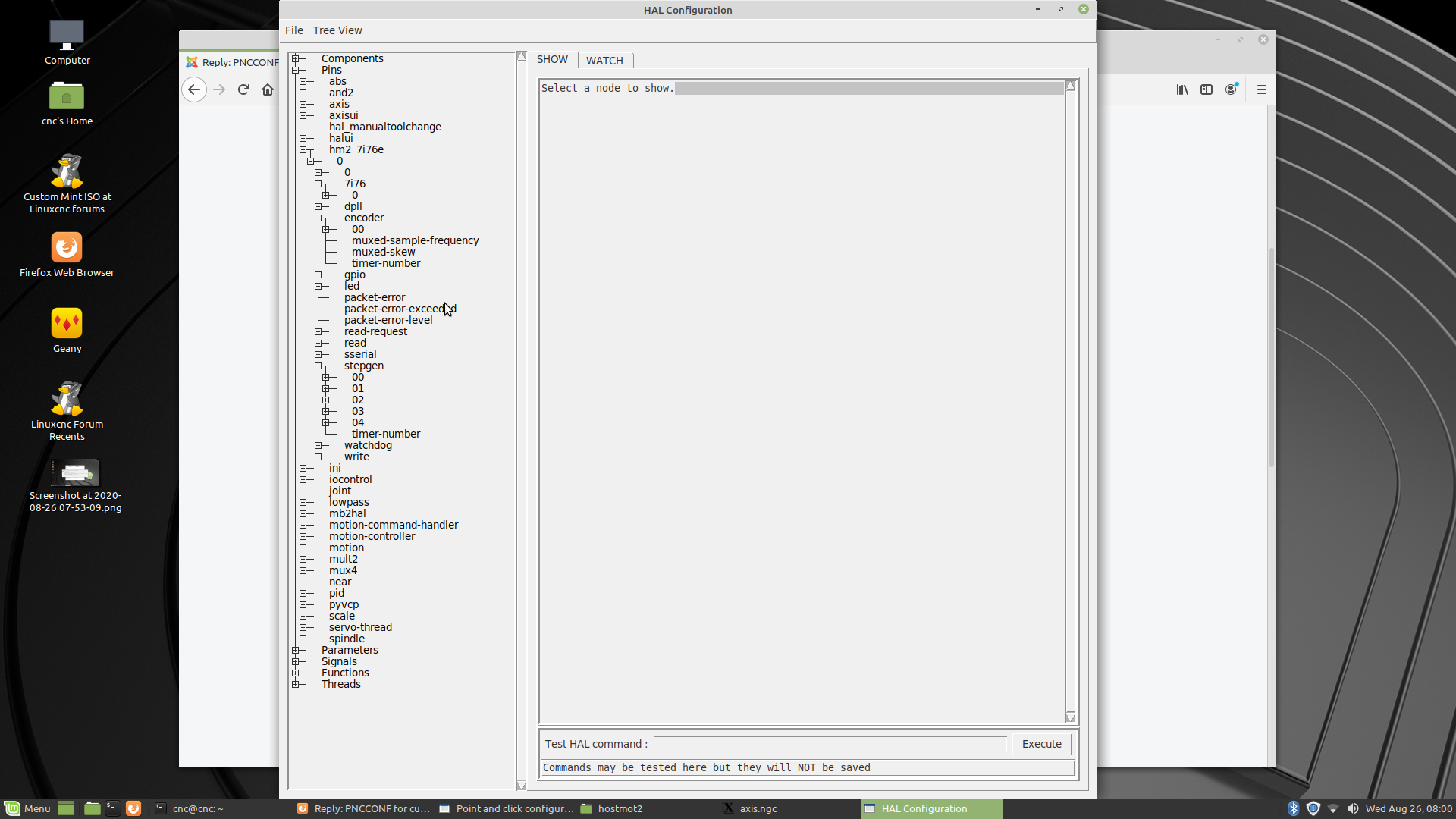

4) what LinuxCNC sees in "Show Hal Configuration" if I use the default 7i76e-internalData config (attached)
-- Specifically it doesn't show the 6th StepDirection generator or the 8 other encoders (from the 7i89 card)
