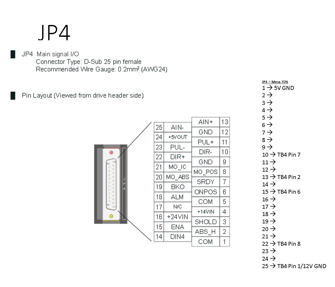

I recently wired up a power box for a DMM AC servo that I intend to use as a spindle motor. The motor works as it should when I control it via Windows and the DMM software. Now its time to wire it up for linuxCNC control. I was hoping I could get someone to double check me before I wired everything up.
DYN4 Manual: www.dmm-tech.com/Files/DYN4MS-ZM7-A10A.pdf
Page 11 is where the pin descriptions start
I am wiring to a 7i76 and only need to the spindle to rotate in one direction (ie. I will not be ridgid tapping) and do not have a brake on the motor. I have a DB29 BoB and plan on using the wiring attached. Does this look right? Is there anything I am missing?

7I76 TB4
1 SPINDLE- --> JP4 25
2 SPINDLE OUT --> JP4 13
3 SPINDLE+ --> +10 or +12V
4 NC
5 SPINDLE ENA- --> JP4 15
6 SPINDLE ENA+ --> +24V
7 SPINDLE DIR-
8 SPINDLE DIR+

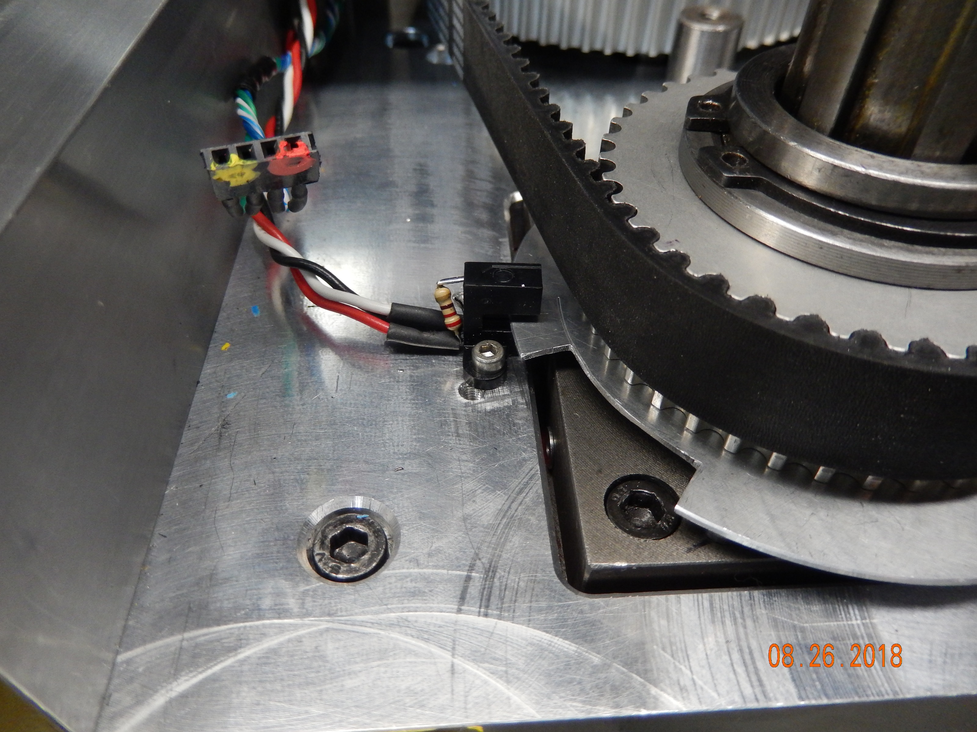

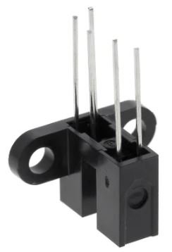

Since you are gearing the motor other than 1:1 you need the index pulse (Z signal) to come from the spindle at 1 pulse per revolution. The A&B signals will come from the encoder output of the DYN4 drive. This is what I did using the following parts:
220 ohm resistor
Sharp Microelectronics GP1A51HRJ00F
GP1A51HRJ00F to Mesa 7i76
Pin 1 220 ohm resistor to pin 3
Pin 2 & 5 to TB3-15 (GND)
Pin 3 to TB3-12 (+5VP)
Pin 4 to TB3-13 (IDX+)
This is the pin layout looking at the back of the sensor.
This is what the install looks like on my machine.
If you happen to see other pictures of my machine that shows two of these mounted on the spindle the second one feeds the RPM display of the DRO I have on my mill.
220 ohm resistor
