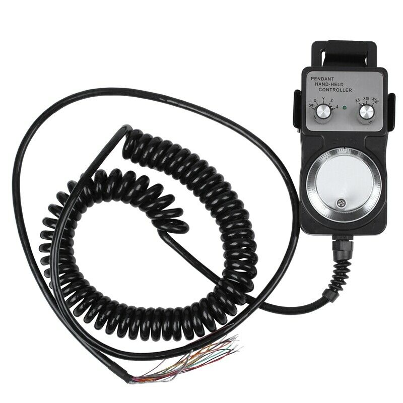

Hi Everyone,
Thank you all for the input. I've taken RodW's advice and ordered 7i76e and a 7i78 4 axis step/dir card.
I've been peering through the manuals of each, and I was wondering if anyone has any recommendation for compatible accessories such as home/limit sensors, or recommended MPG/Pendant-like accessories.
If anyone has had any negative experiences with certain gear and this configuration, I'd also like to hear some insight.
As always, any guidance is appreciated. Stay safe everyone!
Hamish.

Replied by rodw on topic G'day from Australia - Mesa board selection advice. Please help.
Thats probably a well priced pendant. It does not need the 7i73. If it has 5 volts MPG, then the 7i76e will support it if the correct mode is loaded in HAL. There is an example for a single axis MPG setup on about page 3-4 of my Spaceship plasma thread. You just need another Mux4 for axis selection.
any simple switch will work fine for limits etc or you can use a PNP prox sensor.
Ocean Controls have a 2 amp Meanwell din rail power supply which is perfect.
For your control box, add an IEC EMF filter for mains power inlet. Jaycar has one or RS components with a fuse built in. I put a house breaker in the control box.
There are no negatives. Its Mesa and Linuxcnc so it works!

I wanted to play with the 7i73 and have some ideas for a remote panel, but Rod is correct the 7i73 isn't required.
I came up with a user comp that handles all the logic in one "blackbox" and has outputs for joint_enable & axis enable. I feel it made the hal file a little cleaner and understandable for myself, Also handle the MUX functions for axis & scale select.
