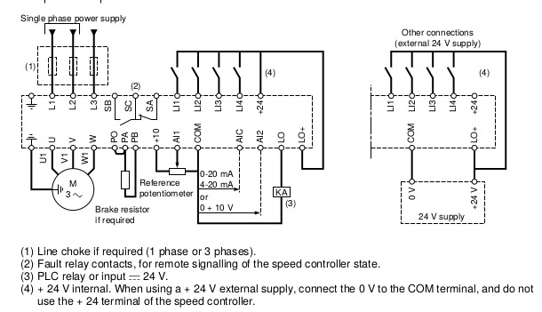

Hi all,
I have 7i76 and want to control my vfd for the spindle. It seems a bit of a odd unit because it has different contacts for fwd and reverse along with a analog input voltage for speed. Its a altivar18 vfd if that matters.
I have it wired with DIR+ connected to the control contact +ve feed (L0+), and DIR- to the fwd input on the vfd (Li1), and analog voltage control set up. That is working in forwards with speed control/fwd direction from Linuxcnc gui.
It needs either fwd (Li1) OR reverse(Li2) selected to move, if both are activated the vfd wont start, so if I wire DIR up to the reverse contact (Li2) and Ena to Li1, because Enable & Dir is triggered it doesnt spin. I could ignore enable, and use DIR to switch into forward, but then how to select reverse using the 7i76.
So my problem is how to wire/switch direction from fwd to reverse with this vfd, any suggestions?

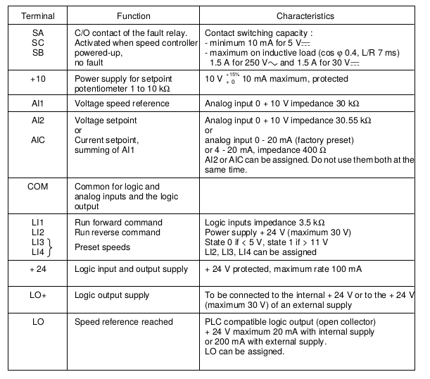

tommylight, I have read the manual, Its how I got the spindle to rotate and speed control to work. But most the threads I can find use a enable wire on the vfd to start, and a dir input wire to swap direction. This vfd doesn't behave like that.
I have the connections from tb4 to the vfd as follows
TB4 VFD
1 Spindle- ---> Com
2 Spindle out --> A/1
3 Spindle +v --> +10
4 NC
5 Ena
> ? (as per text, I have no enable and cant use it for reverse)
6 Ena +
7 Spindle Dir ---> Li1
8 Spindle Dir+ --> LO+
RodW, last time I had a spindle control board and I used a relay on it to swap dir between the fwd and reverse inputs to select direction in that way, Someone suggested there would be a way to do this without a external relay using the native 7i76 connections so that's what I'm trying to figure out.

Oops I got it a bit wrong. I've never used a spindle. The direction signals are on TB4 spindle interface.
Look at the circuit diagram. It shows the fwd and rev have a switch between the input and +24v on the VFD.
The 7i76 outputs are not switches.
I think you need relays!
Replied by rodw on topic 7i76 spindle control

I'm probably wrong about no Enable on the vfd on reflection, If removing the +24 -> LO+ jumper on the vfd itself disables the drive, I'll test, and if so I can enable the motion with the 7i76's ena outputs, and have a external relay driven by 7i76 DIR output to switch between forward and reverse with a single output.

On your last post you are on the right track as that could work.
Replied by tommylight on topic 7i76 spindle control
That is how it should be. Above you had Dir + and Dir- so that was wrong in many levels.TB4 VFD

I don't think you can use a single relay. M3 turns on the dir+ direction. M4 turns on the dir- direction. These two signals are managed by linuxcnc and will never be enabled at the same time. eg an M4 will cancel any active M3 and vice versa.

But they will not cancel "enable", so his method should still work by making the default forward and when the relay is triggered to go in reverse, so the relay would be active only on M4.
