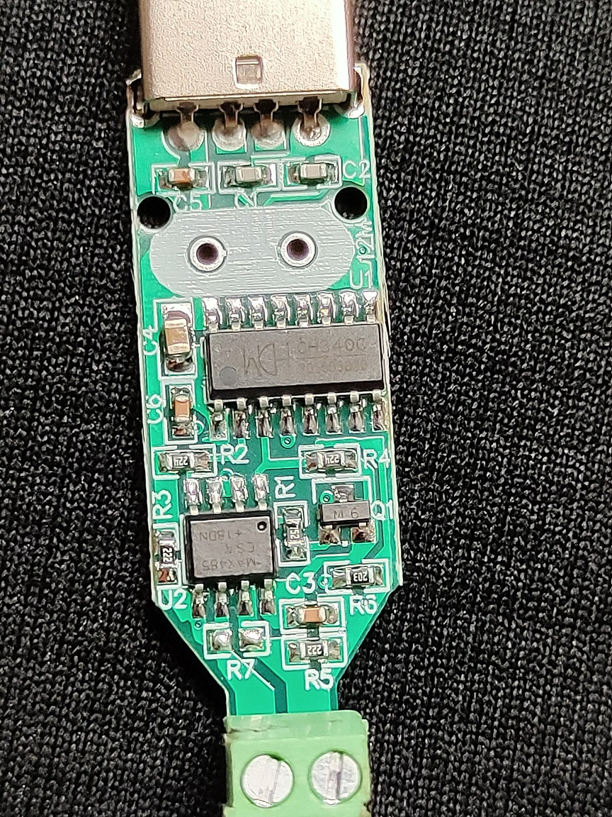

Hello All,
Hardware:
I have a Teco L510 VFD which is controlled using RS485. I am using the ubiquitous USB-RS485 adapter to interface between my computer and VFD.
Issue:
It had been working as I would have expected it to until very recently when I relocated my computer. My spindle would not turn on and Hal Meter showed "no communication".
Debugging:
I figured I had snapped one of the fragile ethernet lines and that appeared to be the culprit. I resoldered and re-strain relieved my dongle, but that didn't fix the issue. I verified continuity and correct polarity. I used Windmill ComDebug on my windows laptop to send a single command. The VFD received the command and reacted appropriately, but did not return a response. Similarlly, I was able to increase and decrease speed using the Axis Gui Manual mode (but not change direction for some reason). I chalked it up to a faulty USB dongle and ordered a new one.
I wired the replacement dongle today and tested again with my laptop. The replacement dongle both sent and received a packet (as expected). I successfully homed, turned on the spindle, edgefound, turned off the spindle, tool changed, and then ran 2 programs.
I don't remember the exact sequence of events, but I did close Axis GUI while the spindle was on. The spindle continued to run for ~25 sec (the VFD window for time-out, will adjust shorter later), and then turned off when the VFD errored out. I then killed mains power to my control box. 30min-1hr later, I turned back on to run a new program. After rehoming, I was unable to ever get the spindle spinning again. Hal Meter showed no communication. I verified continuity from the dongle to the VFD. My laptop recognized the CH340 on Com3 and "sent" a packet, but the packet did not elicit a reaction or packet response from the VFD. It appears a second USB dongle is dead.

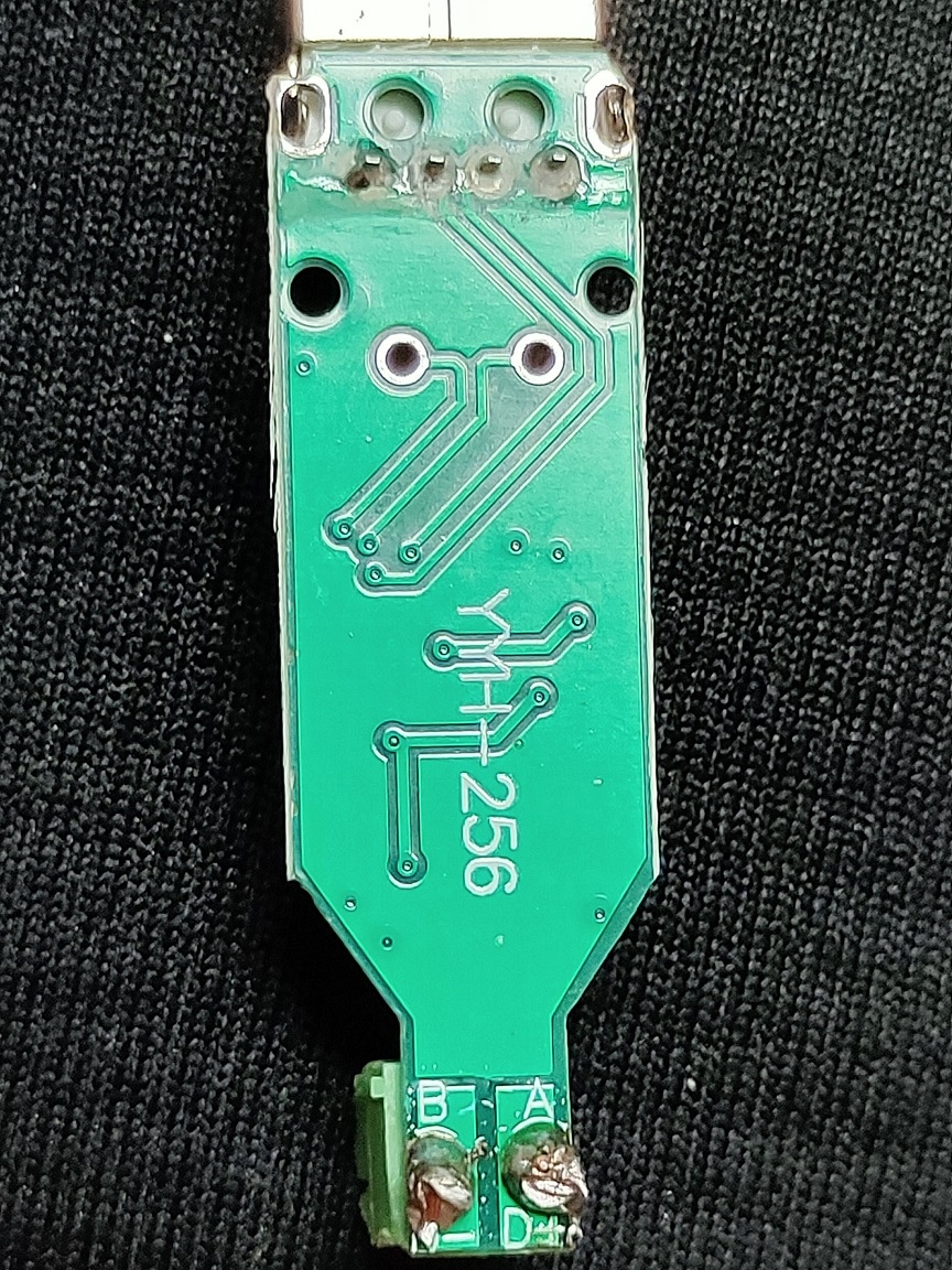

Attached are the pictures of the first dongle. I couldn't find any glaring issues (except the ommission of an oscilator!?!)
My Request:
I have ordered 4 more to be in by Friday night and 1 more expensive (and feature laden?) model to arrive Saturday. I would like assistance identify the culprit OR proposing tests to hopefully resolve my issues within the lifespan of 5 more dongles.
Thanks,
Tanner Frisby

Looking at the schematic that you provided, I'm guessing that your MAX485 chip has bit the dust. Probably as the VFD shut down it went into into fault mode and it no longer had proper control of its comm lines and let the voltage go too high or applied reverse voltage above -.5 volts.
I don't think that the CH340G chip is dead since you can detect it from the OS. Putting a scope on pins 1 & 2 and 1 & 3 while transmitting characters would be the way to check this out.
And looking at your picture and those of other MAX485 chips, the labelling on your chip looks different. Counterfeit maybe?
The pads for R7 present an opportunity to install a 5.1 volt Zener diode to limit the voltage coming in from the outside world. It's an easy mod since the pads are free for the taking. Adding a Schottky diode to protect from reverse voltage would be a very good idea too.
Or just go with the recommended more robust device.
