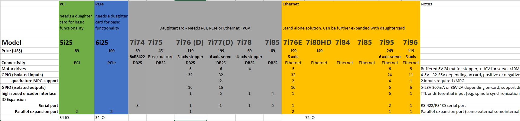

18 Oct 2020 08:57 #186446
by whatwasIthinking
Replied by whatwasIthinking on topic MESA recommendation please
Thanks - appreciate you taking the time to help. Have done a bit of comparison, read a bit more and come to two options:
1) 7i95 $249 - has everything we need to start.
But I noticed a bit about it's relative newness and needing a bit more manual HAL setup. Is this still the case?
2) 6i25+7i77 $308 - would prefer to use ethernet, but if this is a more mainstream route then might be my safer bet?
PS if you think the attached table would be of any use to others happy to tidy it up.

18 Oct 2020 10:57 #186450
Replied by tommylight on topic MESA recommendation please
7i84 does not belong there, it is an SSERIAL device with 32 inputs and 16 outputs and it is not ethernet.
