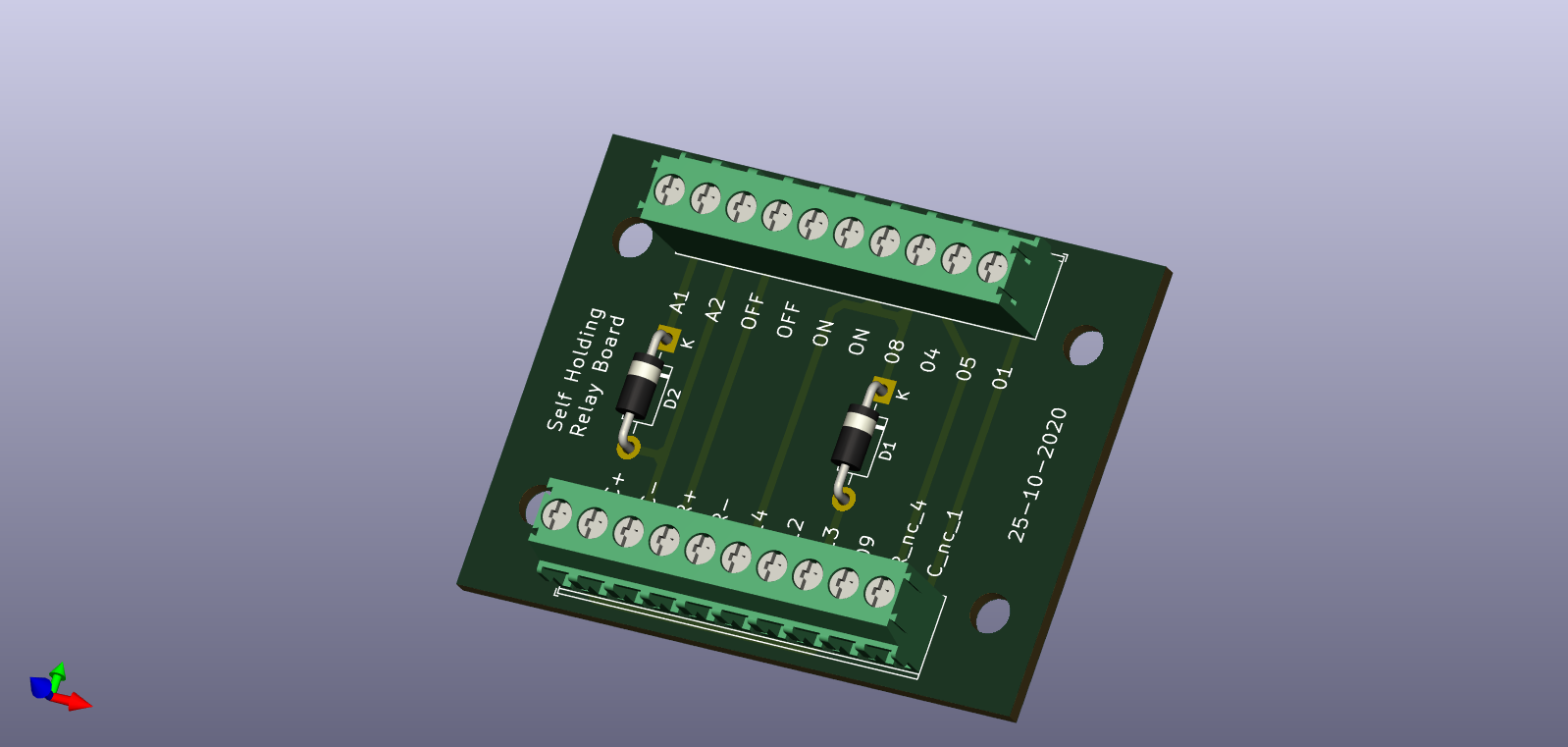

I hope I'm not out of line by asking this in the public forum.
For my new control cabinet I've designed some custom PCBs to make wiring a little easier. Basically some compact DB-25/15/9 breakout boards and another board to simplify the wiring for a few self holding relays. All have been designed to take 3.5mm pitch screw connectors but since I can be a little persnickety about things being the same I was wondering if there are some part numbers for the PCB headers & plug in terminals used on the mesa board ie: the green\orange connector on the 7i76.
I've had a look at some products from Dinkle, Weidmuller & Phoenix Contact but can't seem to find something that suit.
Just a rendering from Kicad.

Close but not quite, the end overhang, if you measure from the centre of the last pin, is more than half the pin pitch. So unlike the one mesa uses you wont be able to stack say, a 4 way, a 2 way and a 4 way plug in a 10 way header.
Upon further searching Wurth may have the one's I'm after. In the pdf it's the 1.75mm dimension I'm talking about.

The parts we use are "Welink" brand as they are side stackable
and quite reliable.
example part numbers
F73-B-3.5.08P (8 pin side entry 3.5 mm pitch plug)
F83-5-3.5-02P ( 2 pin 3.5 mm pitch vertical header)
and quite reliable.
