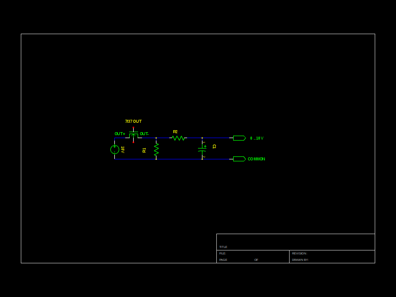

I have a Sherline motor with speed controller that I am trying to set up with my Linux CNC with Mesa 7i96 card. The speed controller uses a potentiometer with three leads to control the speed of the spindle motor. Is the 7i96 with Linux CNC capable of somehow replacing the potentiometer?, or do I need another add on card from Mesa to do this? It looks like my encoder is sending the right signals to the 7i96, but I would like to be able to control the speed with Linux CNC and not with the potentiometer if possible.

You have to be very careful as the potentiometer on many low-end speed controls
runs at line voltage potential. If this is the case with the Sherline you need to use
a fully isolated potentiometer replacement device. Mesa makes one (the SPINX1).
This is a simple small card that takes 3 signals (PWM ENA DIR) and provides a
potentiometer replacement plus isolated FWD REV and ENA outputs.
If the potentiometer does not run at line potential, you could use one of the 7I96s isolated
outputs and a RC filter to make a potentiometer replacement, something like this:
The schematic shows a 7I37 output but the 7I96 outputs are identical
This would be driven by a software PWM component in the hal file

I did not see that card you mentioned, I think it would be really what I need. I will contact Mesa tech support and see what they say.
I am not really sure about trying to drive the motor with a PWM from the board. That seems it would totally eliminate the speed controller I have and there is a lot of specialized circuitry in there regarding torque, smoothness and such.

The PWM is used to generate the variable analog voltage in the
potentiometer replacement circuit

I get it, now I need that board you guys mentioned from Mesa.

The potentiometer on the KBIC controllers used by sherline does run at mains voltage. I use one of these
homanndesigns.com/index.php?main_page=pr...ath=1&products_id=25
and drive it from the parallel port with no issues. Should be no issue driving it with a PWM signal from a mesa
