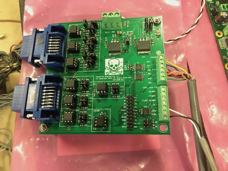

I have a couple of machines with yaskawa MX1 controls that use 12v single ended encoders. A while back I pitched the idea of building a board that converts the 12v signals to 5v differential and allows using the original wiring. My electrical engineer friend laid the board out and it is in testing process right now, so far it works flawlessly. You pug the original encoder and drive plugs on one side and wire the other side to your favorite I/o hard ware, for testing I used a mesa 5i25/7i77 combo. The board will also work with 5v yaskawa encoders with a jumper change.
After a bit more testing these will be available for sale. Pm me if you are interested. thanks for looking.

You can contact me at jayare@ mm-machine-shop.com. This is a simple converter board, it does not decode Yaskawa’s absolute encoders. I’ll help you however I can.

A while back I had started to research the Yaskawa absolute encoder, from what I had found, it was an incremental encoder that also has a serial output for absolute motor position. It used regular differential signals , I didn’t try it, but it would seem to me it would work as an incremental encoder by its self. I’ve seen several of your posts, the kind of stuff you are doing is light years ahead of me. If you need the Yaskawa manuals , I can see if I still have them. They explain the signaling, but not any protocols. Best of luck!

Good Morning. I am researching the Yaskawa communication protocol form and have not located manuals regarding the command word of the communication protocol. At the electronic level D + / D- is the output (A /
of an rs485 transceiver (7lb176), the 4 inputs of the c.i. They are controlled directly by the yaskawa microprocessor. It also seems to me that the behavior is similar to an incremental encoder. I will continue investigating. Thank you very much for your contribution, greetings.

Yeah if its the type I remember they send the absolute position in serial
(Async UART) at power up and then switch to standard incremental mode

(TSE-S800-15.1C.pdf: Σ SERIES SGM/SGD BULLETIN) contains a detailed description of the serial protocol for Yaskawa 12-bit absolute encoders and "Phase S (PSO)" encoders. See page 55 (pp 49) and onwards. Maybe it helps?

The STMBL drives can decode Yaskawa encoders.
It might be possible to use the STMBL STM32 code (and possibly the PCB design)
github.com/rene-dev/stmbl/blob/master/src/comps/yaskawa.c
Using the actual drives would be easier still, if they were actually available.

AFAICR some Yaskawa drives use this same interface to the controller.
It should be pretty easy to add this to hostmot2, as its just a UART
on the 'A" encoder signal.
