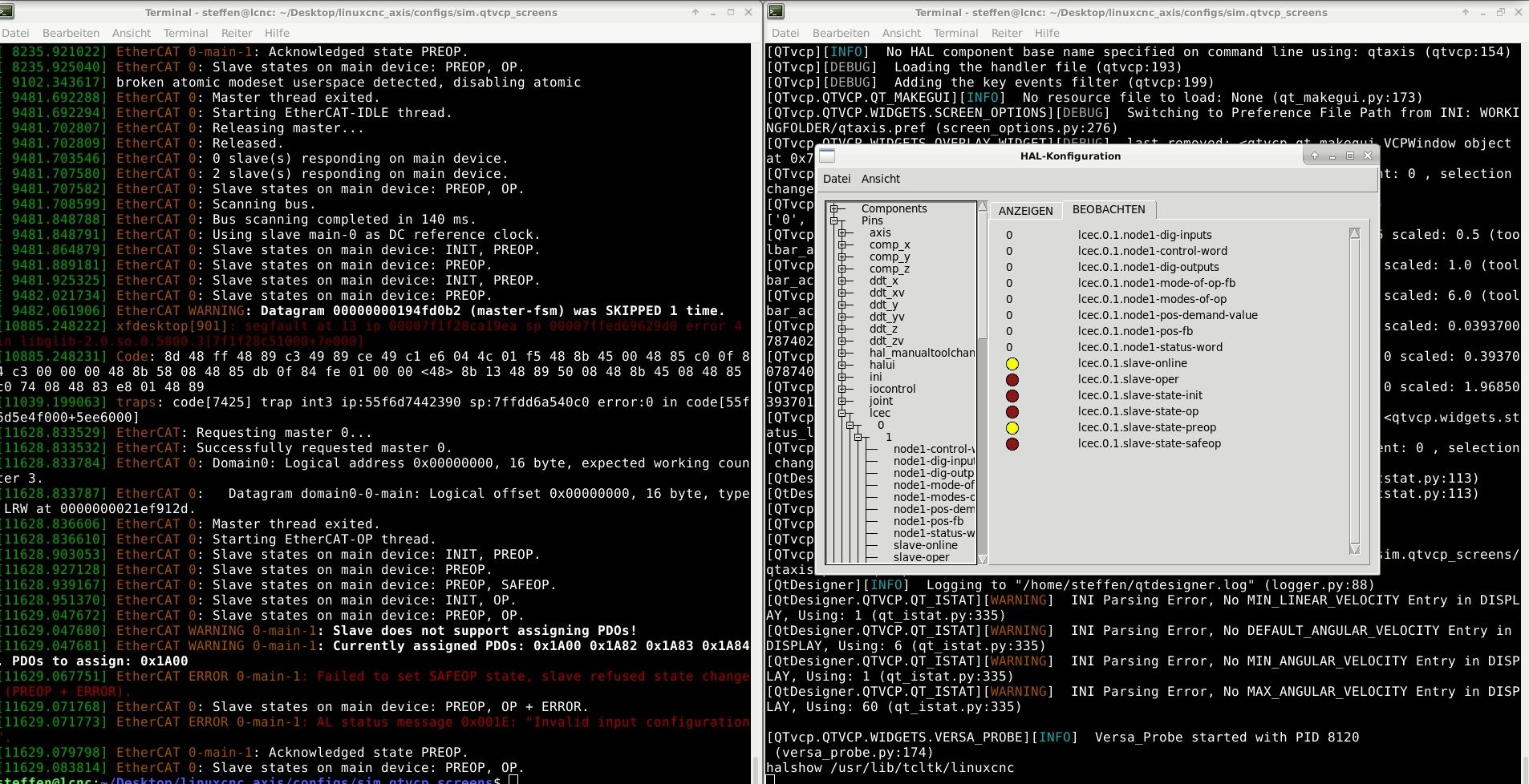

Can you attach your Last Twincat config for with the el6751 and your LinuxCNC XML for your drives? I‘m currently test JAT servodrives with LinuxCNC ethercat and canopen. This will help me a lot. At the Moment my el6751 go in error. With my twincat config it go in run Mode nur with LinuxCNC Not.
thanks
03 Nov 2021 18:49 #225133 by Sviper
Replied by Sviper on topic Configuring LinuxCNC with ethercat devices
Hallo Leute,
so Fehler gefunden. LCNC startet jetzt mit der XML. Aber Klemme geht nicht auf OP.
