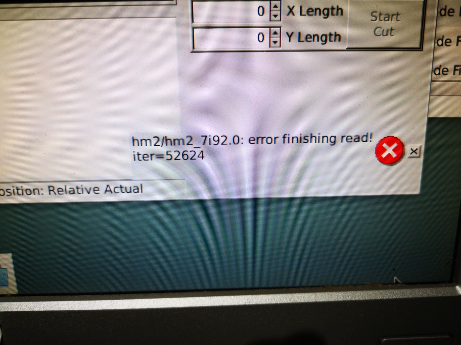

Suddendly after the arc firing it stoped (no response from the card).
I restarted the setup and it worked again, I did some more testing and it happend some time.
I thaught it is because of EMI and started to change some grounding.
But id did it again and now I can't start it any more.
All the Led's on the 7i92 just blink breathli at startup and then just power stays.
I can't ping and I cant start the machine.

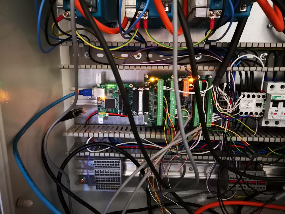

DO NOT use a new 7i92 until you find and fix the issue, it will end up dead.
For plasma, as a general rule:
-Proper grounding, www.google.com/search?source=hp&ei=j07GX...ccDz4Q4dUDCAY&uact=5
-shielded cables, shield connected ONLY on one side, usually the control box side. NEVER both sides, except where required, see above.
-signal cables as far as possible from the high voltage/high frequency cables
-torch cable going parallel with motor/sensor cables ONLY if cables are shielded.

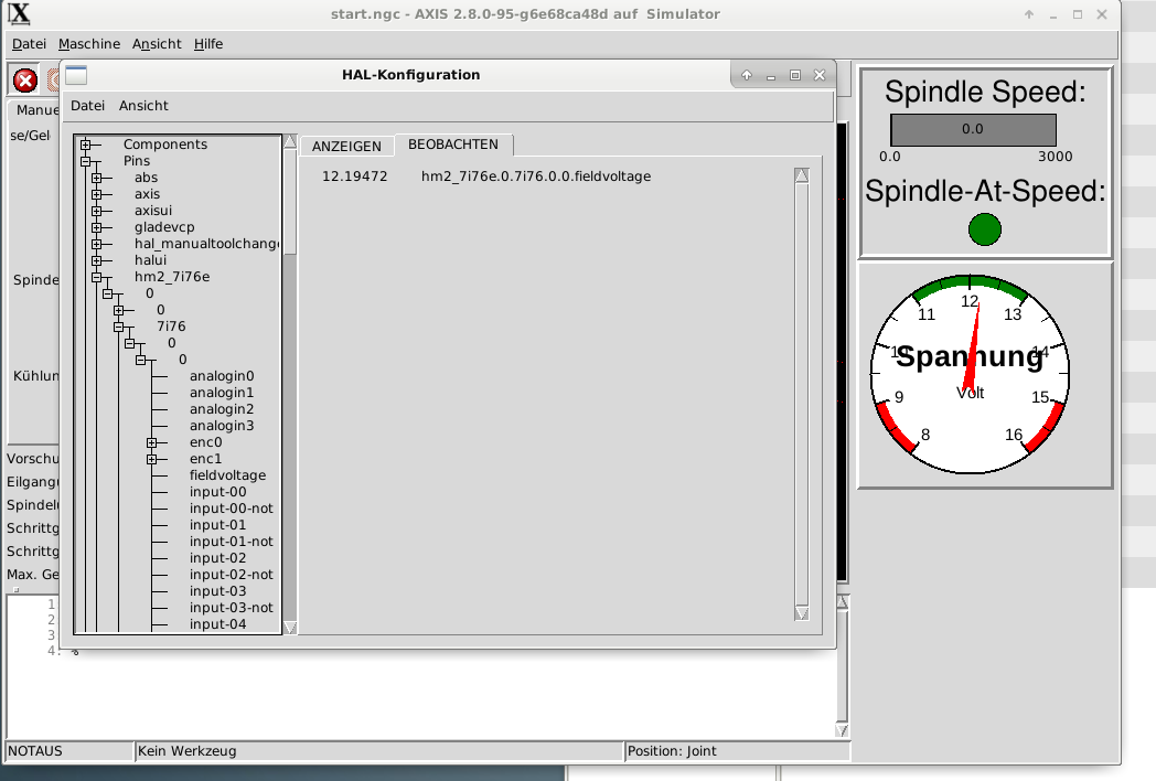

a short circuit is sometimes evident in the control circuit. I built a voltmeter to keep an eye on this. maybe this will help.
add in custom_gcvp.hal
net fieldpower pyvcp.fieldpower hm2_7i76e.0.7i76.0.0.fieldvoltage
add in pyvcp-pannel.xml
<!-- Fieldpower -->
<hbox>
<relief>RAISED</relief>
<bd>3</bd>
<meter>
<halpin>"fieldpower"</halpin>
<text>"Spannung"</text>
<subtext>"Volt"</subtext>
<size>200</size>
<min_>8</min_>
<max_>16</max_>
<majorscale>1</majorscale>
<minorscale>0.5</minorscale>
<region1>0,9,"red"</region1>
<region2>11,13,"green"</region2>
<region3>15,16,"red"</region3>
</meter>
</hbox>

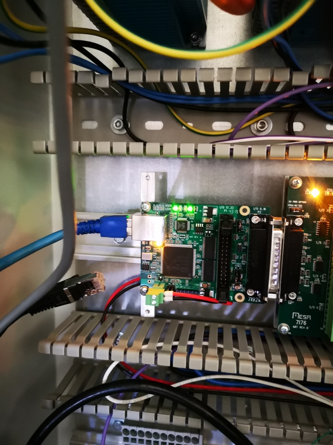

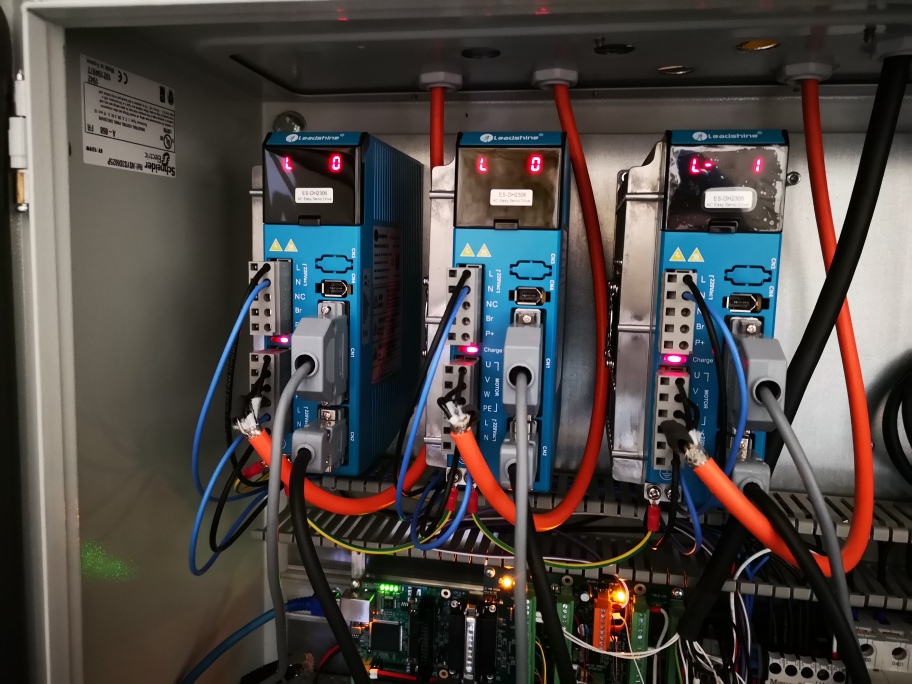

- cnc4ever
- Posts: 11
06 Dec 2020 13:09 #191217
by cnc4ever
Replied by cnc4ever on topic Plasma Cutter 7i92M stoped working
Thanks for the hints.

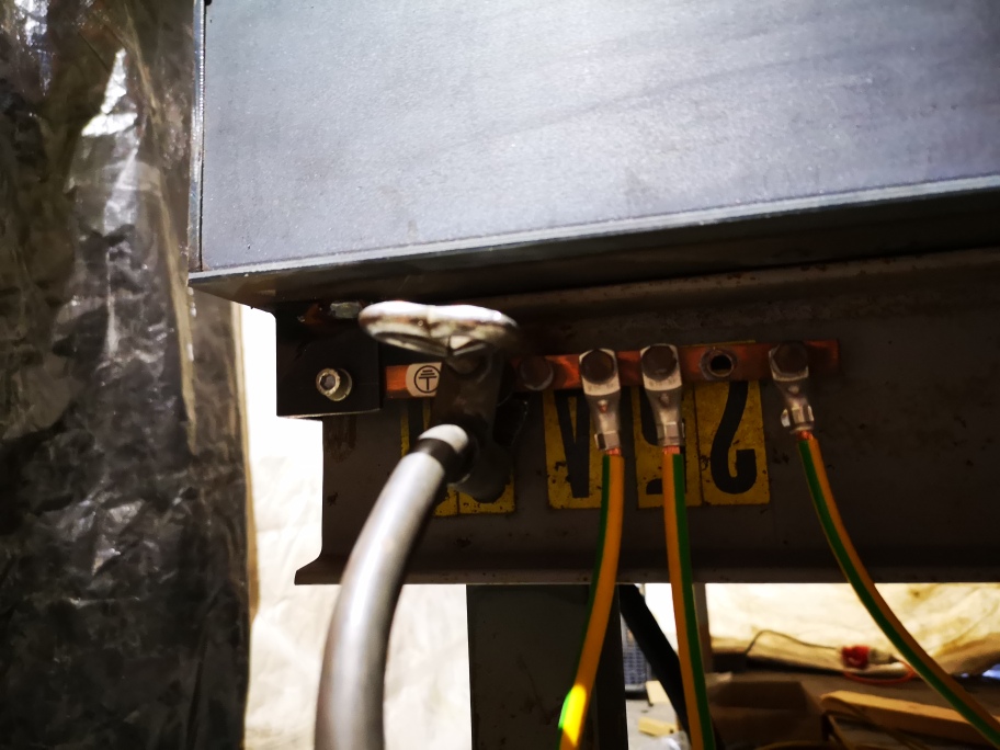

I redid all the grounding as in the hypertherm document.
I replaced the 7i92 and tested everything.
Was working flewless.
But as soon as i started the plasma it happend again. Actualy even faster. the pasma didn't even fired.
Now the "new" is broken to, but the ethernet chip is cool. Don't know what is broken.
I added some pictures.

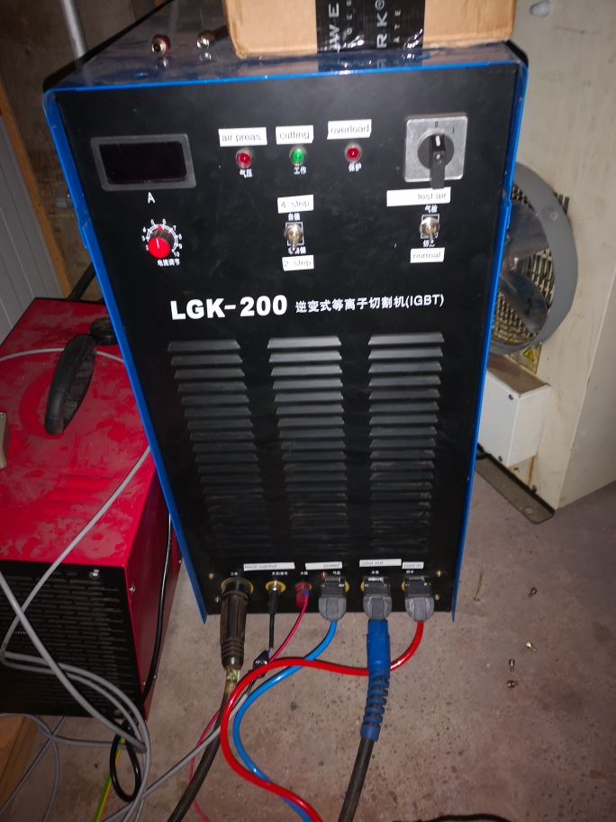

I know my plasma cutter is probably not the most commen one.
Chinese LGK-200. Did anybody ever worked with this one (or a similar?).
I could get it preaty cheep this is why he is here.
I don't know what I should do. Will probably try to get a osciloscope and do some measurements....
- 5v supply
- pe to 5v
Its not very easy to test if the replacment costs 100 each time -.-
Will also order a replacment ethernet chip for the old one.

06 Dec 2020 15:30 #191221
Replied by PCW on topic Plasma Cutter 7i92M stoped working
It looks like the LGK-200 is a HF start plasma source. These are notorious
for generating huge amounts of RFI when starting and require very careful
attention to any possible coupling of this noise into low level circuitry in the
control box.
control box.

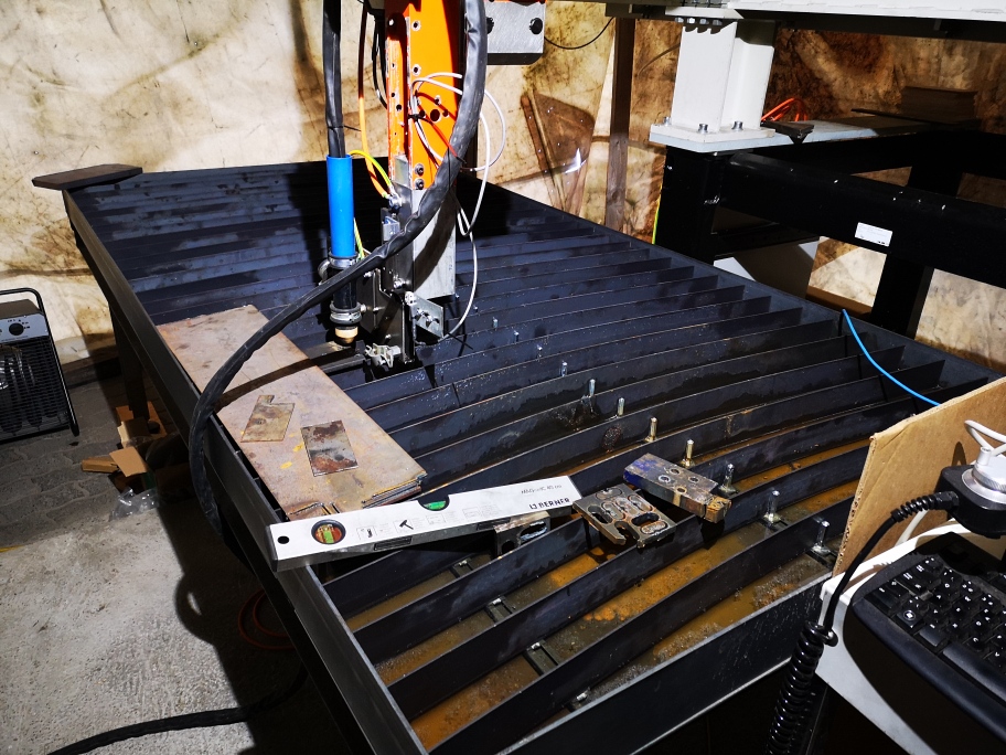

06 Dec 2020 16:26 #191230
Replied by tommylight on topic Plasma Cutter 7i92M stoped working
On the picture with the torch you have plenty of cables rolled, that is strictly not good on any HF machine.
All cables as short as possible, HF/HV cables never in parallel with low signal cables, the torch cable on that plasma is most probably not shielded at all, so shielding everything else from it is imperative.
You are using servo drives, those will also produce big amounts of interference from the moment they are enabled, so putting ferrite shielding on motor and power wires is a must.
