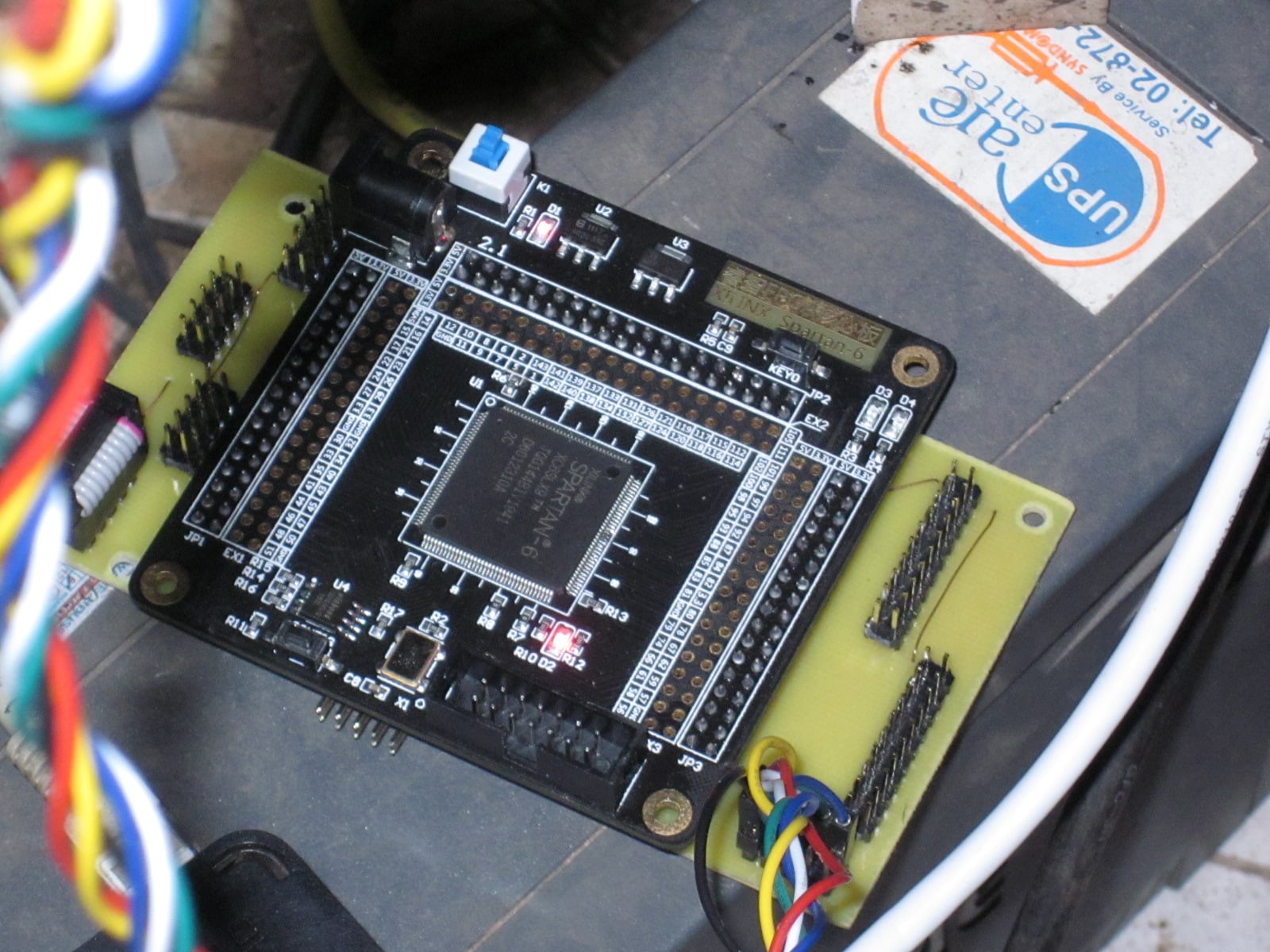

meo_udon post=192420 userid=28441用于 Rpi 的 DIY 7i90SPI 很容易。
07 Jan 2022 13:38 #231027
Replied by andypugh on topic Raspberry Pi GPIO Performance? (I want to design a driver board)
Have you seen: forum.linuxcnc.org/27-driver-boards/44422-colorcnc?start=0I also want to use FPGA as the driver board, but I can't buy mesa driver board in China.
