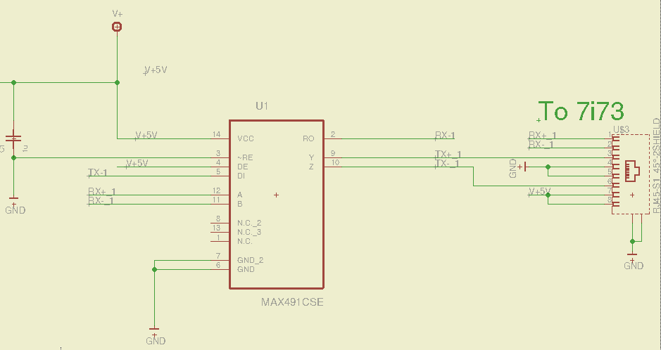

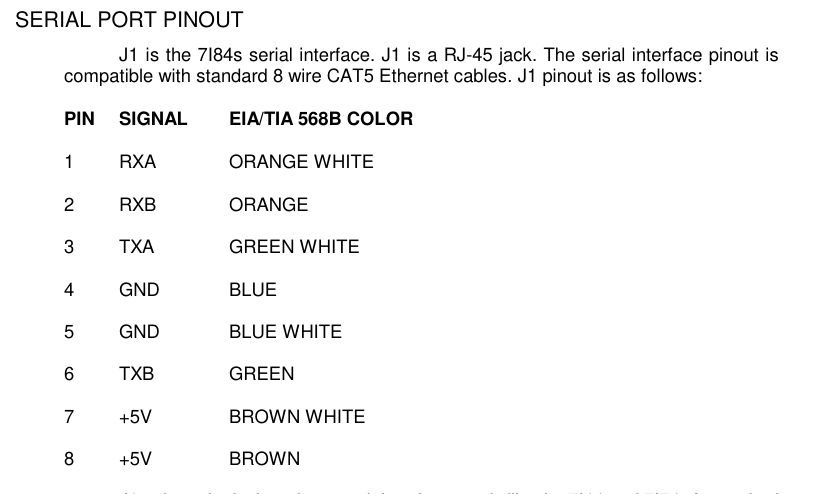

I am confused at the moment and have a very basic Question on RS422.
I am building my own breakout board to connect a SSerialCard 7i84 to the 6i25 using a MAX491 chip. Therefore I need to match the RX/TX Signals and I am not sure about the datasheet here.
In the Datasheet of the 7i84 pin1 is named RX. Does that mean that the SSerial - RX Pin of the the 6i25 should connect here (like in my schematic) or the SSerial TX?
My Shematic:
Matthias

13 Dec 2020 02:48 #191805
Replied by PCW on topic Mesa Wiring RS422 6i25 <-> 7i84
Yes FPGA TX goes to 7I84 RX (and vice versa)

14 Dec 2020 13:45 #191963
by MatthiasF1210
Replied by MatthiasF1210 on topic Mesa Wiring RS422 6i25 <-> 7i84
Thanks,
I had change my schematic, now it's running.
