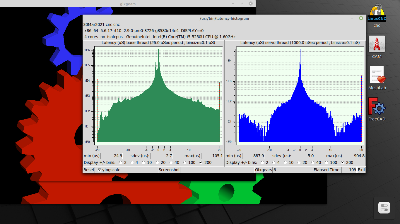

30 Mar 2021 08:45 #204122
by zack
Replied by zack on topic 7i76e what am I doing wrong
this is mint with a new kernel some probs in timing with 7i76e
do you think this will work... histogram below
- Posts: 18122
- Thank you received: 5337
30 Mar 2021 08:57 #204127
Replied by PCW on topic 7i76e what am I doing wrong
Try it with the base thread disabled (the base thread will not be used and a 25 usec basethread saturates the CPU with context switching)
latency-histogram --nobase --sbinsize 1000

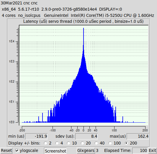

The following user(s) said Thank You: zack
- zack
- Posts: 91
- Thank you received: 47
30 Mar 2021 10:10 #204131
by zack
Thanks i can only test blind now as the cnc machine with (7i76e) is not available.
the pc is very stable and supports all required drivers with this kernel.
Is this histogram good enough., the 4.19.x-rt kernel is a bit faster, dose this matter.
- Posts: 18122
30 Mar 2021 12:10 #204139
Might be, What are your ping times? (pinging the FPGA card)
