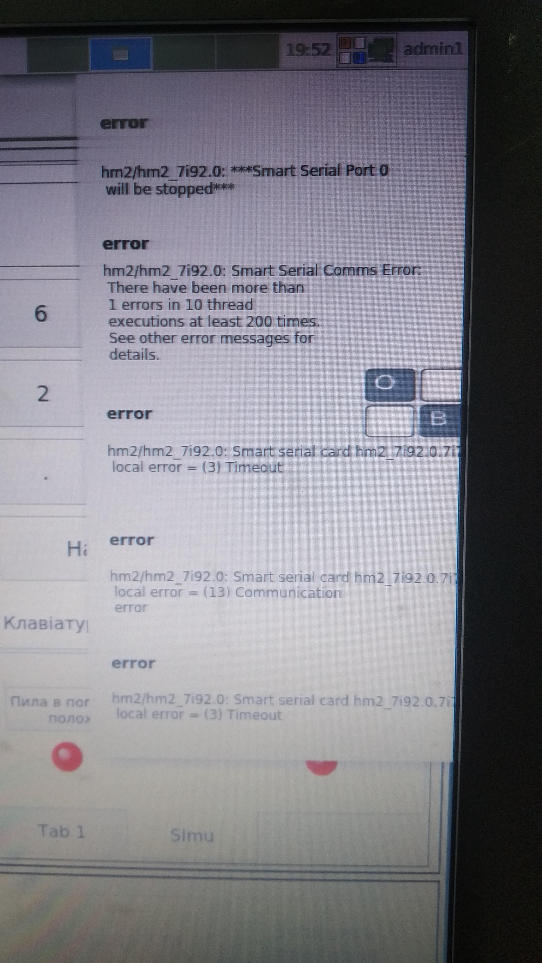

- aleksamc
- Posts: 569
- Thank you received: 67
04 Feb 2021 05:12 - 04 Feb 2021 05:14 #197619
by aleksamc
Replied by aleksamc on topic Configuration 7i92 and 7i77 - get error
I'm alsmost everything configured in hal.
But yesterday I gor comunication error 2 times.
Second time was at the end of the day when machine was stopped (not moved but turned off).
I have
setp "hm2_7i92.0.watchdog.timeout_ns 2000000"
Errors are
"smart Serial Card ... Local Error ... Timeout"
I must say that I use very short Ethernet cable, less then 0,5m.
Also this cable is shielded to machine GND that is Neutral.
Possibly, it's better to shield to 0V of DC current?
But I don't think that problem could be in this. 4 years ago I used 7i92m board to make comunication with PC on 25m length of Cable and there is no Problem with communication. But there watchdog is set to 5 000 000.
I have
Errors are
Last edit: 04 Feb 2021 05:14 by aleksamc.
- Posts: 18026
- Thank you received: 5295
04 Feb 2021 06:38 #197620
Replied by PCW on topic Configuration 7i92 and 7i77 - get error
That looks like more of a real time issue than a sserial issue
What was the first error?
Starting LinuxCNC from the command line would probably help
when debugging since all the errors will be logged there and can be copy-pasted
here
here
