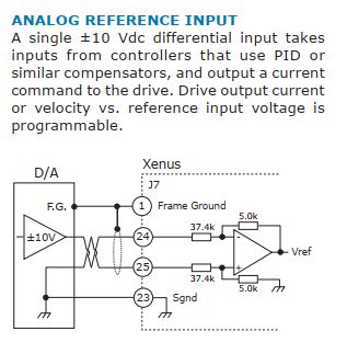

I've jumped in and am trying LinuxCNC for the first time. 7i76ED arrived and I'm working on the wiring diagram.
First stumbling point is analog spindle control. My spindle drive is a Copley Xenus XSL servo drive, and it's capable of multiple command input types (see attachment).
I'd prefer to use a standard 0-10V scheme, but I'm confused by the Copley +/-10V analog input diagram.
My previous experience is with VFD's that supply the Vref to a pot (or controller), and the Vsignal and V- return to the VFD. The 7i76ED appears to be set up to use the 'standard' VFD arrangement.
I suppose I could sacrifice an axis and use PWM command, but I'd rather not as I have plans for the 7i76ED's 5th S&D output.
Unless one of the other digital outputs can be used as a PWM?
If anyone can take a look at the Copley diagram and give me some guidance I'd appreciate it.
Thanks,
Ralph

Thanks, that confirms my understanding of the 7i76 analog connections.
But I'm still at a loss on the 'differential analog' input on the Copley drive.
Maybe supply 10v to the 7i76 Vin pin from a separate power supply, and the TB4 SPINDLE OUT & SPINDLE - get connected to Ref+ and Ref- on the drive?

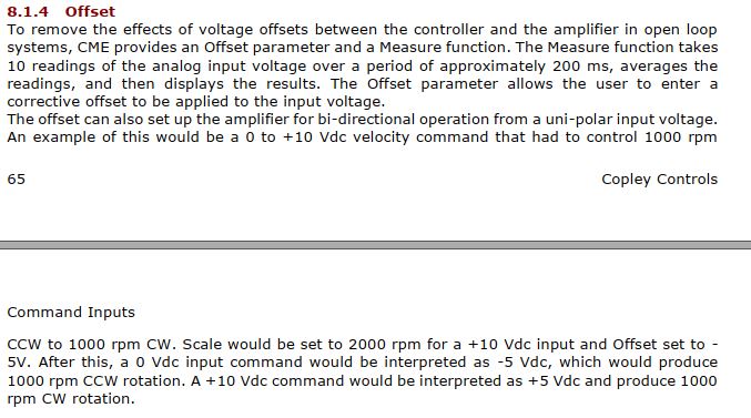

Thanks all.
I'm only interested in velocity mode, so that part's sorted.
Re-reading the drive manual, it looks like it can accept a 0-10v input, and I could use the scaling and offset functions in the drive to adjust the desired range. So a 5v signal would be stopped, and 0v would be CCW. Start/stop would be digital input enable signal.
Correct me if I'm wrong...
1. SPINDLE+ connected to power supply V+ (adjusted to 10v)
2. SPINDLE- connected to power supply V-
3. SPINDLE OUT to drive Ref+
4. SPINDLE- also to drive Ref- (or to PS V-, same thing)
Is the 0-10v CW/CCW scheme possible in LCNC? I don't see that a direction command is possible on one of the GP digital inputs.
Snippet from manual:

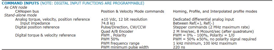

16 Feb 2021 08:34 #199065
by spumco
Replied by spumco on topic 7i76ED to servo spindle - connection question
The drive only accepts direction input in PWM (torque, velocity, position) or S&D modes.
In any of the analog modes it either uses +/-10v for CW/CCW, or 0-10v with the appropriate offset (0-5v is CCW, 5-10v is CW).
I'm beginning to think going with PWM might be simpler. I can always add a 7i85 to get back an additional axis.
Do I need to flash or otherwise configure the 7i76ED for PWM output on TB3 STEP4?

16 Feb 2021 09:37 #199073
by aleksamc
Replied by aleksamc on topic 7i76ED to servo spindle - connection question
If servo doesn't support change of direction with discreet input, than you can use relay that will change polarity of your output.
Or you may buy additional board.
