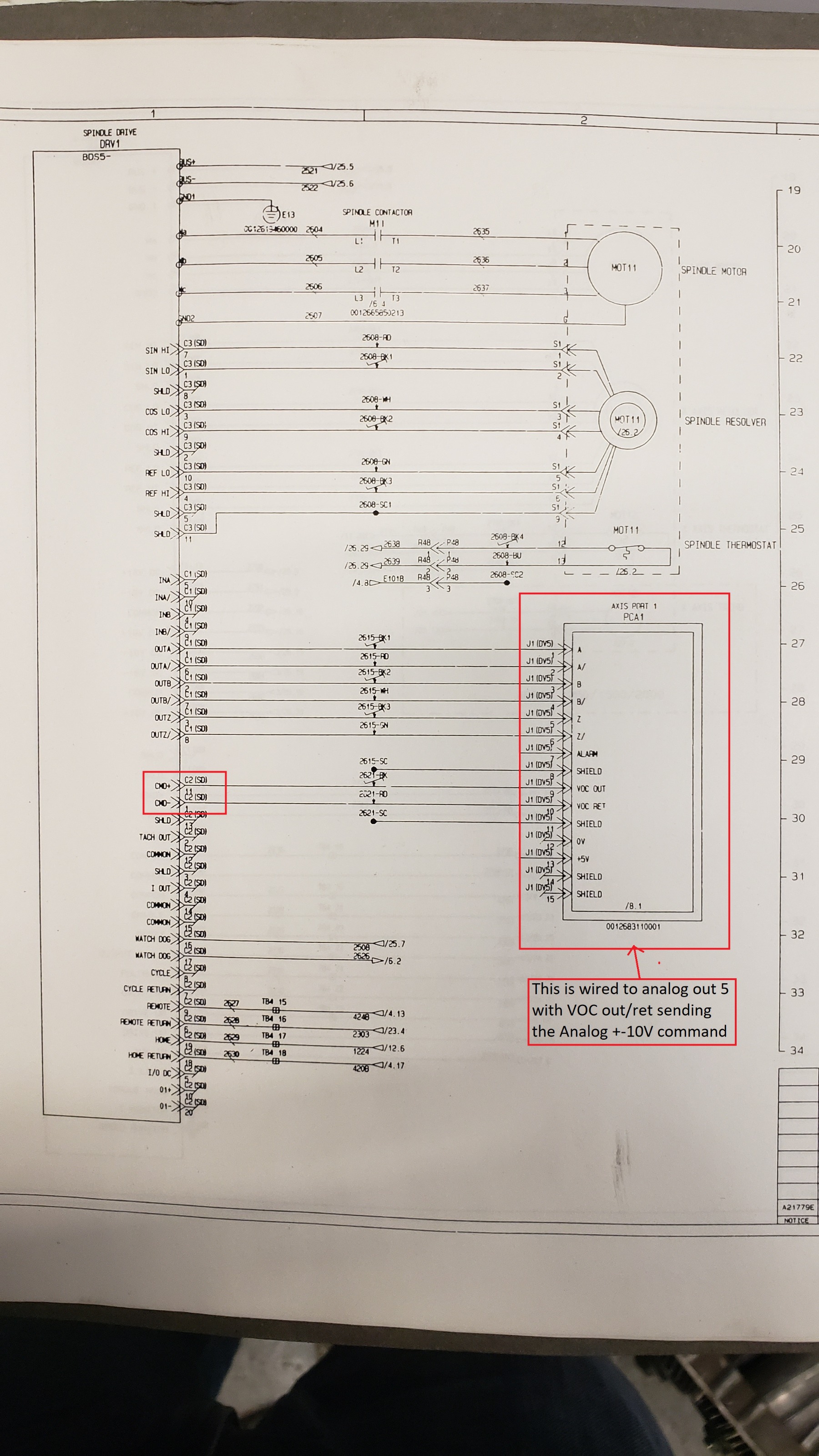

Like I said before I am trying to control the BDS5 spindle drive that came with the machine. I corrected the analog out to 5 and my machine has an output that kicks the spindle in CW/CCW rotation which enables the spindle. Here is a pic of the wiring diagram that came with the machine. I am able to control the spindle up/down with the manual toggle buttons but when commanded via MDI it faults the drive. I need to get a ramp in place that can smooth the transition from 0 to speed. Is there an example of code that I can use to get this in place?

Hey all, I have been messing around with this some more and I think I may have it pretty close. For some reason, the commanded spindle speed ignores the ramping actions and the commanded speed is almost instantaneous. This VFS5/BDS5 drive behaves pretty much an axis drive but accepts +-10V for commands. If I can get this to soft start to work I think I can avoid the drive faulting and I can start working on the toolchanger. That piece should be pretty good since this drive orients with an only an input pin.
Can a seasoned veteran of linuxcnc look over my code below and let me know if I am missing something.
