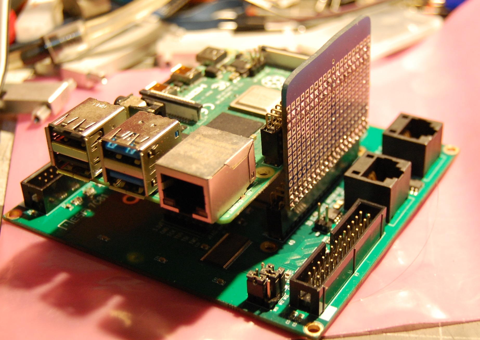

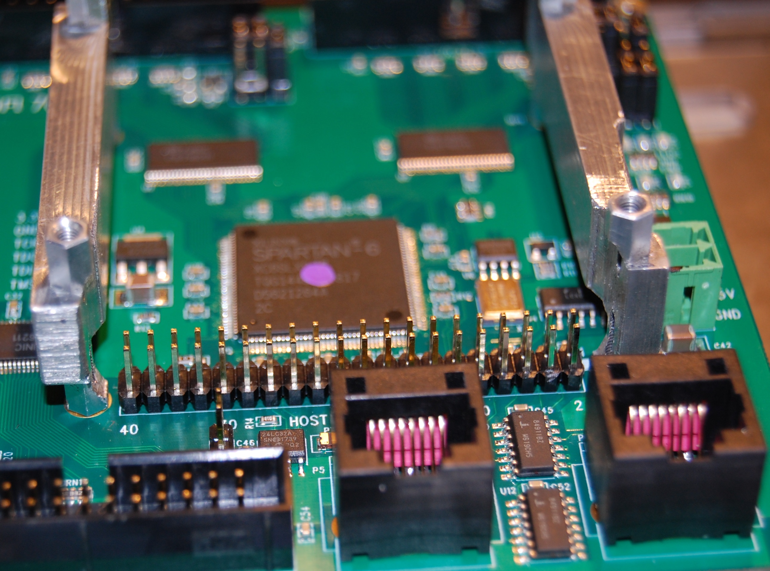

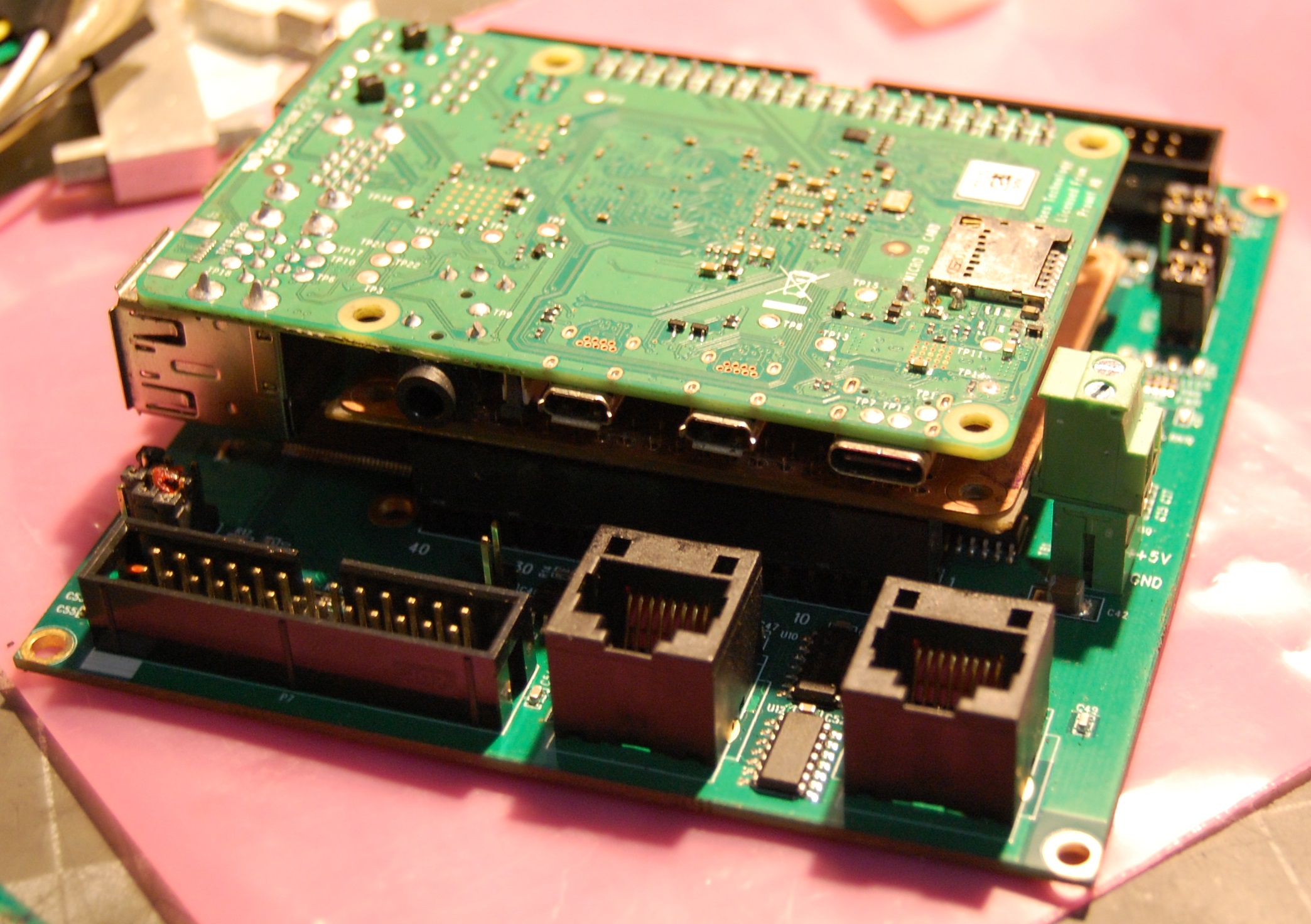

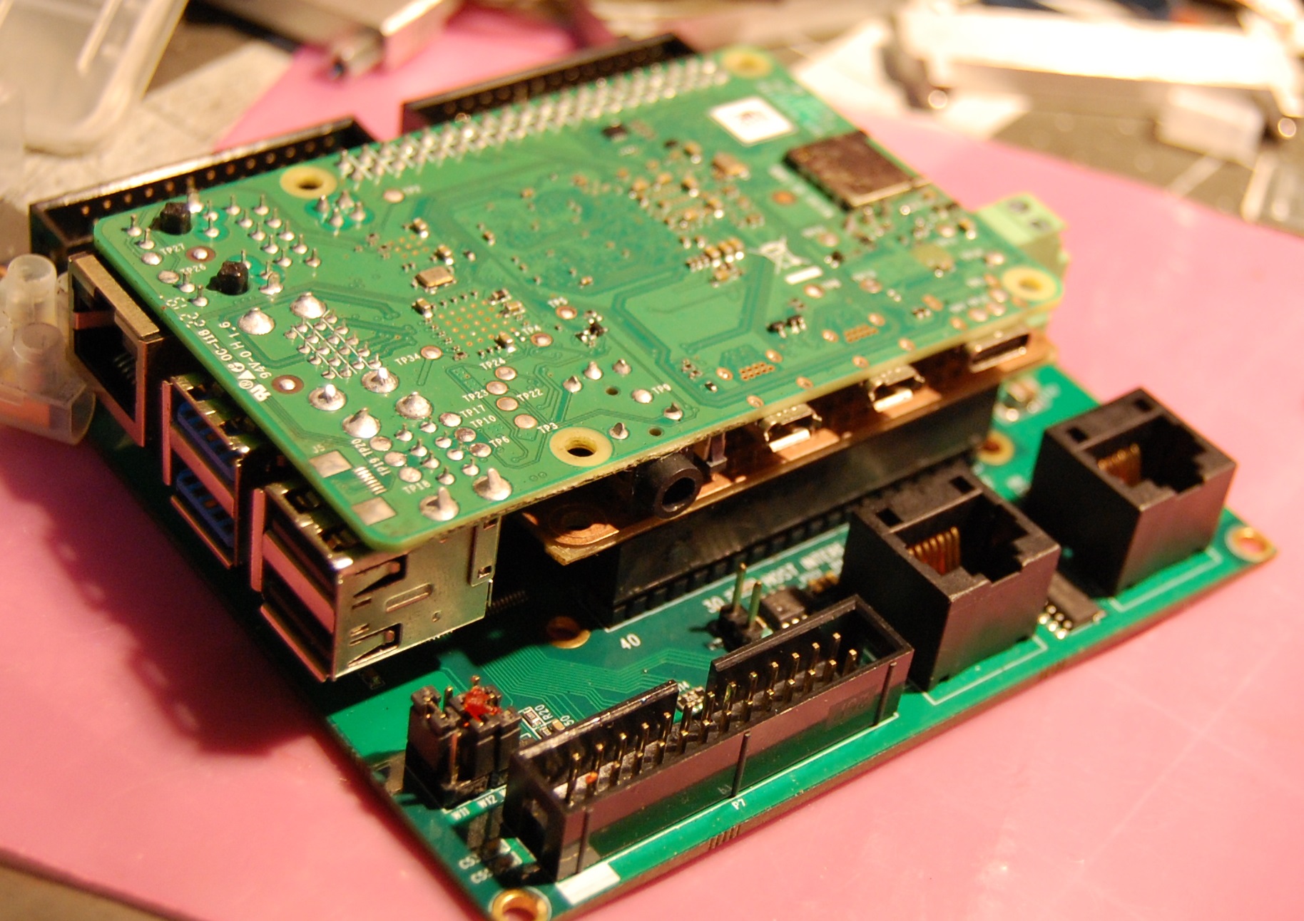

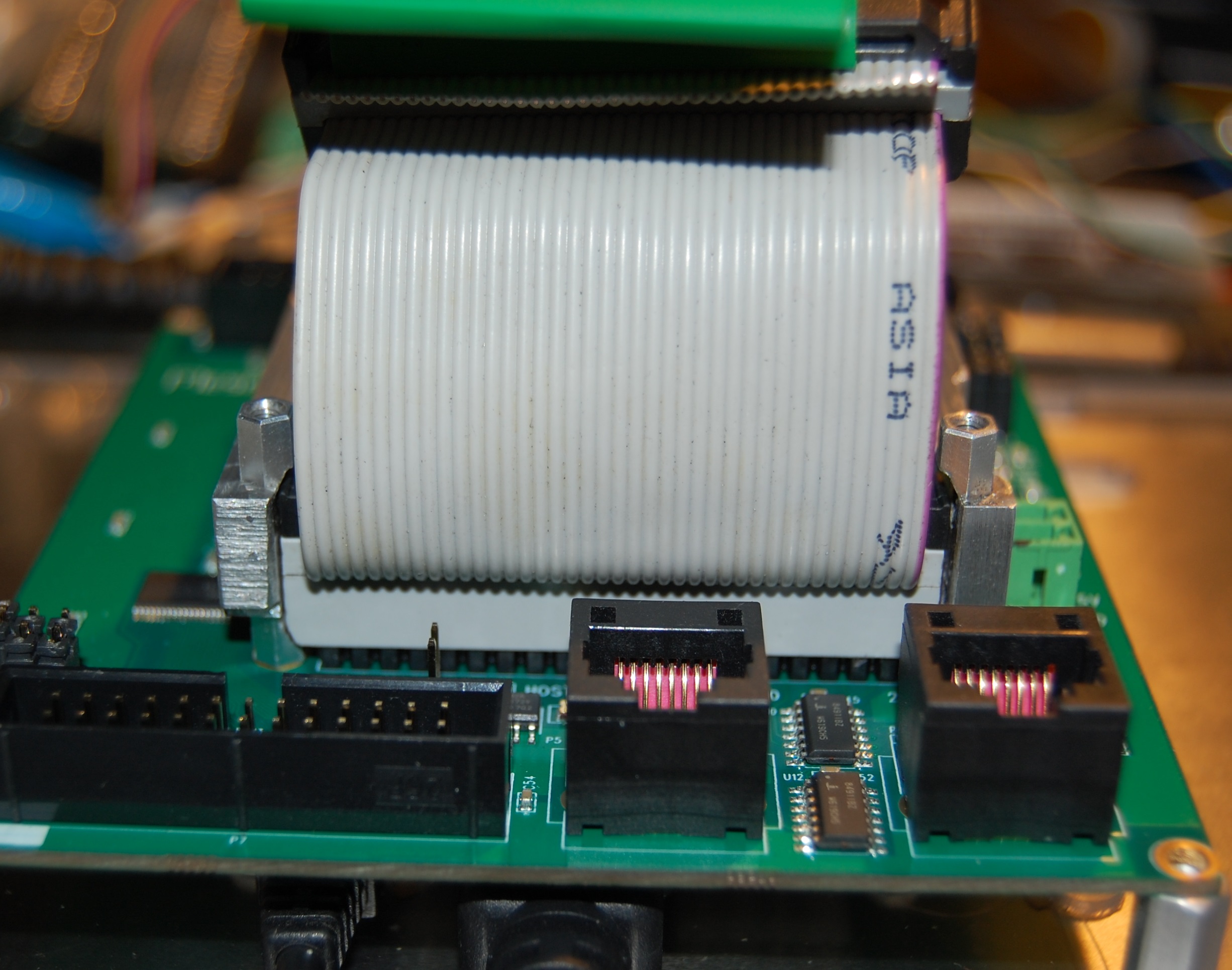

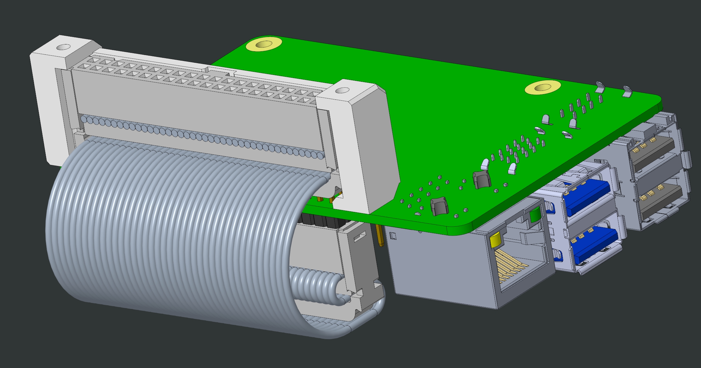

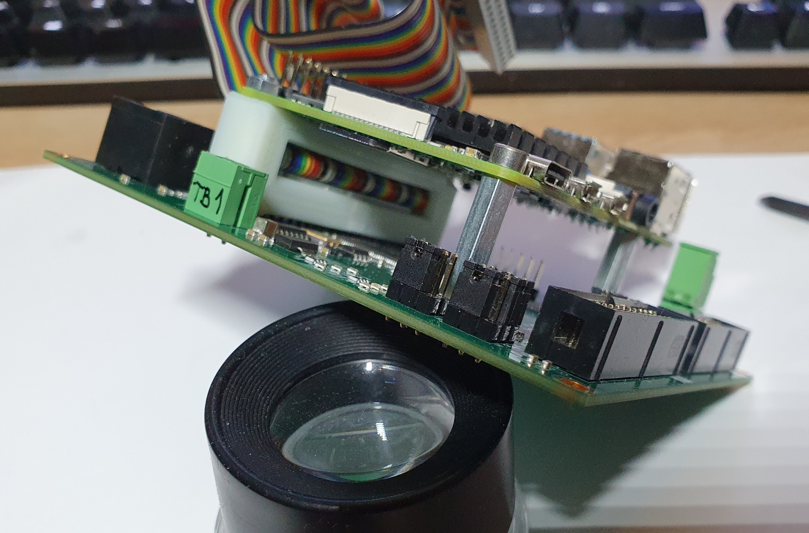

A connector holder designed to mount the RPi4 on a 7c81 card may be useful to someone.

That's neater than my male-female spacer with a large flat milled out on one side

Lookin good! Shame on RPI for letting this bs go on for this long.
I have also played my hand at trying to find the cleanest setup and have access to the serial ports
40pin dupont connector
-too ridged
2 right angle 40pin headers
-would be good, but pretty tall and i messed something up
custom pcb
-perfect! except it blocks the serial port worse than anything else because hdmi is flipped
-super low profile and fan mount
-would work best as a compute module board
-too ridged
custom pcb
