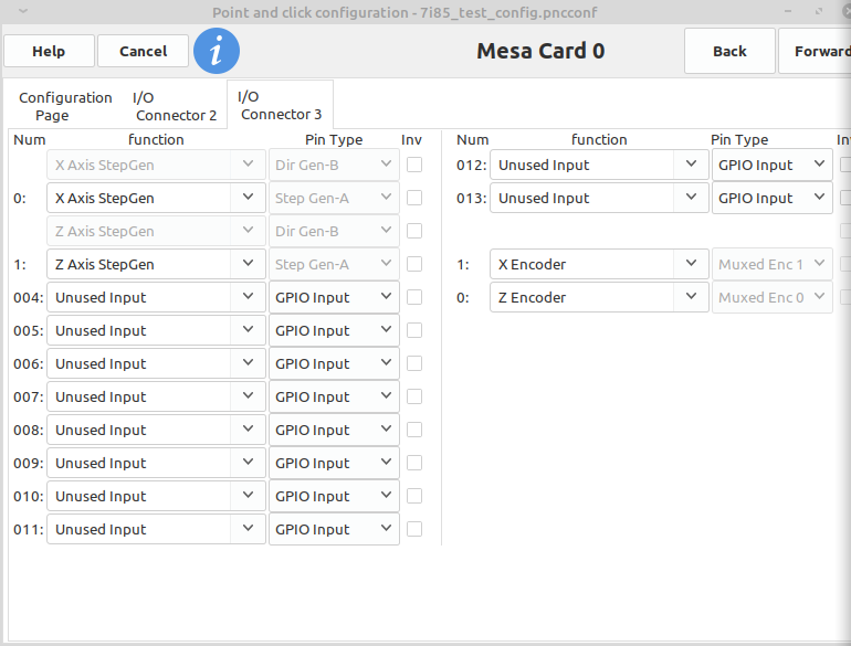

The 7i76 is plugged in and powered up (I recycled the power twice) although I have no 7i85 at this stage.
When I go in to PNCConf, I can see the 5i25_7i76_7i85 option under "5i25/configs/hostmot2" but despite selecting that, I seem to be seeing just the base 5i25 options.
Can somebody tell me what the issue is please?

From PNCConf, there seems to be a 7i76 detected to some degree::
PCI device 5I25 at 0000:02:00.0
SSLBP port 0:
SSLBP Version: 1.43
SSLBP Channels: 4
SSLBP Baud Rate: 2500000
sserial device at channel 0: 7I76 GPIO+SPINDLE (unit 0x10000177)

22 Feb 2021 11:22 #199727
Replied by PCW on topic Adding 7i85 to 5i25/7i76?
Did you power cycle the PC or run the --reload command?
If not, you will still have the default 7I76Xx2 firmware loaded
Pncconf does not have any 7i85 support but depending on what you are doing
it should be pretty easy to add to the hal/ini files pncconf creates for a plain 7I76 configuration

22 Feb 2021 11:40 #199732
by Muzzer
Replied by Muzzer on topic Adding 7i85 to 5i25/7i76?
Sure enough, that worked. I can now see the 7i76 in PNCConf - but only by using discovery mode. Is this expected? I was expecting to see it in the pull downs within PNCConf.
Equally can I expect the 7i85 to appear when that is plugged in and I use discover mode?

22 Feb 2021 12:16 #199743
The 7I85 will not show up as it is a passive device
what will show up are additional encoder pins/parameters
if you enable more encoders
(plus more sserial devices if you have them installed on the 7I85)
