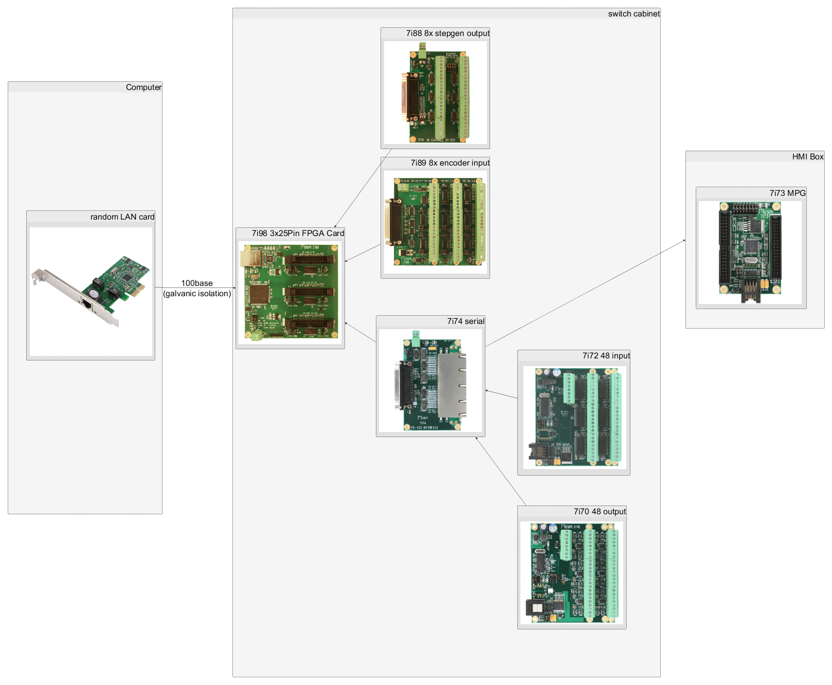

Hello,
I am building a big cnc machine and could need some help with the selection of mesa cards.
As an overview:
- 5 axis VMC (3axis + 2axis optional connectable trunnion table)
- main spindle is belt driven by servo and has separate spindle encoder
- complicated (but still trivial) atc unit. Basically constists of a two-floor carousel with 2x16 tools and a loading robot. The carousel is a servo rotary axis and the loading robot has a servo lifting axis with pneumatic rotary & pneumatic extension axis.
After watching a video from talla83 it is quite clear to me how to program the tool change in linuxcnc. Those devices are just Joints & Inputs/Outputs that can be programmed as subroutine.
But which cards to use to connect all those parts to linuxcnc?
JT and others were helping me in irc chat already - Thanks!!! There are still open questions...
Alltogether I need 8 Stepgen outputs and 6+1 encoder inputs (3x XYZ + 2x AB + 2x ATC + 1x Main Spindle).
- All Servos should be controlled by RS422 quadrature pulses (Stepgen with A/B Signals)
- All 5 feed axis have separate feedback system for closed loop (3x Linear Encoder + 2 optional high-res encoders for the trunnion, Spindle encoder) all with index. Mpg wheel also exists -> 6+1 Encoder inputs (6 with index).
I also attached an overview of necessary modules.
(I know servos are often controlled by +-10V speed but I'd prefer digital quadrature output for noise immunity, dynamic range and error detection and position mode).
JT was suggesting those mesa ethernet cards but wasn't sure if it can handle the number of daughter cards. 7i98 would fit fine but the configuration file for 7i88+7i89 does not exist yet and it might be too much data for 100mbit ethernet...?
I like the ethernet interface because it is a small & robust interface and includes galvanic isolation to my computer which is mandatory.
I was checking the available cards now and attached my favourite configuration as pdf. A big question is - is my card selection possible or do I need to change it? PCW seems to know this - could you please...
In case it is not possible - could I use two lan cards (dual pci - lan adapter) with two 7I94 (one connects 7i68, the other one connects 7i89, 7i72, 7i70 & 7i73)?
(I have a spare 5i20 where I was thinking about connecting an encoder card but I'd actually highly prefer ethernet cards to prevent cable length issues from computer to electric cabine. But just for reference - is it possible to use a 7i98 or 7I94 and 5i20 with ethernet-card compatible kernel?).
Thanks in advance & best regards,
Alex

- Posts: 18103
- Thank you received: 5326
02 Mar 2021 21:11 - 02 Mar 2021 21:30 #200825
Replied by PCW on topic mesa setup 7i98 with 7i88, 7i89, 7i74, 7i70, 7i72 & 7i73
A 7I98 does not have the FPGA capacity for 8 stepgens, and 8 encoders +sserial
I would suggest a 7I80DB-16 or 7I80DB-25 as the base FPGA card for a 7I88+7I89+7I74 setup
100BT is not a limitation at a 1 KHz servo thread
Last edit: 02 Mar 2021 21:30 by PCW.

- Posts: 18103
02 Mar 2021 23:33 #200855
I would have to make a bitfile for that combination.
I dont think pncconf will help too much except for making a
skeleton configuration that will need hand editing
I can check if a 8 stepgen, 8 encoder, 8 sserial config will fit in a -16 part, but I'm pretty sure it will (the only way to determine this for sure is to to compile a bitfile for that hardware set)

- Posts: 18103
04 Mar 2021 20:38 #201040
That firmware fits in a 7I80DB-16
(That has bitfiles for both the 7I80DB-16 and 7I80DB-25)

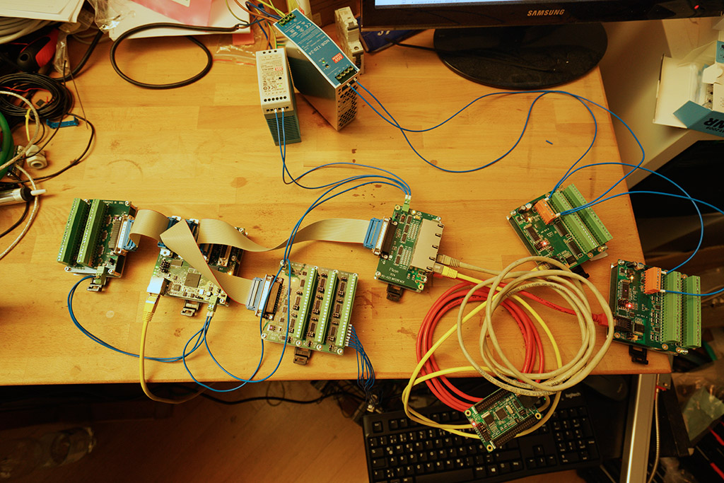

14 Nov 2021 14:05 #226469
by PasstScho
Replied by PasstScho on topic mesa setup 7i98 with 7i88, 7i89, 7i74, 7i70, 7i72 & 7i73
Hello,
It took me some time to start with the electronic part...
Now I am having it connected on a desktop-test-environment but I am getting strange errors where I don't know how to continue. I added the output and an image of my test-setup.
Maybe someone can check the output and tell me what could be wrong?
I loaded the board several times with "loadrt hm2_eth ..." and get different outputs each time. Looks like some sserial communication problem, but I don't really know what is going on.
Could my short flat cables between 7i80 and other cards cause this problem?

- Posts: 18103
14 Nov 2021 14:50 #226474
Looks like something global like dropped Ethernet packets
or really poor real time performance.
What do you get when you ping the 7I80?
