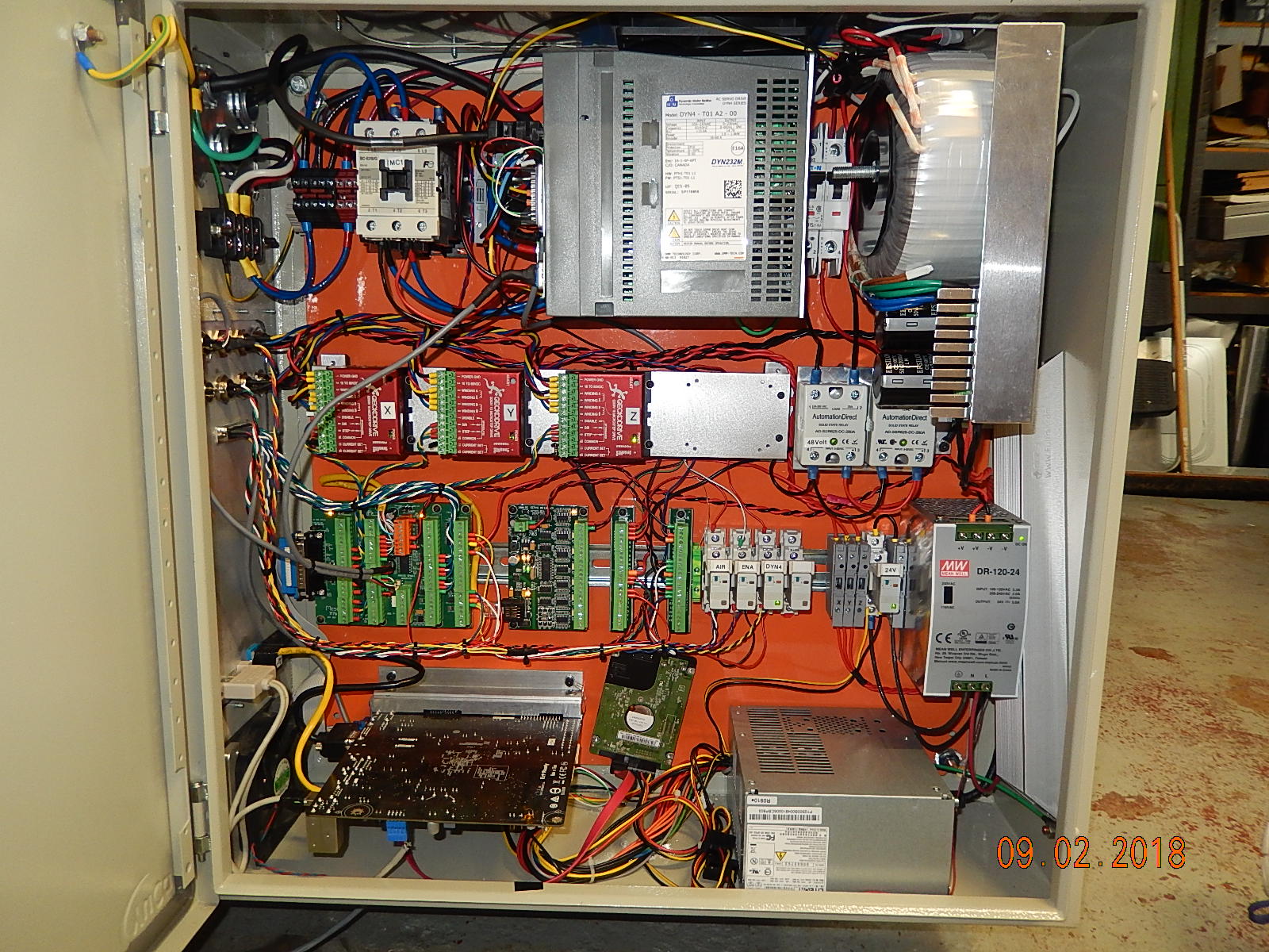

I started with a gutted PC case but out grew it before I had it finished. I ended up with one of these. Not the price range you are looking for but it is not outrageous.
Enclosure
It is barely big enough. I wish I had gotten a deeper cabinet but this one fits my space perfectly.
Enclosure
