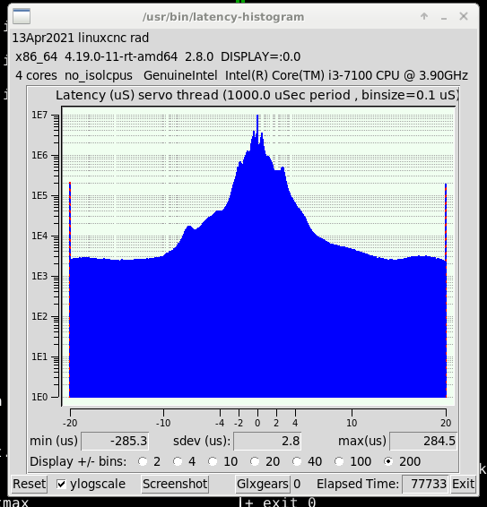

Hello
I'm trying to get a 7i76e system up and running. I'm converting a shopsabre router from WinCnc to Linux CNC.
The router has Mitsubishi servos driven by Mitsubishi drives in step/direction mode.
After running the Pncconf wizard I can start AXIS but I immediately get an error
hm2/hm2_7i76e.0: error finishing read! iter=6
Which I can clear. Then when I attemp to jog an axis I get these errors.
note: MAXV max: 1.000 units/sec 60.000 units/min
note: LJOG max: 1.000 units/sec 60.000 units/min
note: LJOG default: 0.250 units/sec 15.000 units/min
note: jog_order='XYZ'
note: jog_invert=set([])
joint 0 following error
emc/task/taskintf.cc 942: Error on joint 0, command number 95
task: main loop took 0.155724 seconds
joint 1 following error
emc/task/taskintf.cc 942: Error on joint 1, command number 162
joint 2 following error
emc/task/taskintf.cc 942: Error on joint 2, command number 229
command (EMC_JOG_STOP) cannot be executed until the machine is out of E-stop and turned on
task: main loop took 0.119844 seconds
task: main loop took 0.114117 seconds
emc/task/taskintf.cc 942: Error on joint 2, command number 296
After exit I'm getting the following error
Running HAL shutdown script
task: 75482 cycles, min=0.000026, max=0.155724, avg=0.010071, 3 latency excursions (> 10x expected cycle time of 0.010000s)
ioctl SIOCDARP: Network is unreachable
hm2_eth: HostMot2 ethernet driver unloaded
hm2: unloading
Note: Using POSIX realtime
Not sure why I'm getting such a high latency. This CPU has a 5i25/7i76 installed that works with another router. Not sure where to go from here?
Any help would be appreciated.

These are serious errors:
Once these happen, LinuxCNC will not be operable
(its recoverable but should never happen)
These usually mean that the Ethernet read function timed out multiple times
(default timeout is 80% of the servo period)
You can get an idea of how close you are to the limit by printing all the tmax values
with:
halcmd show param *.tmax
Thought you may need to slow the servo thread to avoid the communication loss
Also, what does the command:
ip a
report?
The basic latency is pretty poor, are all power management option disabled in the BIOS?

3288120 clock cycles is about 0.84 ms so likely many packets
are being timed-out and dropped
If the Ethernet interface on your PC is a Intel device you need to
disable IRQ coalescing as shown in the hm2_eth manual page
If not and you have all power saving options disabled (and all C states > C1 disabled)
It may be that you will need to lower the servo thread rate to say 500 Hz (2 ms)
If you do this you will also need to set all the PID P values in the ini file to 500

Below is the output from lspci. Ethernet controller is a Realtek, power saving options are off so I will change the servo thread
Do I change the servro thread rate here in the ini ?
[EMCMOT]
EMCMOT = motmod
COMM_TIMEOUT = 1.0
SERVO_PERIOD = 1000000
00:00.0 Host bridge: Intel Corporation Xeon E3-1200 v6/7th Gen Core Processor Host Bridge/DRAM Registers (rev 06)
00:02.0 VGA compatible controller: Intel Corporation HD Graphics 630 (rev 04)
[EMCMOT]
EMCMOT = motmod
COMM_TIMEOUT = 1.0

Yes. you would change:
to
SERVO_PERIOD = 2000000
and all joint:
P = 1000.0
statements to:
P = 500.0
The Realtek driver does not have a IRQ coalescing option so needs no tweeks
to
and all joint:
P = 1000.0
statements to:
P = 500.0
Last edit: 14 Apr 2021 15:42 by PCW.

I update my INI (attached) with the update P and SERVO_PERIOD values but no luck.
I verified all the cstates are disabled. Should I enable cstate 1?
Here is the line in my grub to shut off all cstates
GRUB_CMDLINE_LINUX_DEFAULT="quiet intel_idle.max_cstate=0 processor.max_cstate=0 idle=poll"
Here is the output from cpupower monitor
| Nehalem || Mperf
CPU| C3 | C6 | PC3 | PC6 || C0 | Cx | Freq
0| 0.00| 0.00| 0.00| 0.00|| 99.46| 0.54| 3911
1| 0.00| 0.00| 0.00| 0.00|| 99.46| 0.54| 3910
| Nehalem || Mperf
