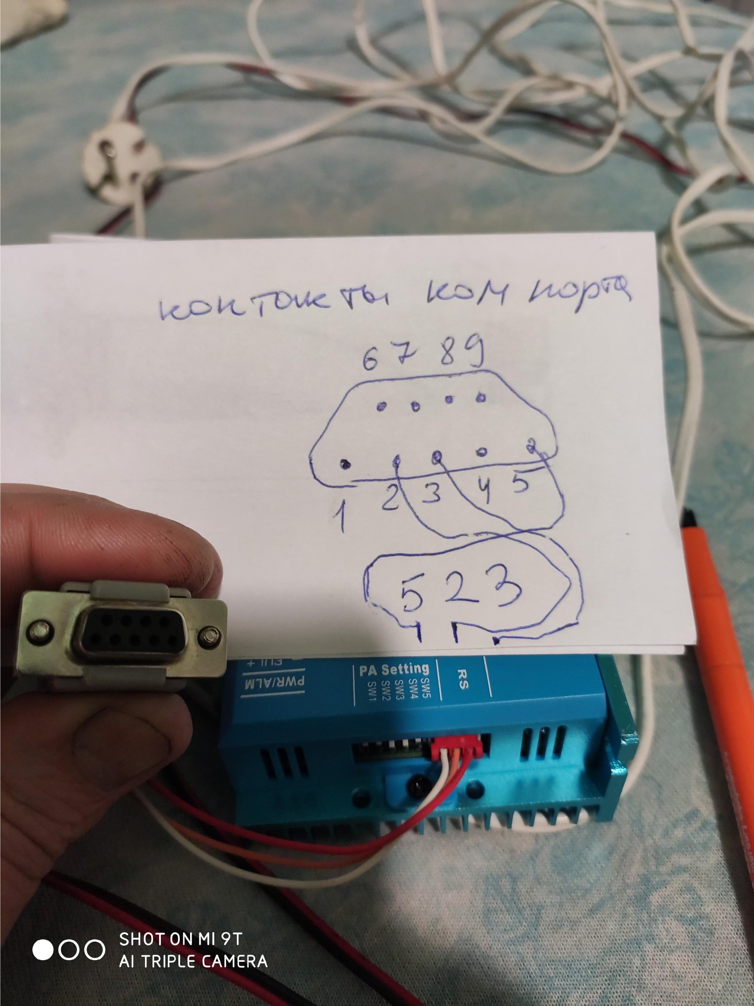

HBS57 -> COM PORT pinout of the driver for connection to the com port
was created by
piskora
see figure
Hi. Did you succesfully communicate with the driver?
If so; Which software did you use?
Kind regards
