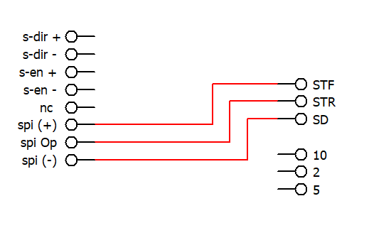

I tried to run the PncConf wizard. I don't know where to get the information out of the PncConf to switch the VFD. There is very little information on this card how to connect it. I have set the VFD up for anlogue input speed control.
"The 7i76 has a built-in digital potentiometer, so you would connect the 7i76 spindle control pins to pins 5, 2 and 5 on the VFD."
What pins are these on the Mesa card?
This is what I have so far:

28 Apr 2021 09:47 #207307
Plus you will need to program the VFD for ENA/DIR mode instead of FWD/REV mode
Replied by PCW on topic VFD TO 7I76ED
7I76E TB4 VFD
1 SPINDLE- 5
2 SPINOUT 2
3 SPINDLE+ 10
4 NC
5 SPINDLE ENA- SD
6 SPINDLE ENA+ STF
7 SPINDLE DIR- SD
8 SPINDLE DIR+ STRPlus you will need to program the VFD for ENA/DIR mode instead of FWD/REV mode
