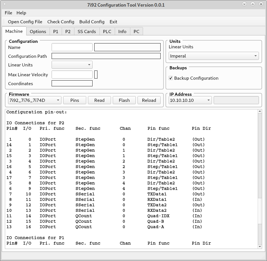

Due to the shutdown of travis-ci.org I no longer publish any documents on github.com. I've moved all the documents to my website.
gnipsel.com/mesa/index.html
I'm working on the 7i92, 7i95 using the knowledge I've gained over the last year programming the 7i96.
JT
JT

The 7i95 Configuration Tool is pretty much done.
The 7i76e Configuration Tool is mostly done.
When I finish the 7i76e I'll start on the 7i92.
JT
JT

Note: the 7i92 Configuration Tool will only read and flash firmware at this time. To create a configuration use the Pncconf tool.

I wonder is its practical to use Mesaflash's pin names in a configuration utility
The latest version of mesaflash allows replacing the pin names with daughter
board I/O names:
7I92 configuration pin-out: (for a G540)
IO Connections for P2
Pin# I/O Pri. func Sec. func Chan Pin func Pin Dir
Output-2 0 IOPort None
Spindle-PWM 1 IOPort PWM 0 PWM (Out)
X-Step 2 IOPort StepGen 0 Step/Table1 (Out)
Fault 3 IOPort None
X-Dir 4 IOPort StepGen 0 Dir/Table2 (Out)
Charge-Pump 5 IOPort StepGen 4 Step/Table1 (Out)
Y-Step 6 IOPort StepGen 1 Step/Table1 (Out)
Output-1 7 IOPort None
Y-Dir 8 IOPort StepGen 1 Dir/Table2 (Out)
Z-Step 9 IOPort StepGen 2 Step/Table1 (Out)
Z-Dir 10 IOPort StepGen 2 Dir/Table2 (Out)
A-Step 11 IOPort StepGen 3 Step/Table1 (Out)
A-Dir 12 IOPort StepGen 3 Dir/Table2 (Out)
Input-1 13 IOPort QCount 0 Quad-A (In)
Input-2 14 IOPort QCount 0 Quad-B (In)
Input-3 15 IOPort QCount 0 Quad-IDX (In)
Input-4 16 IOPort None
from mesaflash --device 7i92 --addr 10.10.10.10 --readhmid --dbname1 g540
( I wish the new forum editors code mode still worked)

Yes the Pin# column is the DB25 pin number on 25 pin FPGA cards
