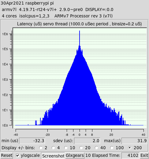

Here's a latency plot of the same RPI4:

Linux raspberrypi 4.19.71-rt24-v7l+ #1 SMP PREEMPT RT Thu Jan 23 16:59:28 PST 2020 armv7l GNU/LinuxHere's a latency plot of the same RPI4:
