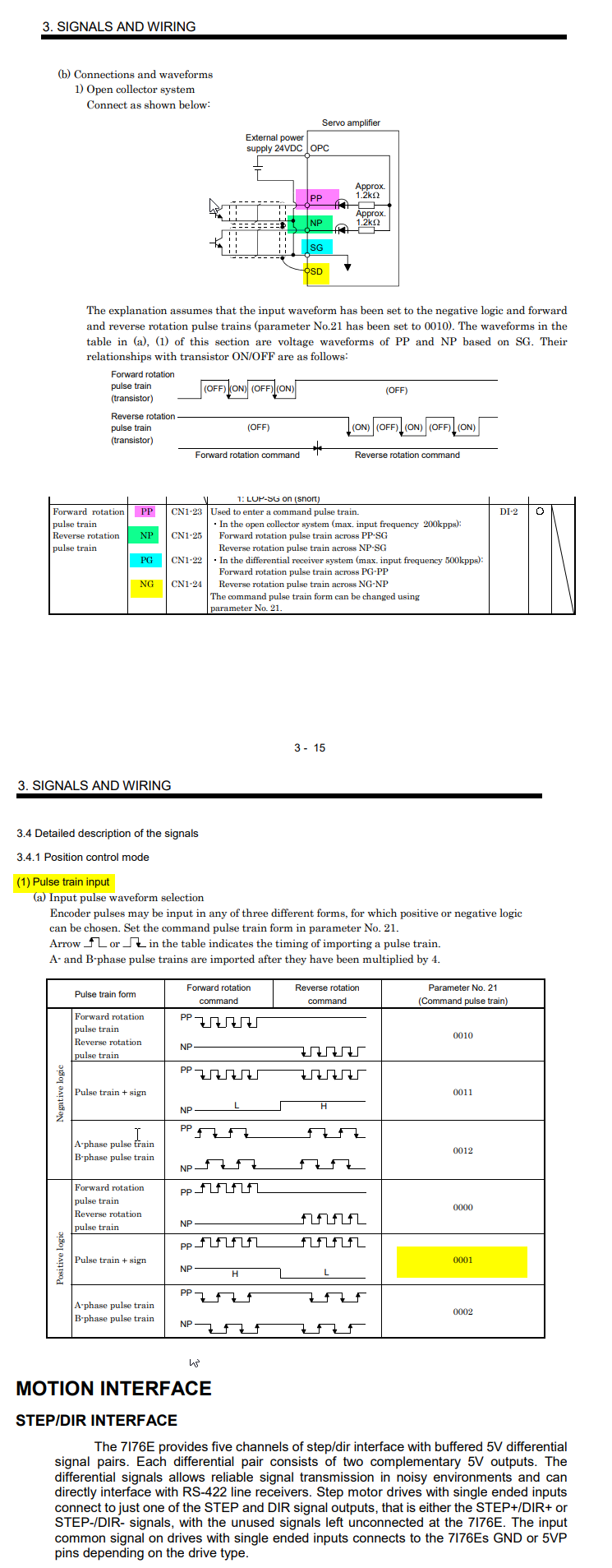

I'm replacing a WinCnc controller with a 7i76e. The WinCnc is setup to send STEP and DIR to the Mitsubishi MR-E-40 servo drives. The servo drives are setup for Positive Logic and Pulse train and sign (Parameter 21 = 0001).
There are only 4 wires broken out of the CN1 signal connector, 24V, Signal Common, PP, NP.
I can't get the drives to jog the motors with the 7i76E.
Digging through MR-E-40 manual, the connection details for using only STEP and DIR signals; show an Open Collector System (excerpt attached). I have STEP+ wired to PP and DIR+ wired to NP on the servo. The drive and the 7i76e have a common signal ground.
Should this work? Or do I need an NPN transistor between the servo drive inputs and STEP/DIR signals. If I need to do this, I will probably just redo the signal cable to provide the two additional signal wires so it can be driven in differential mode. Trying not to introduce to many variables before I make that change.

For the 7I76Es 5V signals you would need to run the drive in differential mode:
Step+ to PP Step- to PG
Dir+ to NP, Dir- to NG
OPC unconnected
OPC unconnected

Rewired the CN1 cable to have leads for PG and NG signals. Saw the machine take it's first steps under control on LinuxCNC
Very happy, thanks for the help
