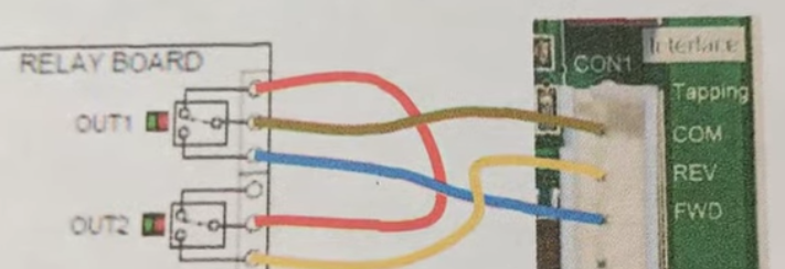

I am use a 7i96 as 4-axis + PWM/DIR to control the spindle of a CNC milling machine. The CNC milling machine has a FWD/REV manual switch which I want to be replaced by two relays as suggested in Franco's youtube channel. The connection scheme is shown in the attached the picture.
Is the following connection from 7i96 to relay module correct?
Dir4+ ---- input of relay 1
Dir4- ---- input of relay 2
GND ---- S/S of relay module
Sorry for the novice question.

I would just use two outputs to control the spindle. PWM is Pulse Width Modulation. Step and Direction pins are 5v, not sure what voltage 4 is when flashed with pwm firmware.

All step and direction outputs are buffered 5V signals that can drive 24 mA.

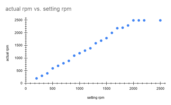

Thanks for the help from you and PCW. I got the logic correct. With a SPINX1 card, now 7i96 can control spindle actions of setup speed and directions.
The problem that I am facing is that there are about 25% difference on linuxcnc rpm and spindle rpm.
Is there any way to set scale using 7i96 configuration tool?

I dont know about the config tool but you can certainly change
the 7I96 PWM scale in the hal or ini file

I did a calibration of actual rpm vs setted rpm in linuxcnc. The result is shown in the attached picture: in the setted rpm range of 0-2000, the spindle rpm of spindle is close to linear. If we can map the PWM duty range 0-0.8 to the spindle rpm 0-2500, the spindle speed control accuracy will be improved largely.
How to do it in the linuxcnc?
