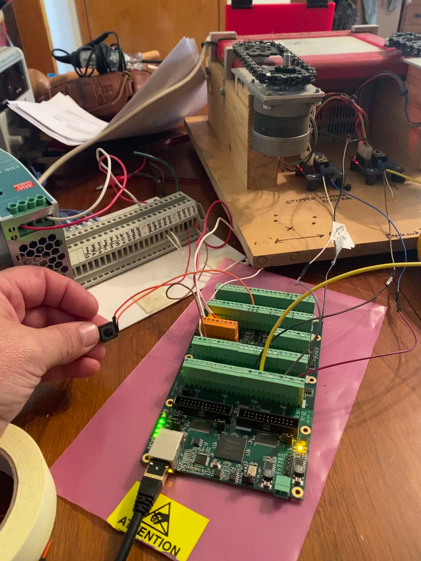

Hello,
I have a 7i76e with limit switches going from in25 thru in31
as stated in title 28 and 29 are not working(not responding to 24v applied)
27 and 30 work as expected
I have inverted them and no luck
Im in the testing stages with the board on my bench.
I've tried to change their function (switched to manual spindle cw and jog button inputs)
using Halshow i can see they dont respond no matter their function
I can easily work around this but Im hoping someone will shed some light on this
As soon as i get an email from Mesa that the 7i73s are done I can work around it
TC

Can you verify (with halshow) that
hm2_7i76e.0.7i76.0.0.input-28
hm2_7i76e.0.7i76.0.0.input-29
Reads 0 when you can read 24V on the 7I76E inputs
28 and 29 (at 7I76E TB5 pins 13,14) relative to field
power common?
power common?

- Posts: 18118
- Thank you received: 5336
09 May 2021 13:25 #208399
Replied by PCW on topic Inputs 28 and 29 not responding--7i76e
Yeah the terminal block screw is not necessarily connected to the
7I76E until its tightened.
The following user(s) said Thank You: tcninja

Nice "etch a sketch" !
- tcninja
- Posts: 23
09 May 2021 17:11 #208426
by tcninja
Replied by tcninja on topic Inputs 28 and 29 not responding--7i76e
Thanks! Thought an etch a sketch was a cooler way of testing than a piece of tape on a motor shaft.
