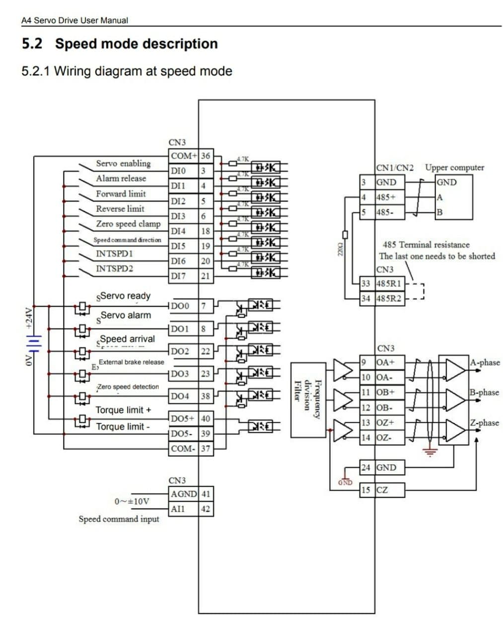

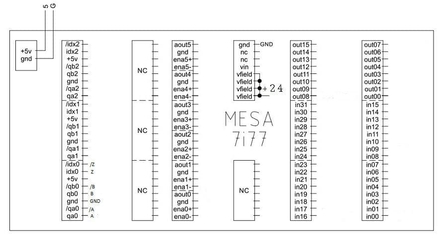

by MrSpeaky
7i77 Servo Enable was created by MrSpeaky
- chris@cnc
- Posts: 529
- Thank you received: 140
13 May 2021 15:52 - 13 May 2021 16:00 #208754
by chris@cnc
Replied by chris@cnc on topic 7i77 Servo Enable
I would try
aout => 42
gnd => 41
ena+ => 36
ena0- => 3
aout => 42
gnd => 41
ena+ => 36
ena0- => 3

- chris@cnc
- Posts: 529
13 May 2021 16:26 - 13 May 2021 16:27 #208759
by chris@cnc
If ena0 => 37 and ena+ => 3 will happend nothing. On Second side is no com+
Last edit: 13 May 2021 16:27 by chris@cnc.
The following user(s) said Thank You: MrSpeaky

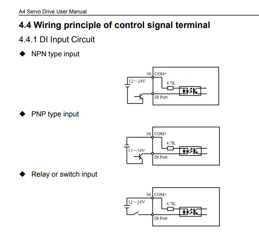

- Benb
- Posts: 184
- Thank you received: 61
13 May 2021 21:21 #208777
by Benb
Replied by Benb on topic 7i77 Servo Enable
The last suggestion by Chris@cnc is correct .
From the diagram, the inputs are sourcing type ie negative logic.
ENA0- => 37 (neg of PS)
ENA0+ => 3 (DI-0)
ENA0+ => 3 (DI-0)

- bevins
- Posts: 1947
- Thank you received: 338
14 May 2021 08:27 - 14 May 2021 08:28 #208801
by bevins
Replied by bevins on topic 7i77 Servo Enable
This is my suggestion. I always do it like this.
Put power on pins com on pin 37, + on pin 36,
Coneect a relay to ouput pin and run pin 37 to one side of N.O relay and other side to pin 3.
That should enable your drive. I always use mesa boards like this and never had an issue.
net Servo-enable machine-is-on output-pinConeect a relay to ouput pin and run pin 37 to one side of N.O relay and other side to pin 3.
