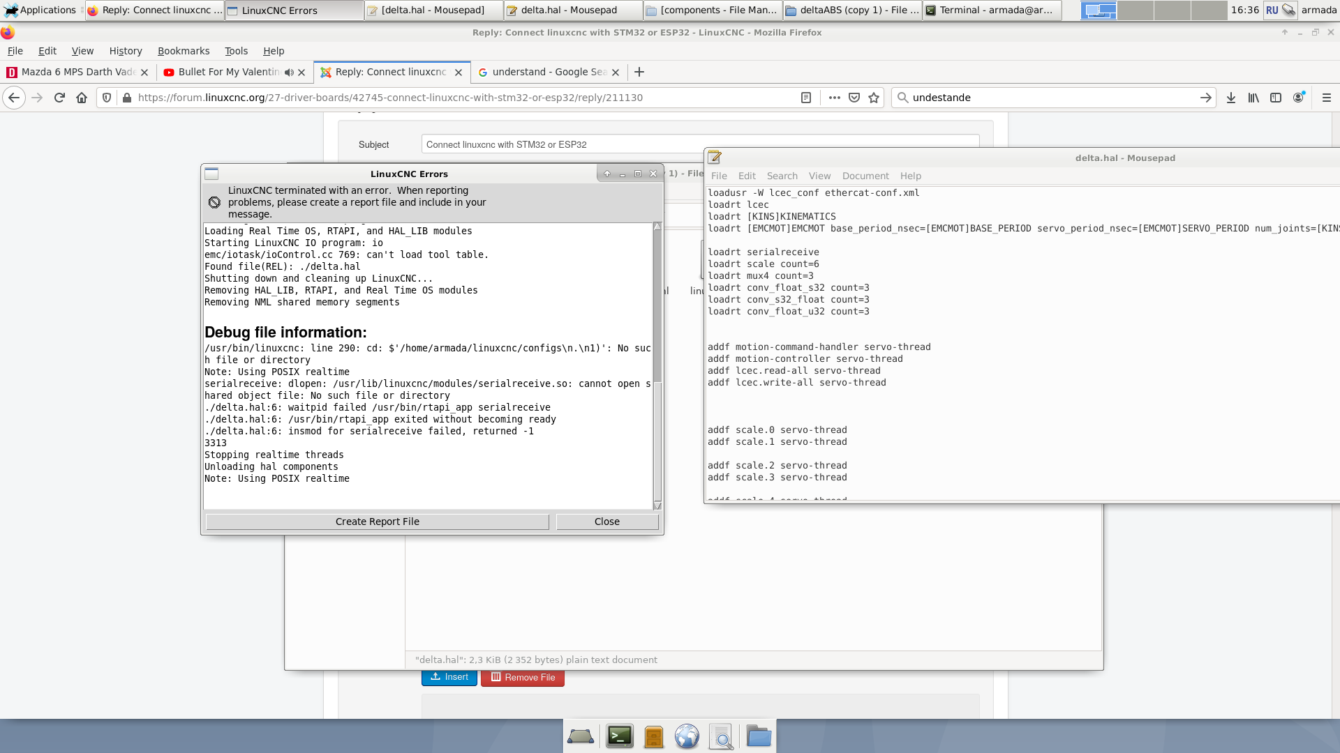

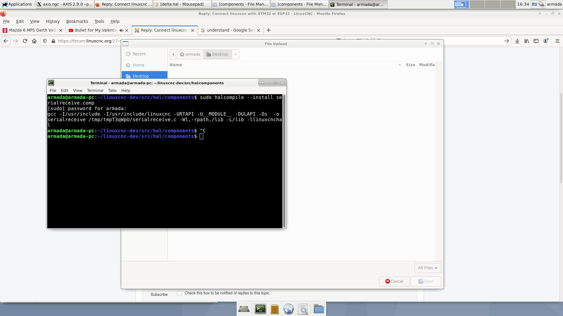

Ok Thank you so much.
I decided to go first way.
But I can't understand How to compile serialreceive.comp.
I try to compile this file and get this (pic1) -> then in *.hal I get (pic2)

Why did you stop the compilation process ?
I used the code from that thread and it went through halcompile ok.
As serialreceive is a userspace component you need to use loadusr not loadrt
rmurphy@thinkPad-t530:~/temp$ sudo halcompile --install serialreceive.comp
gcc -I/usr/include -I/usr/include/linuxcnc -URTAPI -U__MODULE__ -DULAPI -Os -o serialreceive /tmp/tmp5WG7oK/serialreceive.c -Wl,-rpath,/lib -L/lib -llinuxcnchal
serialreceive.comp: In function ‘user_mainloop’:
serialreceive.comp:49:17: warning: ignoring return value of ‘read’, declared with attribute warn_unused_result [-Wunused-result]As serialreceive is a userspace component you need to use loadusr not loadrt

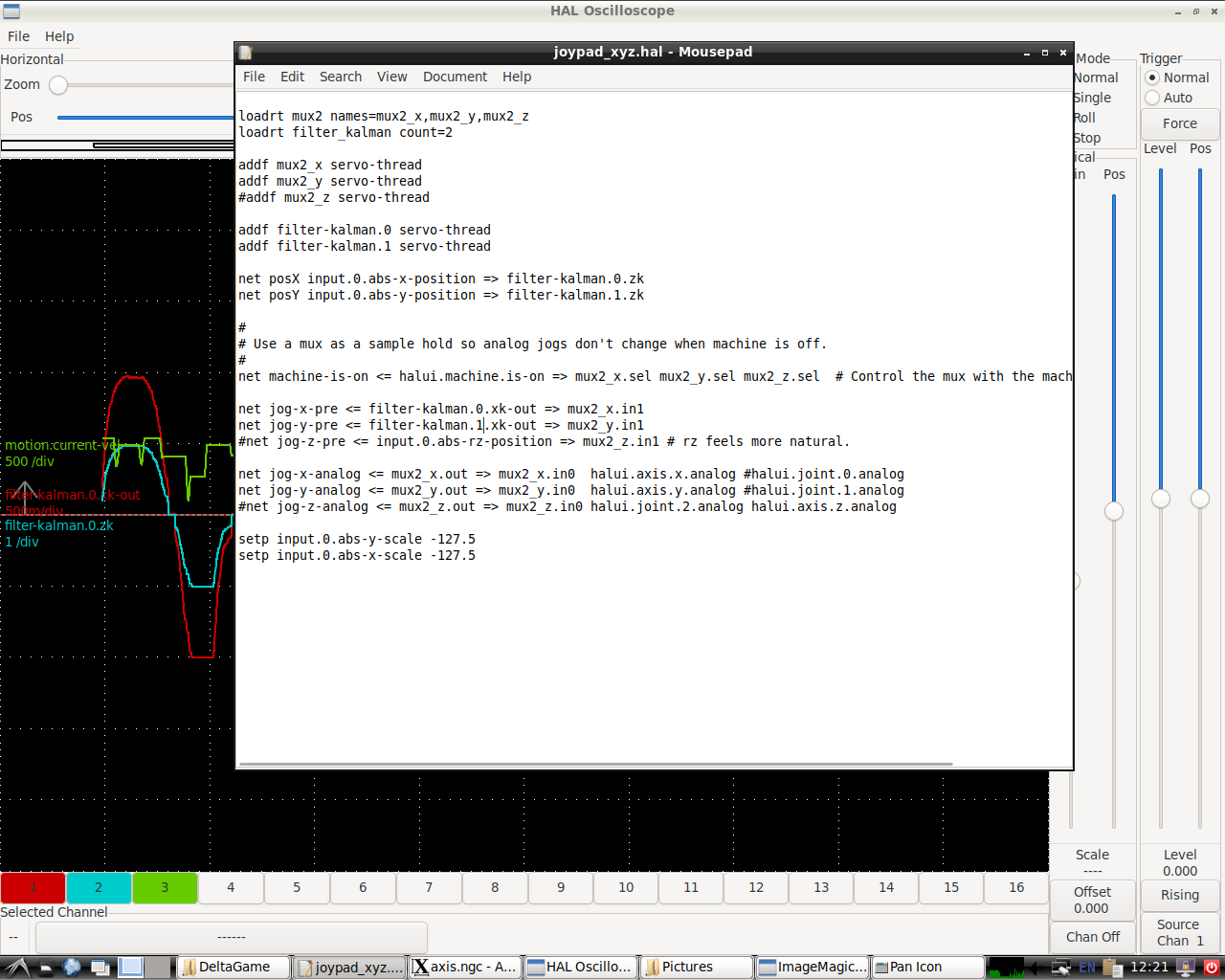

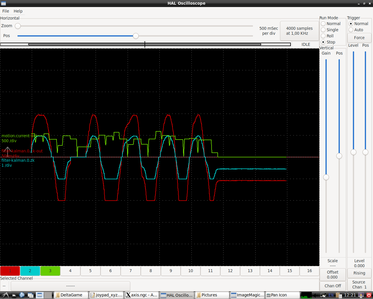

07 Jun 2021 09:31 #211410
by TheRoslyak
Replied by TheRoslyak on topic Connect linuxcnc with STM32 or ESP32
Thank you.
It was easy, I don't understand that others are tense.
The problem is the following:
"Tearing" speed - The robot jerks slightly at medium speed
I try to use filter kalman - It didn't help much.
If the way to smooth out the speed?

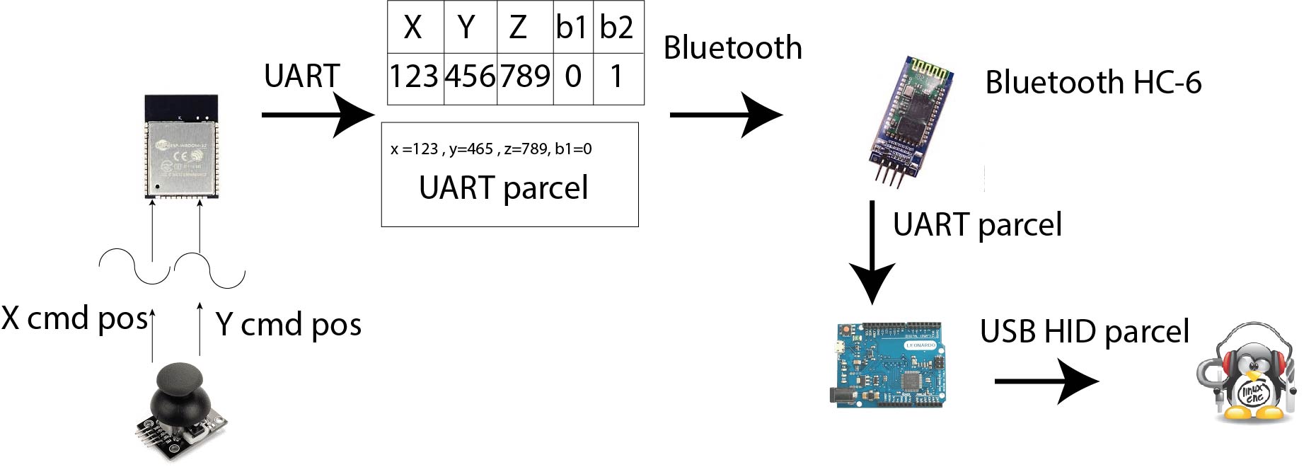

28 Jun 2021 14:56 #213147
by TheRoslyak
hi everyone.
In the continuation of the conversation.
The next question is only partially related to linuxcnc. But maybe there are tips on how to implement it.
In globaly I want to make "Data transmission device".
The alignment scheme is shown in pic.
Question number 1:
How reliable will the uart package be if I send simple text. or maybe there are other options
Question number 2:
If the made devices that perform "HC-6 + Arduino Leonardo".
I do not understand how in such a device. I can set a fixed value for joysticks and buttons and etc.
And returning to the first question, what does this get at the input? ("Data Transmit" I mean)
Question number 1:
Question number 2:
