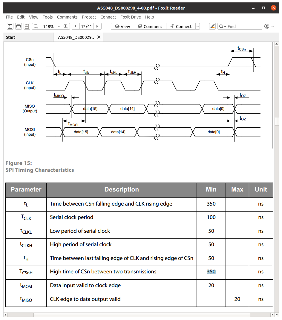

hello everyone, sorry in advance if I am not in the correct category, after doing some tests with rpi4 and mojo V3 running hostmot for 7i90, I thought that I could write a driver for some AS5048 encoders that I have at home, but I am somewhat lost , I have looked for information in:
- HAL basics
- The HAL Component Generator
- mesa_7i65.comp
and I have managed to understand some things but I have a sea of doubts.
To do some tests I first loaded from halcmd hostmot and hm2_rpspi and this is the output:

So far so good, so I have modified the mesa_7i65.comp controller a bit to only configure the 1 channel with two CS but it produces the following errors:
halcmd: loadrt threads name1 = servo-thread period1 = 1000000
halcmd: loadrt rtAS5048 bspi_chans = hm2_7i90.0.bspi.0
hm2 / hm2_7i90.0: The selected write channel (1) on bspi instance hm2_7i90.0.bspi.0.
Has not been configured.
There have been 2 errors during TRAM allocation setup, quitting
rtAS5048: rtapi_app_main: Invalid argument (-22)
<stdin>: 4: waitpid failed / usr / bin / rtapi_app rtAS5048
<stdin>: 4: / usr / bin / rtapi_app exited without becoming ready
<stdin>: 4: insmod for rtAS5048 failed, returned -1
Any help will be very welcome, regards

I also attach the time diagram for the spi interface of the IC, because I don't know if it fits the bspi module, something confused here, some way to debug this controller, the chip I have tested with an arduino and it works, it is all I hope anxious

In a previous photo of the timing-diagram of the AS5048 I have two times that I must consider [TL (350ns) and Th (50ns)] according to what I understand:
TL is time between CSn falling edge and clk rising edge
Th is time between last falling edge of CLK and rising edge of CSn
TL load it in the delay of the hm2_bspi_setup_chan function

Replied by PCW on topic Raspberry Pi 4 7i90 on Mojo V3 board BSPI
The DPLL has nothing to do with high speed SPI timing but rather timing of events in the servo thread. For example: SSI encoders need to clock in their data at a somewhat slow rate (400 KHz is standard) Rather that have the servo thread wait for the data, the DPLL can schedule the start of the data transfer before the nominal servo thread thread activation. This is academic however as the BSPI cannot be triggered by the DPLL currently.
I dont think the BSPI can do a 350 ns CS delay, 150 ns is max with a 7I90s 100 MHz clocklow
