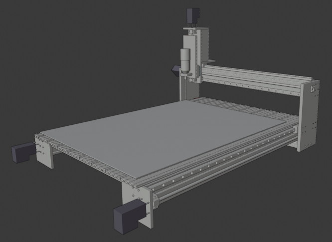

07 Jun 2021 16:48 #211450 by Twizzlermill
Replied by Twizzlermill on topic I need super basic Help with Hardware choices
Thank you for the answer, that looks very helpful.
I'll parse your suggestions when my brain is less preoccupied, so here's just a quick overview of what I'm doing:
It's a self-built CNC router with a working area of roughly 120 x 95 x 18 centimeters, mostly made out of aluminum profiles and plates. 16/5 mm spindles, the longest will be 140 cm. Rail guides. The plates are rectangles because my access to a router is limited, so, I'll build it like this for now and maybe use the machine to improve itself.
It will mostly cut MDF, acrylic and wood, but since I've got a grant to build it (and I can only use the money on this specific project), I decided to build it as beefy and upgradeable as possible. Also, having such a beefy machine, I'd like to play with working aluminum as well, but it won't be a focus.
The main choice of materials to work on suggests that I might be able to run the router relatively quickly, which I'd be interested in.
Apart from speed, I want to use closed loop steppers. Does that change anything regarding what I need to look for to use them?
Also, I totally forgot endstops, which I obviously also need.
For now, it'll move a 1.5kw Suhner router, which is mostly due to me not willing to introduce more complexity and that my working space's fuses won't allow running a too powerful router plus dust collection.
Here's a rough sketch of what I'm working on. the blank space is the working area.
07 Jun 2021 22:12 #211473 by Aaroncnc
Replied by Aaroncnc on topic I need super basic Help with Hardware choices
Is this for hobby or production?
Is this a tool for learning mostly?
Given the size you would want something capable of good rapid travel speeds to help speed up cycle times.
You could get by without but jogging around would be slow.
So I would look towards option 2 and 3
But if you want to hit the ground running fast to start learning while you make a long term option 1 and 4 and going to be a great start. I would go for number 4 as it's a safe and easy starting point.
End switches/ home can be any mechanical momentary switch. Even ones for 3d printers will work. Avoid optical as dust and cutting debris will cause problems. A relay for your spindle would be a good idea.
www.amazon.com/SSR-40DA-Solid-Output-24-...id=1623121809&sr=8-4
These are not actually 20a more like 10 to 15a
But I would get one for the spindle and one for your dust collection system.
These take a low voltage signal from one of the control boards or pc and allow it to turn on and off a mains powered device.
