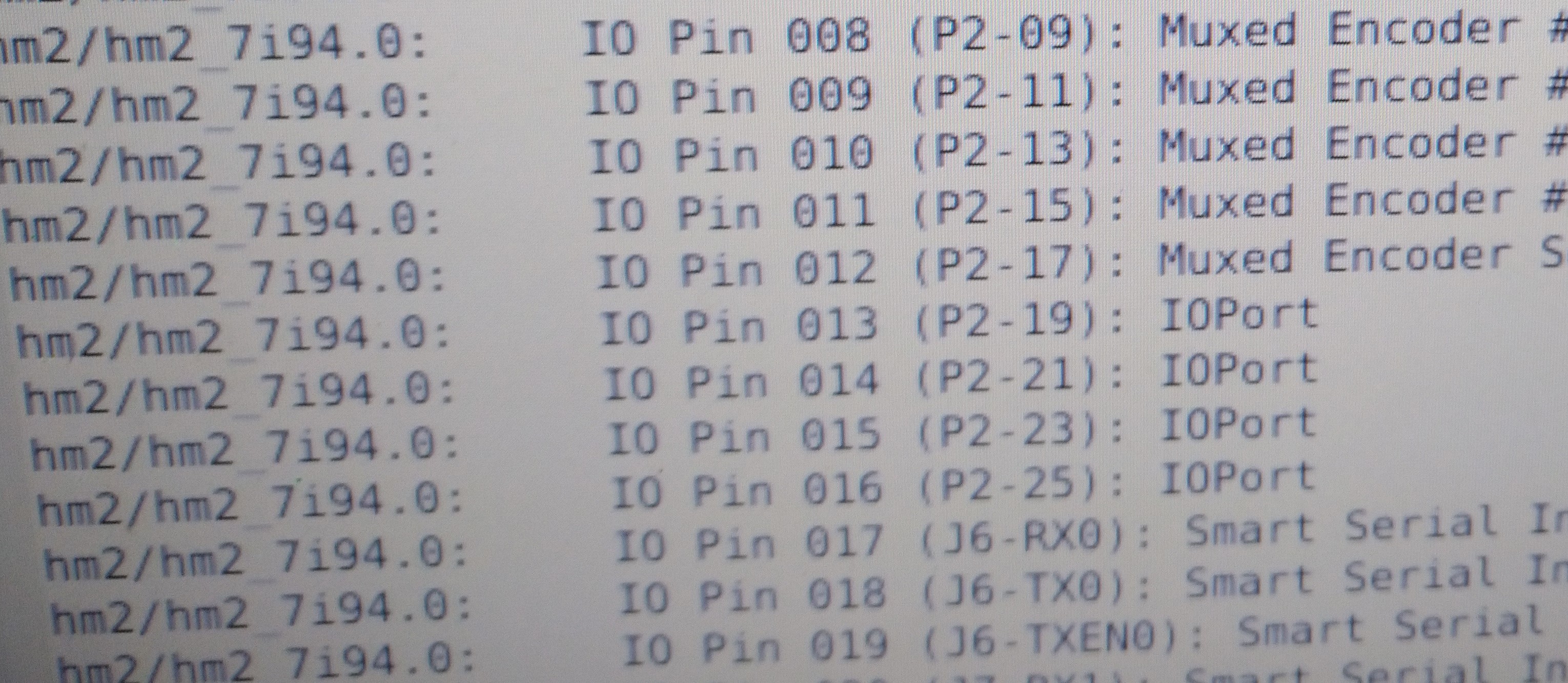

24 Jun 2021 23:25 - 25 Jun 2021 00:48 #212855
by MrMick
Replied by MrMick on topic Mesa 7I94+7I89
I have,
So IO PIN 13 (P2-19) would switch pwop right?
Whats the correct name in linuxcnc for this one?
As per pic of show pin description for Io line 13 pwop
Last edit: 25 Jun 2021 00:48 by MrMick.

25 Jun 2021 01:48 #212865
by MrMick
That is halrun show pin.
The pin name is shown with spaces. The picture is a photo of the screen of show pin

25 Jun 2021 02:44 - 25 Jun 2021 02:45 #212867
Replied by PCW on topic Mesa 7I94+7I89
Here is what I get for gpio pin names:
And if I:
setp hm2_7i94.0.gpio.041.is_output true
setp hm2_7i94.0.gpio.013.is_output true
setp hm2_7i94.0.gpio.041.out false
setp hm2_7i94.0.gpio.013.out false
On the 7I94ss_7i89 config, the switched power LED turns on and I can turn if off with:
setp hm2_7i94.0.gpio.013.out true
in addition, I can read all 8 encoder counters

25 Jun 2021 02:51 #212869
by MrMick
Ok so it's a gpio pin I did try that but it didn't switch the light on.
I thought it was the first pin 13 listed after the encoder lines. I'll recheck and maybe re install Linuxcnc incase I've made a mistake elsewhere.
Thanks for your patience
