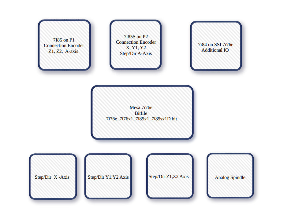

I would like to attach a laser module to my machine. Connect via PWM from the 7i85s. Unfortunately I am not able to write a bitfile. In addition, I am already far from the standard with my configuration. Does anyone have a bit file for the 7i76e with 7i85 7i85s and one PWM connection.If someone has a better idea let me know. At the moment I don't know how I can control the laser, but I think PWM is quite good.
Thanks in advance
Chris
Thanks in advance
Chris

7I76E with 7I85 on P1, 7I85S on P2, last step pin on 7I85S=PWM
Replied by PCW on topic PWM on 7i85s

Thank you for helping me.
