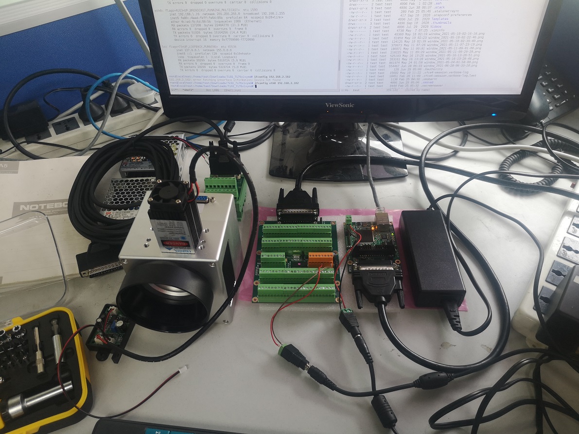

Dear PCW,
Just heard that 7i96 can drive digital galvo using custom firmware. I would love
to try. But I only got 7i92 + 7i76, could you please compile 7i92 custom firmware
for me, so that I could use halstreamer to stream the Openlase output to xy2mod. Thanks

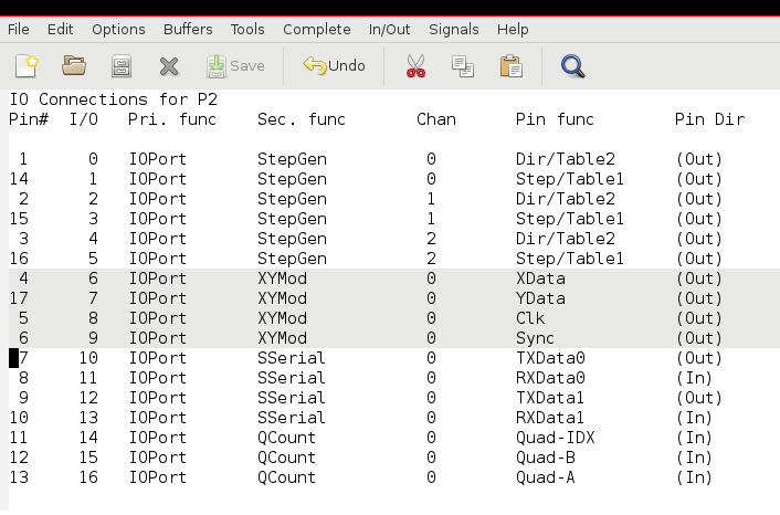

30 Jun 2021 16:14 - 30 Jun 2021 16:15 #213353 by PCW
File Attachment:
File Name: 7i92_7i76x1xymd.zip
File Size:114 KB
This puts the XY2-100 interface on the 7I76 stepgen 3,4 pins:
Configuration pin-out:
IO Connections for P2
Pin#                  I/O   Pri. func    Sec. func       Chan      Pin func        Pin Dir
TB2-4,5                 0   IOPort       StepGen          0        Dir/Table2      (Out)
TB2-2,3                 1   IOPort       StepGen          0        Step/Table1     (Out)
TB2-10,11               2   IOPort       StepGen          1        Dir/Table2      (Out)
TB2-8,9                 3   IOPort       StepGen          1        Step/Table1     (Out)
TB2-16,17               4   IOPort       StepGen          2        Dir/Table2      (Out)
TB2-14,15               5   IOPort       StepGen          2        Step/Table1     (Out)
TB2-22,23               6   IOPort       XYMod            0        XData           (Out)
TB2-20,21               7   IOPort       XYMod            0        YData           (Out)
TB3-4,5                 8   IOPort       XYMod            0        Clk             (Out)
TB3-2,3                 9   IOPort       XYMod            0        Sync            (Out)
Internal-Field-IO      10   IOPort       SSerial          0        TXData0         (Out)
Internal-Field-IO      11   IOPort       SSerial          0        RXData0         (In)
TB3-18,19              12   IOPort       SSerial          0        TXData1         (Out)
TB3-16,17              13   IOPort       SSerial          0        RXData1         (In)
TB3-13,14              14   IOPort       QCount           0        Quad-IDX        (In)
TB3-10,11              15   IOPort       QCount           0        Quad-B          (In)
TB3-7,8                16   IOPort       QCount           0        Quad-A          (In)

02 Jul 2021 03:53 #213477 by HotCat
Thanks for your quick reply, I just flash your firmware to 7i92 without issues. I could proceed to play with linuxcnc hal file and galvos. Your mesa card is great, it opens my career to robot and trash the mitsubishi plc
05 Jul 2021 03:03 #213737 by HotCat
I just use your 7i96 configuration file, only change the board name to 7i92 and ip address to 192.168.1.121. I use linuxcnc 2.9 master branch code. Linuxcnc reports error finishing read! iter=26, I also found the galvo's mirror flaps a bit

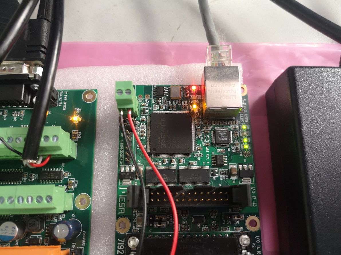

The 7i92's INT light asserts and linuxcnc shows packages error limits exceed

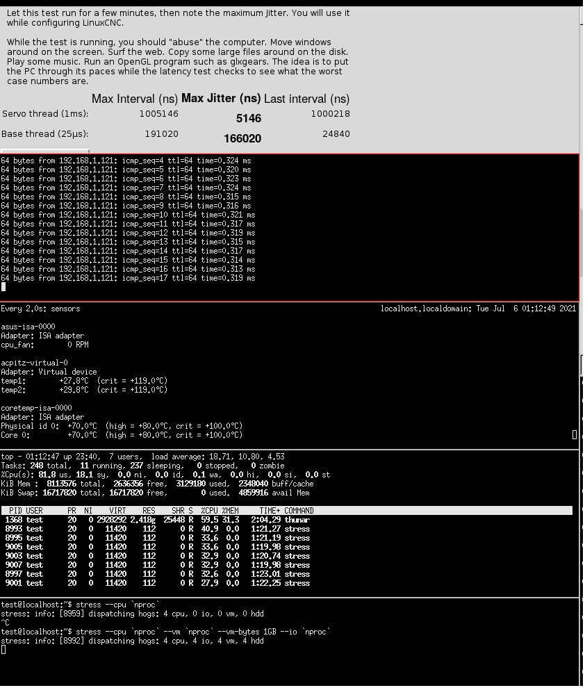

05 Jul 2021 03:17 #213738 by PCW
Sounds like a real time issue on the host
Have you run a latency test?
Also what are the ping times? (pinging the 7I92)
06 Jul 2021 01:23 - 06 Jul 2021 01:44 #213814 by HotCat
This is my latency test and 7i92 ping time. I use stress command to stress the CPU and IO。Intel i5-7500 CPU @ 3.40GHz,No Hyper Threading Technology. Intel I219-V ethernet card with hardware-irq-coalesce-rx-usecs = 0. This type of PC was used to control the delta robot using 7i92/7i76 comb, works great. But recently I add a nvidia GTX1080 card and install it's proprietary driver to accelerate the SIFT vision algorithm. I also got 6i25 as candidate if 7i92 is still not working
Last edit: 06 Jul 2021 01:44 by HotCat.
06 Jul 2021 02:32 #213819 by PCW
Those ping times are pretty bad, I would expect 80..120 usec
That will be a problem with a 1 KHz servo thread
Is there any power management on the Ethernet?
Is any Intel Ethernet snooping enabled like AMT mode?
06 Jul 2021 09:59 - 06 Jul 2021 10:38 #213837 by HotCat
Just check the ping time again without stress test, but the time is still not good, around 0.560ms. The ehternet card was integrated on motherboard and the BIOS doesn't provide any extra tweak options.
So I migrant to another old PC(Dell OPTIPLEX 3020) with Intel i3-4150 and RTL 8168 Gigabit Ethernet Controller. Got ping time 0.125ms, run linuxCNC and read error went away. Now I can jog the two galvo mirror respectively.

06 Jul 2021 21:27 #213897 by andypugh
Unrelated, but you should probably run the latency test without a base thread, as you won't be using one with a Mesa config.
