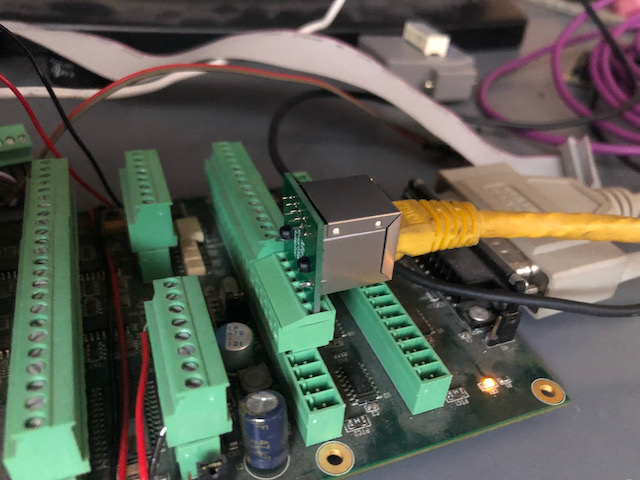

For no good reason I have never been totally happy cutting down a CAT5 cable and clamping the ends in a terminal block. So I came up with an alternative.
This is an 8P8C connector and a little PCB that I had made. Actually I had a lot pc PCBs made. 50.

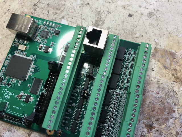

The PCB was made small enough to fit between the rows of the 7i69, as shown above. But for a 7i76 there is not room, However a different terminal block can be used:
And that actually works with the first design of PCB that I had made, before realising that I had made them too large for the gap.

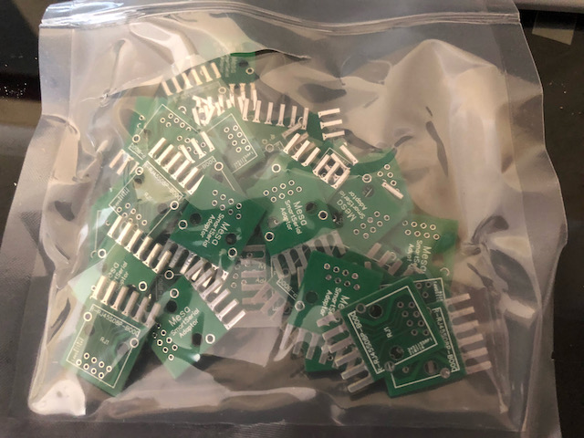

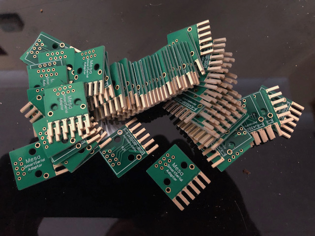

So, I now have something like 100 PCBs (and 20 sockets) of which I will only ever use a small fraction. Does anyone want one?

Those don't really solve the problem of going from Mesa-card Phoenix connectors to CAT5 cable.I've used stuff like these with great success.
