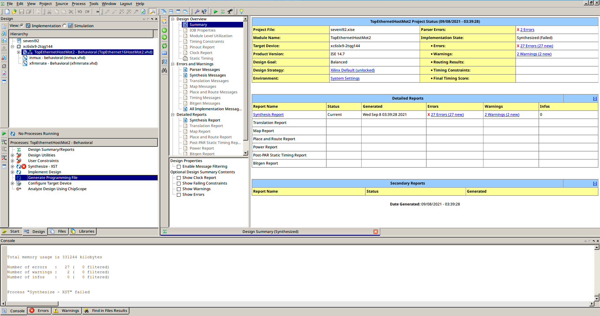

I'm trying to re-compile the firmware for 7i92/7i93, to be able to use non-standard interface boards.
The problem is that I cannot even re-compile original files from 7i92.zip. I get almost 30 errors.

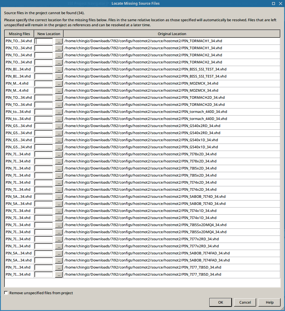

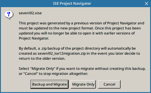

Need to mention, that when I try to load the project, I get a message, saying that project was made by older version and need to migrate. Then I get a message, asking to load some missing files. Have to mostly skip them, as they are not exist in folder.
Here are some of the error messages.
Parser messages:
ProjectMgmt:806 - "/home/username/Downloads/7i93/configs/hostmot2/source/hostmot2/TopEthernet16HostMot2.vhd" Line 79. Syntax error near "@".
ProjectMgmt:806 - "/home/username/Downloads/7i93/configs/hostmot2/source/hostmot2/TopEthernet16HostMot2.vhd" Line 98. Syntax error near "@".
Sythesis messages:
HDLCompiler:1206 - "/home/username/Downloads/7i93/configs/hostmot2/source/hostmot2/TopEthernet16HostMot2.vhd" Line 79: Syntax error near '@'
HDLCompiler:104 - "/home/username/Downloads/7i93/configs/hostmot2/source/hostmot2/TopEthernet16HostMot2.vhd" Line 90: Cannot find <i93_x9card> in library <work>. Please ensure that the library was compiled, and that a library and a use clause are present in the VHDL file.
HDLCompiler:69 - "/home/username/Downloads/7i93/configs/hostmot2/source/hostmot2/TopEthernet16HostMot2.vhd" Line 365: <pindesc> is not declared.
HDLCompiler:69 - "/home/username/Downloads/7i93/configs/hostmot2/source/hostmot2/TopEthernet16HostMot2.vhd" Line 366: <moduleid> is not declared.
HDLCompiler:374 - "/home/username/Downloads/7i93/configs/hostmot2/source/hostmot2/TopEthernet16HostMot2.vhd" Line 409: Entity <topethernethostmot2> is not yet compiled.
HDLCompiler:69 - "/home/username/Downloads/7i93/configs/hostmot2/source/hostmot2/TopEthernet16HostMot2.vhd" Line 415: <std_logic> is not declared.
I use version 14.7, installed on my Xubuntu 20.04.

These errors mean you need to edit the top level file and comment out the card and pinout placeholders ( @card@ and @pin@ ) and uncomment the desired card and pinout file

Thanks a lot!
It did work and I managed to load the new firmware to Mesa board successfully!
