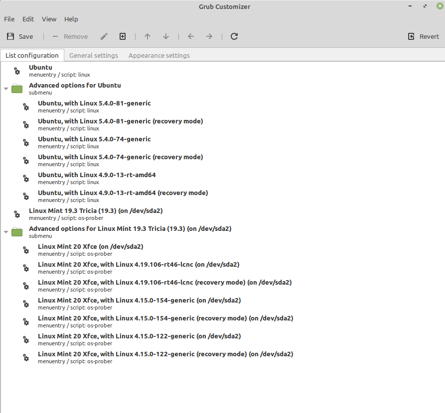

Yes, I'm pretty sure that's what happened, Rod. I'd come to the same conclusion last night. After installing Mint 20 and LinuxCNC 2.8.2, I used Grub Customiser to move "Ubuntu" from the bottom of the list to the top, as "Ubuntu" was the only boot menu item that seemed to work, after trying a few of them. Grub Customiser seems to be one of those programs that is documented by the author(s) - it makes sense to them and perhaps doesn't contain any factual errors but for a newcomer, it's really not clear what you are looking at.
Here's what I've got, with the "Ubuntu" line renamed back to its original name. I'm pretty sure it was originally the very bottom line by itself before I moved it to the very top.
I'm guessing that some of the indented lines need to be in the correct relative position. I can't see a "Debian/GNU/Linux with Linux 5.10.0-8-rt-amd64", although there is a 4.9.0-13-rt-amd64.
Do I need to try to put it back to how it was or is there a line(s) missing, do you think? I feel some coverage of this in the Grub Customiser documentation might have been helpful, although it's quite possible I simply missed it of course.

In the attached image of Grub Customizer, click on the "ubuntu with linux 4.9.0-13-rt-amd" to select it, then above click on the UP arrow until the selection is the first one on the list, click on save, reboot.

I did that exactly as you said and it seems to have started the RT process. However, it's not happy trying to call hm2_pci
