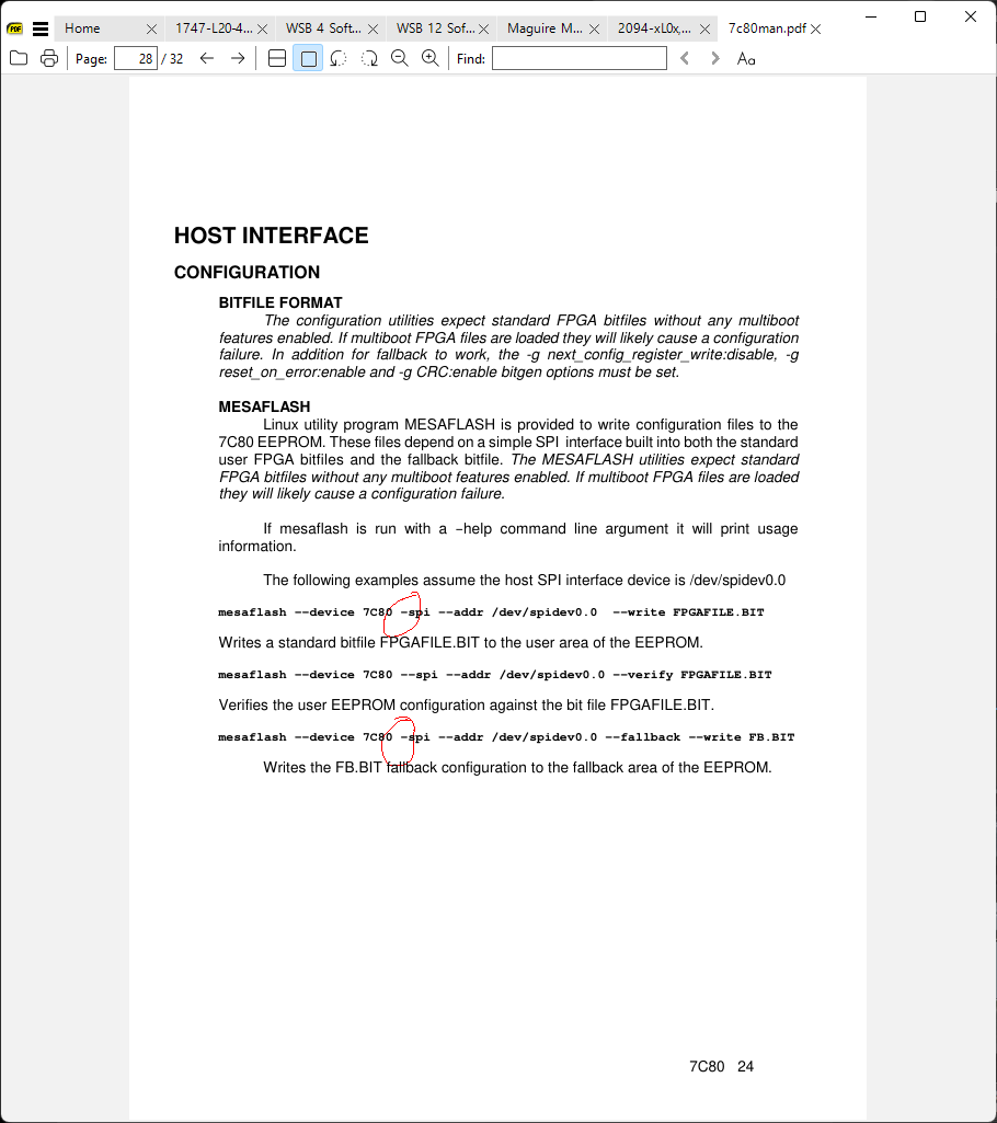

Replied by tommylight on topic Help connecting to mesa 7c80 card
For future reference, the first line did not work, but the second line did work, so just replacing "readhmid" with "write" plus filename should also work.-sudo mesaflash --device 7C80 –spi --addr /dev/spidev0.0 --write 7c80_7i89d.bit
-mesaflash --device 7c80 --addr /dev/spidev0.0 --spi --readhmid

19 Apr 2024 18:14 #298645
by rdtsc
Replied by rdtsc on topic Help connecting to mesa 7c80 card
I think I see where the issue with "-spi" is coming from. Spotted this in an old version of the 7C80 manual floating around the 'net. Just checked the current manual, and it's still there. Oops.
- Posts: 18093
- Thank you received: 5325
19 Apr 2024 18:20 #298647
Replied by PCW on topic Help connecting to mesa 7c80 card
I'll fix that, but also
mesaflash --help
Is a better source of current command line syntax
mesaflash --help
